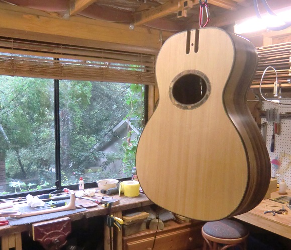

My latest project is not currently on the bench, but is hanging above it waiting for the finish to firm up. My first attempt at a falcate braced nylon - I guess a type of "neo-classical" if we are to adopt the Gore/Gilet nomenclature.

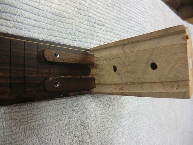

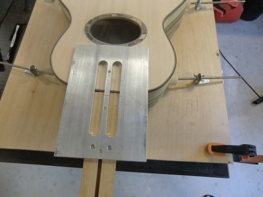

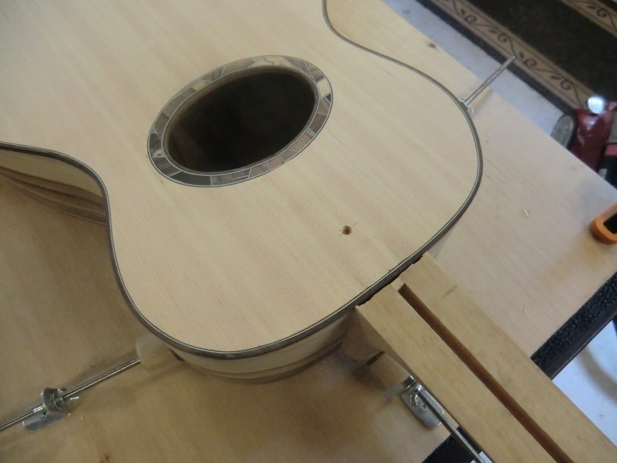

I tried a new method for the bolt-on, bolt-down neck joint. It uses a kit that I bought online from Luthiers Cool tools http://www.luthierscooltools.com/Tools.htm#Bolt-on. I think it might be a good system, but the proof will be in the completed guitar I guess. Here is how it works:
The neck-to body is a simple butt joint - no mortice. I drilled two bolt holes through the neck block during the building stage. The neck block also has an extension that runs under the fingerboard, as per the G&G method. Once you have the neck aligned and the joint fairly flush you drill two corresponding bolt holes into the heel and install your preferred form of threaded nut. The kit comes with threaded inserts, but I don't like using those things in the end grain of the heel, so I drilled it out for some barrel bolts (one day I will get kitted up for the square bar that Trevor and Gerard recommend). Then you bolt on the neck and set it up to rout out channels for the second part of the joint - the bolt-down part.
There is a routing template, which allows you to cut two channels that span the neck-body joint. There are some lugs on the bottom that register off the truss rod slot and keep the jig square, and you screw it down onto the neck so that nothing moves around.

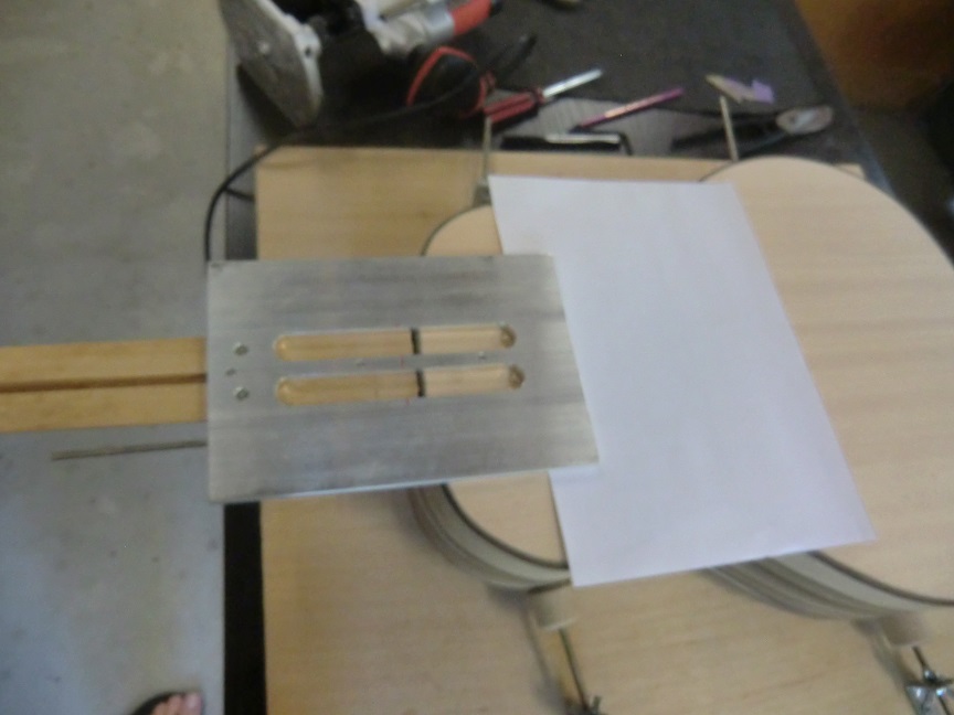

Then you want to cover the sound hole because you are about to make some mess

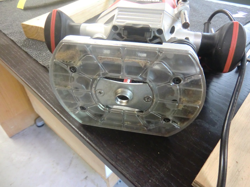

I used a plunge router with a quarter inch straight bit. You need a guide bushel to read off the template, and it is a fairly easy cutting job.
The kit provides two hardwood inserts (looks like walnut) with threaded inserts that will accept the bolts to hold down the fingerboard extension. These are nicely made to be an exact fit for the channels that you just routed. You then glue them in - ONLY ON THE NECK SIDE OF THE JOINT.
After it dries you can dis-assemble the joint, insert the truss rod, and glue on the fingerboard. You end up with an arrangement that looks like this.

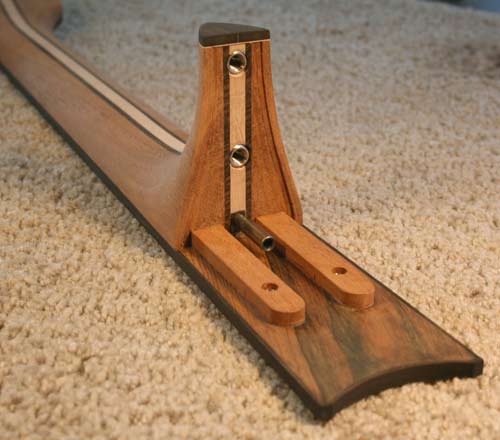

This is a photo from the Cool Luthier Tools website, not my neck. It shows it more clearly than my own photos.
neck bolt website.jpg (28.92 KiB) Viewed 27514 times
And here is mine. It needs a bit of sanding to clean it up, but you get the idea. I have the truss rod adjusting from the other end, so you don't see it continuing into the body. Now, you may be wondering why there are fret slots cut in the bottom of the fretboard? Well - I decided to change the scale length on this board at some stage and I just turned it over and started again on the other side. Because it has bindings, nobody will ever know - except you folks. But anyone who unbolts this neck in the future may be puzzled.
neck rout 8.jpg (129.31 KiB) Viewed 27514 times

I will post some pictures of the finished guitar when I get it completed. But don't hold your breath. I work slow.

Could you possibly show more pics of the butt joint neck join? Especially the headblock. I like the idea of a simple neck joint, and a neck joint that doesn't use glue (I expect that would make for easier neck resets down the track).
Thanks,
GregL.
Re: What's on your bench?
Post by Mark McLean » Mon Feb 29, 2016 8:35 pm
Greg
I always kick myself for not taking more photographs as I go along through a build. I can't find any of the inside of this guitar. But if you have a look at this old thread our genial host, Bob Connor, shows his butt, which I found to be inspirational. I seem to remember that I basically copied what I did from this post by Bob.
viewtopic.php?f=1&t=2983&p=36298&hilit= ... int#p36298
If you want to bolt-down the fingerboard the main thing internally is the L-shaped neck block with a solid piece that extends under the soundboard where the fingerboard extension will run. It goes as far as the upper transverse brace. You don't need to cut this as a single block - you can glue together two rectangular blocks to make the L. In my build I have departed from these pictures a bit with the parallel bars, instead of Bob's square pocket.
The gist of it is that the heel to body joint is a simple butt joint, with no mortice & tenon needed. The original Taylor neck was like this also. Mario Proulx in Canada is another well known luthier who uses a bolted butt joint. But the Taylor and Proulx designs still glued the fingerboard down to the top of the guitar, so not a truly "removable neck". It is interesting to chart the development of the bolt on neck to a true bolt-on & bolt-down design. The Gore & Gilet books give a very elegant version of this also.
That ANZLF thread was a follow-up from this other one you might also want to check out, which kicks around a number of ideas for bolt-on designs.
viewtopic.php?f=1&t=2604&hilit=neck+bolt
BTW, I also found that I could adapt that routing template to do the slots in the headstock too - which was quite handy, and gives good value for money from one jig.

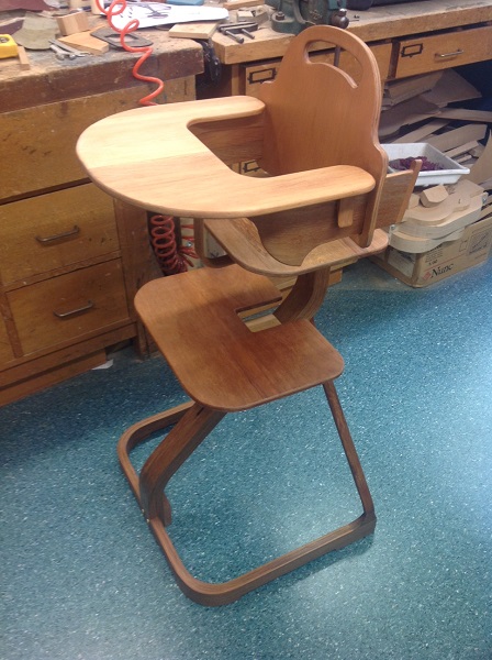

Here was the last thing I had "on the bench", made from rescued old Rimu bookcases our department were going to throw in a waste taker. Made it for my new-ish (4 months old now) first grandson it's a copy of a commercially available model but I made a few 'enhancements'.
Joe's chair.jpg (113.01 KiB) Viewed 27429 times
The bent bits were all laminated and depending on the radius, some were bent dry and others (the tighter radius's) I soaked in hot water.

Nick wrote: Here was the last thing I had "on the bench", made from rescued old Rimu bookcases our department were going to throw in a waste taker. Made it for my new-ish (4 months old now) first grandson it's a copy of a commercially available model but I made a few 'enhancements'.
So, presumably the strings are under the tray? The discrete piezo discs have clearly been invisibly inlayed, while the wiring runs through hidden internal channels to the EQ/Amp on the back of the seat, then down to the speaker/sub under the footrest so he "feels" the music. Clever, but I''ve got your measure. :mrgreen: :wink: Still, sets a new benchmark for player comfort and ergonomics.
Seriously Nick, you just don't do things by halves 8) Much like that vibraphone I drooled over a while back, only, while I appreciate this, I won't drool over it - I'll leave that to the four month old! :lol:

The gidgee bent beautiful Jeremy, had no trouble with it ( did the fabric softener thing and with African b/wood bindings also ), it'll look great when it's done it's beautiful timber, I just hope my finish will do it the justice it deserves.

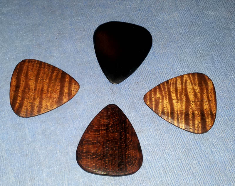

Just fooling with some scrap on the cnc Black-wood ,Snake wood and Ebony no logo's yet,at the local shop the other day and some one said have you seen Timber Tone picks and my reply was I have seen many novelties over the years wish them luck... :D
Post by simso » Wed Mar 02, 2016 5:47 pm
Have you bellied them, or are they just a flat picked with radiused edges
routout
Posts: 289
Post by routout » Wed Mar 02, 2016 7:32 pm
Yep bellied after I made a sanding jig I was just fooling around they work kind of ok feel better with just one side scalloped out may be just me need to incorporate that into the code for next time .cheers John 35c here today yikes.

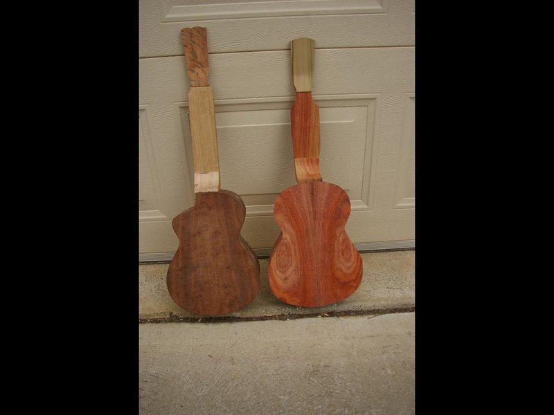

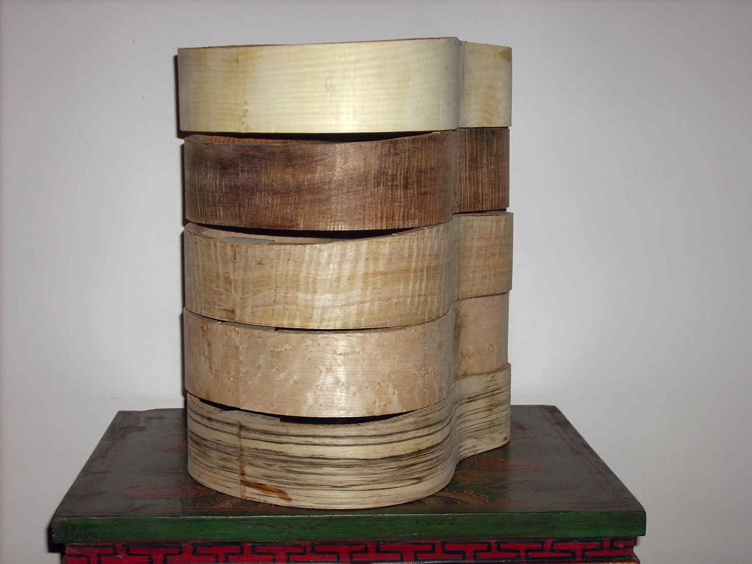

The ukuleles (all baritone) are:
1/. Satin Box with Blackwood top;
2/. Blackwood with Satin Box top;
3/. Mountain Ash with unknown top (from a tree cut down in a suburban street);
4/. Bird's-eye Maple with Sitka Spruce top;
5/. Black-heart Sassafras with Adirondack Spruce top.
Necks will be Honduran Mahogany, Queensland Rosewood and Blackwood. (see "Stak-o'-ukes")
Stak-o'-ukes

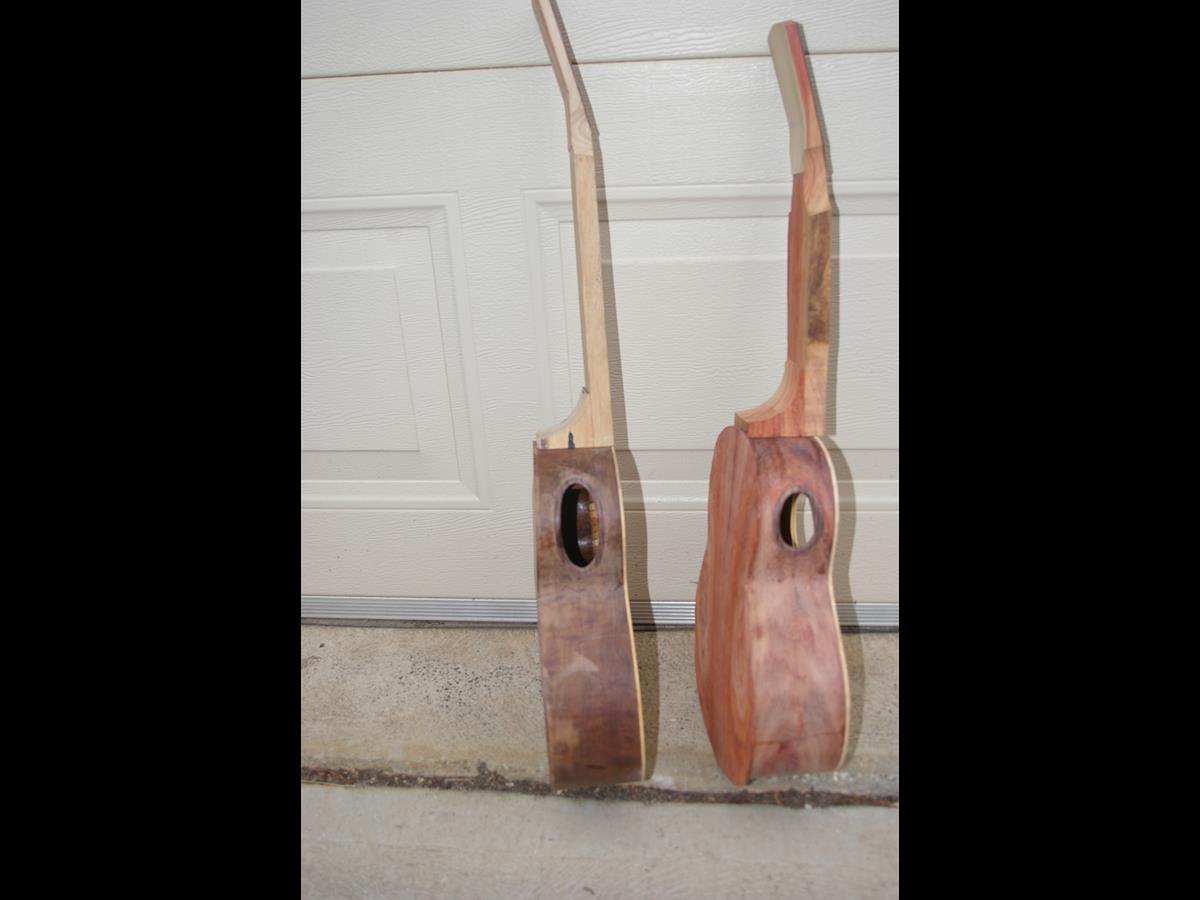

The guitars are:
1/. Dreadnought - Highly figured Blackwood and figured Monterey Cypress top;
2/. Classical (with active back) - Cocobolo and Engelmann Spruce.
3/. Parlor - Plain Padouk and Dunno Yet top;
4/. Flamenco (with passive back) - Plain Satin Box and Sitka Spruce top;
5/. Jumbo 12-string - Highly figured Blackwood and Sitka Spruce;
6/. Flamenco (with passive back) - Plain Monterey Cypress and Adirondack Spruce top;
Necks will be Honduran Mahogany and Monterey Cypress. (See "Pile-o'-geets")
Pile-o'-geets
