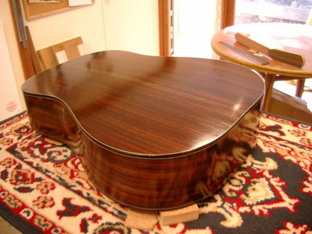

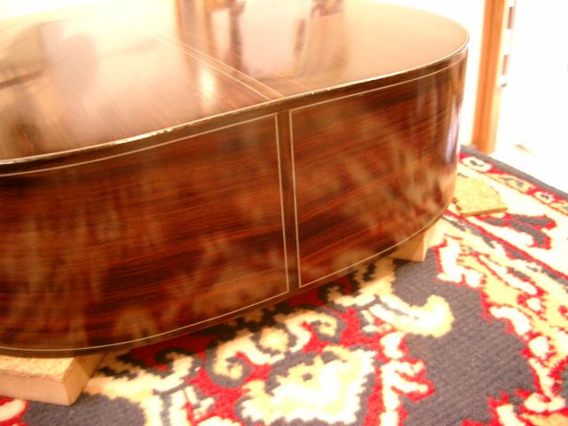

Started French Polishing the body today...two body coats on so far. Pore filling was done using z-poxy finishing resin. Two neat coats of same followed by final coat thinned down 50% with alcohol and then lightly sanded back with 600 grit W and D paper. In the background of first pic can be seen the offending neck...now a special "short scale" neck.

Oh man is that pretty!!!!! FP is still the prettiest and warmest looking finish IMHO.
Very nicely done M8! :cl :cl :cl :cl

The IRW is from a shipment of opp grade wood I got from Allied a couploe of years back.
Post by Allen » Thu May 15, 2008 5:45 am
I really like the binding / purfling treatment that you gave this one Martin. How long has this one been in the works?
Post by kiwigeo » Thu May 15, 2008 9:34 am
Too long.....there are actually two other instruments that have been under construction for alot longer
