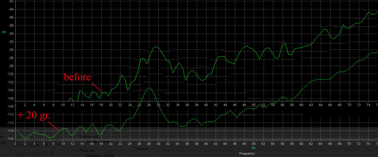

To be honest, I didn't bother at all measuring or tracking down the resonance frequency that was responsible for the buzzing of the four lowest not fretted strings. I just thought "great, problem solved". :D
However, I have the spectrogram of the finished guitar before I even discovered that plucking those strings very hard was a problem, and I can of course now record another spectrogram of the fixed guitar. Like you I also believe that the "headstock and/or neck resonance" must be found somewhere amongst those peaks below the main air resonance frequency. I'll have a look.

Post by charangohabsburg » Sun Aug 09, 2015 9:24 pm
charangohabsburg wrote:However, I have the spectrogram of the finished guitar before I even discovered that plucking those strings very hard was a problem, and I can of course now record another spectrogram of the fixed guitar. Like you I also believe that the "headstock and/or neck resonance" must be found somewhere amongst those peaks below the main air resonance frequency. I'll have a look.
Here:
