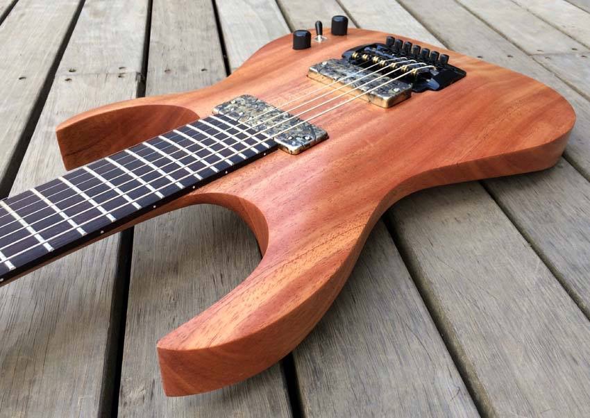

First of all, I wouldn't say building electrics is the easiest way to start. Neither electrics or a acoustics are easier, they're just different from each other, so start with whichever you'd prefer to build.
As far as chisels to carve the tops... I would much rather use an angle grinder and a flap disc. Much easier and WAY faster. When you have a pile of tops to carve in a day, I don't look at my chisel collection, I look at what is the easiest and fastest way.
Also, I've got about four or so spoke shaves. All are in retirement as the flap disc puts them out of commission too.
The rasp on the other hand is where your money should be directed. A good rasp is essential. My main rasp I use both the flat and curved surfaces and I like them to have a taper down to a point at the end (think strewmac dragon rasp) so I have a variety of widths along the one rasp.
Chisels do get used, I just don't use them for carving. I probably only ever use a 1/4" marples paring for the odd job. Usually cleaning a nut ledge or something after paint or just scraping an edge or something, the rest of my chisel sets don't really get used for guitar making, other wood work yes, but don't really touch the guitars. The same chisel is what I'd use to cut in kerf for joining top/back to sides etc.
Not one chisel was used carving this top:
