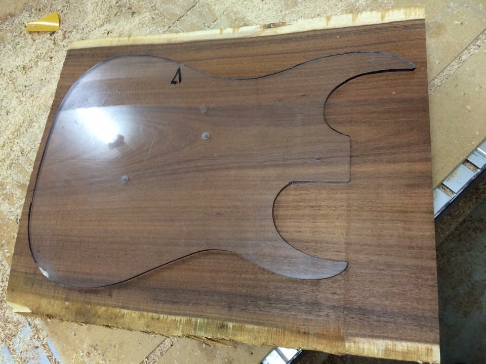

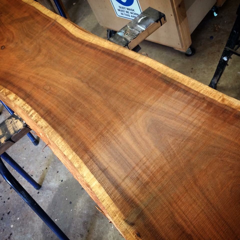

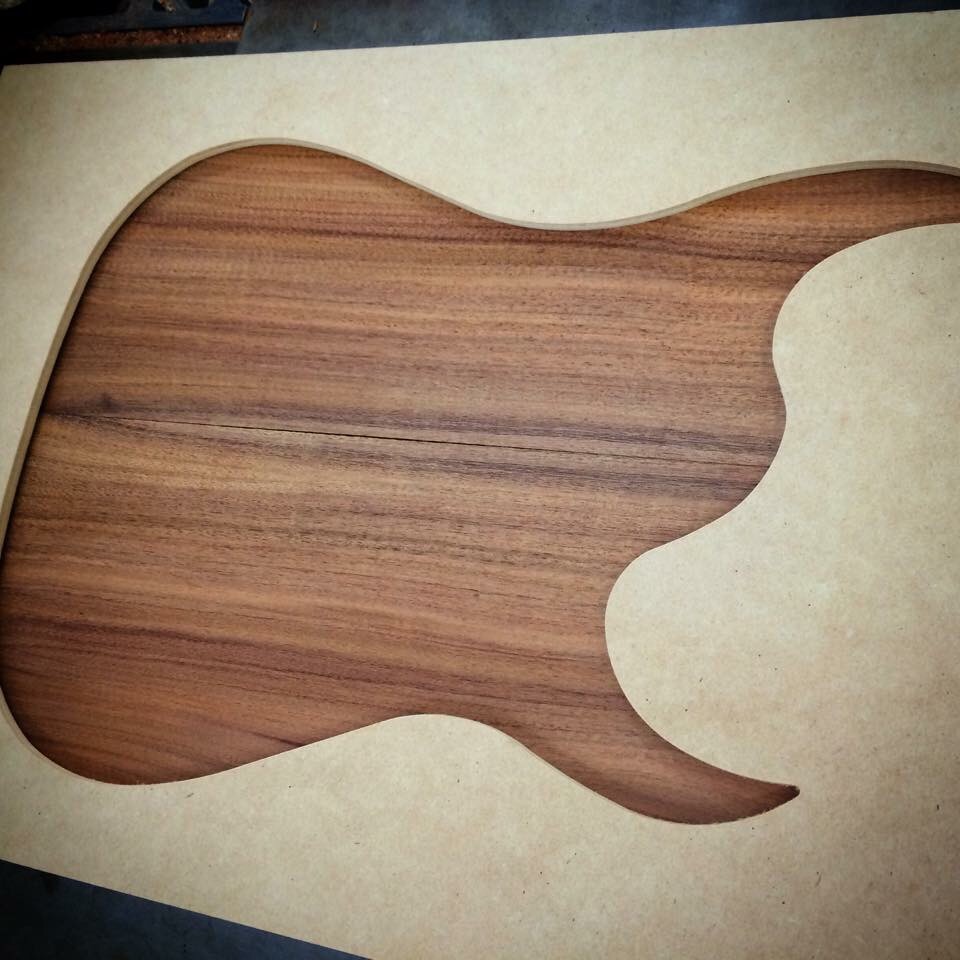

How to tell between Gidgee and Myall?
Post by demonx » Tue Jun 09, 2015 7:53 am
I was sold this slab as Gidgee, but I wonder if it might be Myall?
It's hard, it's very heavy, but I really don't know the differences to look for

Hi Allan,
I have used both Gidgee and Myall (Western Myall) and they are similar, but I found the Myall to be just a little bit more "brittle" - maybe less "tough", a bit more "crumbley" - not that it's crumbley or brittle when compared to most other woods! Also the Myall I have used was a bit darker coloured, a bit more "dark-chocolatey" in colour than Gidgee. (Of course, that could have just been the pieces of timber I had!).
If it's for a drop-top or a cap on an electric, I really don't think it's going to matter which species it is - they look almost identical and they're both mighty hard and heavy!

I have some of both and my guess would be Gidgee, although that is a guess.

G'day Alan ,
Gidgee is consistently heavier than Myall so cubing it out and weighing is an option . Gidg (A.cambagei) averages 1250 kg/cu often more , Myall (A. pendula ) averages 1100 though I've handled stuff under a ton .
Both have a sort of sweet nutty aroma , myall is a bit more violet smelling , myall keeps it's aroma on old surfaces more .
Gidgee is really mean to work , Myall is just mean ! Surfaces fresh off the belt or drum sander in Gidg will often develop a weird yellow blush of extractives , I've not seen it in Myall .
Visually they can completely blur into each other though perhaps Myall is a little coarser in texture .
Just to add confusion there's easy 50 more arid zone Acacias with really similar appearance and properties . Nelia , Lancewood , Bowgada , Bowyakka , doolalia ..........
All the best .
Pete

So... From the pics that's a "shrugs shoulders"...!
Guess I'll just go with Gidgee. That's what it was sold to me as but I seem to be buying things lately and then finding out its something else!

Post by driver2xx » Wed Jun 17, 2015 9:38 pm
looks like myall.
gidgee doesnt grow that big or that wide

Ahh, but it does I'm afraid Ken.
Just not very often! To say the least... :wink:

Also, this does have what Pete described as yellowish (I'd say more mustard coloured ?) powdery type residue when run through the drum sander.
If I remember I'll run some through and snap a pic.

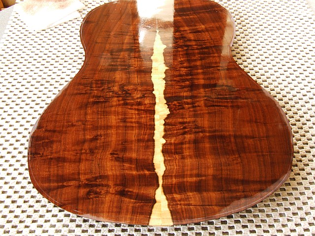

Post by Trevor Gore » Sat Jun 20, 2015 9:45 am
kiwigeo wrote:.....we want pics....
A gidgee back. Seriously dense wood.
This guitar is now ready for lacquer. I'll put some more pics up when it's finished.

Post by simso » Sat Jun 20, 2015 12:47 pm
Beautiful
Re: How to tell between Gidgee and Myall?
Post by Nick » Sat Jun 20, 2015 6:32 pm
Trevor Gore wrote: A gidgee back. Seriously dense wood.
Woah mamma! Seriously beautiful wood too Trevor, it's damn close to knocking my favourite Blackwood off it's no1 pedestal!
