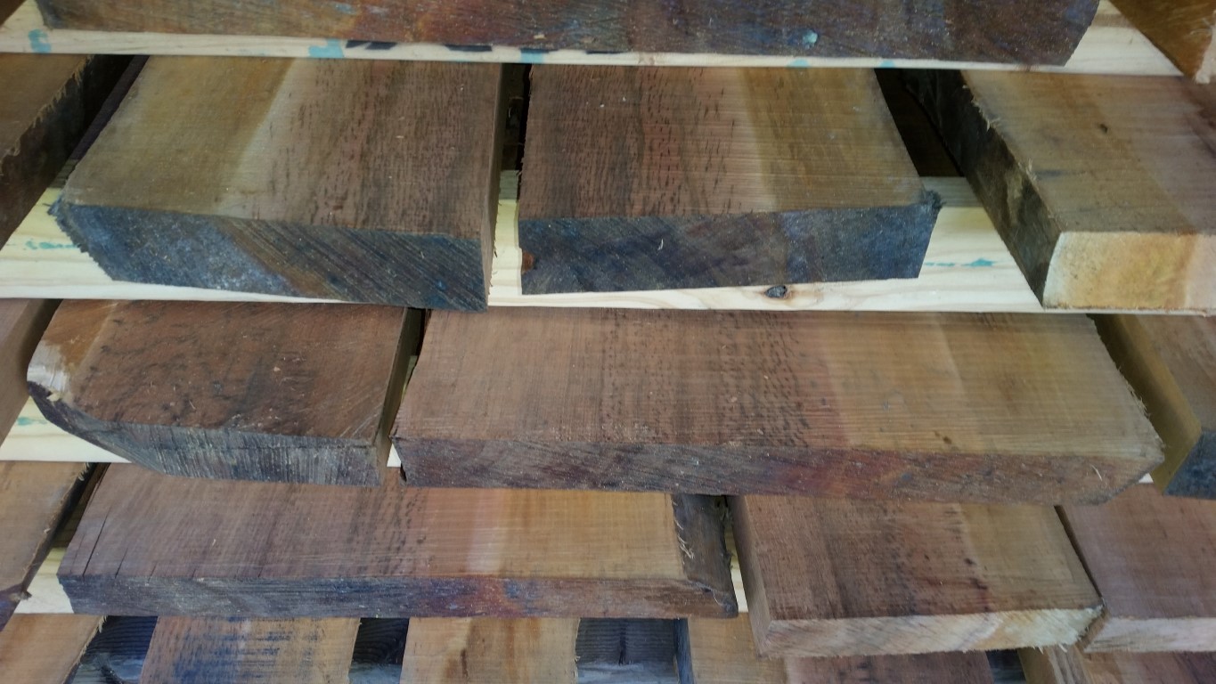

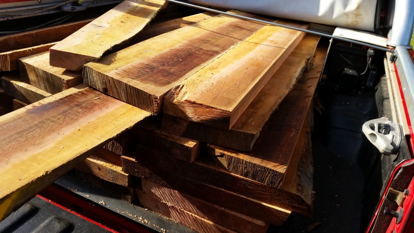

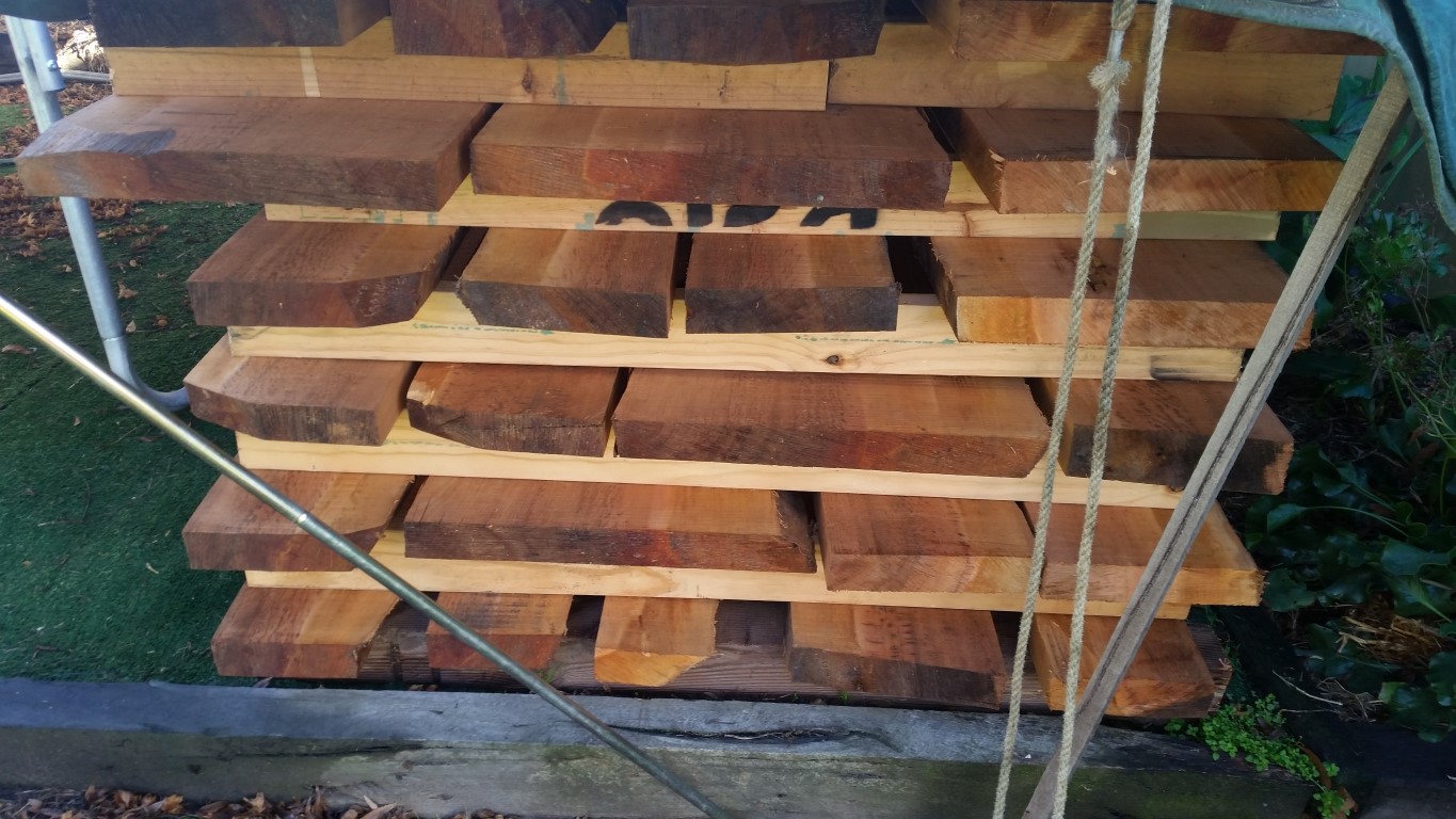

Bought meself a log of very green Tiger Myrtle a few weeks back.
Looks like it'll yield a few sets.
This will take about 2 years to dry before I can re-saw, rack and store for a further 6-12 months.
At present it's sitting outside with a tarp over it. It'll get moved inside before the end of the winter.

What are you going to paint the ends with ?

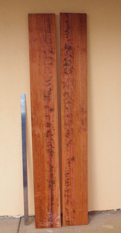

Must be Tiger Myrtle week this week. This arrived on the truck from Tassie today. 200mm wide and 25mm thick, and dry. Should keep me busy for a while. I'm a lucky boy too.
Tiger Myrtle.jpg (179.35 KiB) Viewed 13094 times

Titebond thinned 50%

Myrtle doesn't give up it's moisture too quickly so I agree slow air drying is definitely the way to go.
If that lot were Blackwood I'd be re-sawing tomorrow.
curly
Re: Put a Tiger in yer tank.
Post by curly » Tue Jun 09, 2015 7:33 pm
Sounds like you've got it well covered there Bob . I agree with not resawing from green in Myrtle , it's fairly volatile in drying . Other thing I'd add is don't retard the drying too far though . Tiger is fungal and whilst the timber is wet the mushrooms alive .
