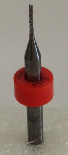

I gave up on Stewmacs bits years ago. Way too expensive for what they are. Can bring a tear to your eye when you break a few of the fine ones in one job.
I get mine from the drill man as Jeremy posted, or out of China from various eBay sellers. The last 1.0mm solid carbide ones were just $1.25 each postage included. So I bought 10 of them. :roll:

It has to do with feeds and speeds to a great extent. You want to get the heat out of the material in chips. Not holding in in the work and the cutter. A huge study in machining that will make your head hurt.
But also in the fine bits there is more meat to the core of the bit if it has more flutes. It might help with flex and breakage issues.
For what it's worth, I use a lot of the 4 flute cutters in the very small sizes.
