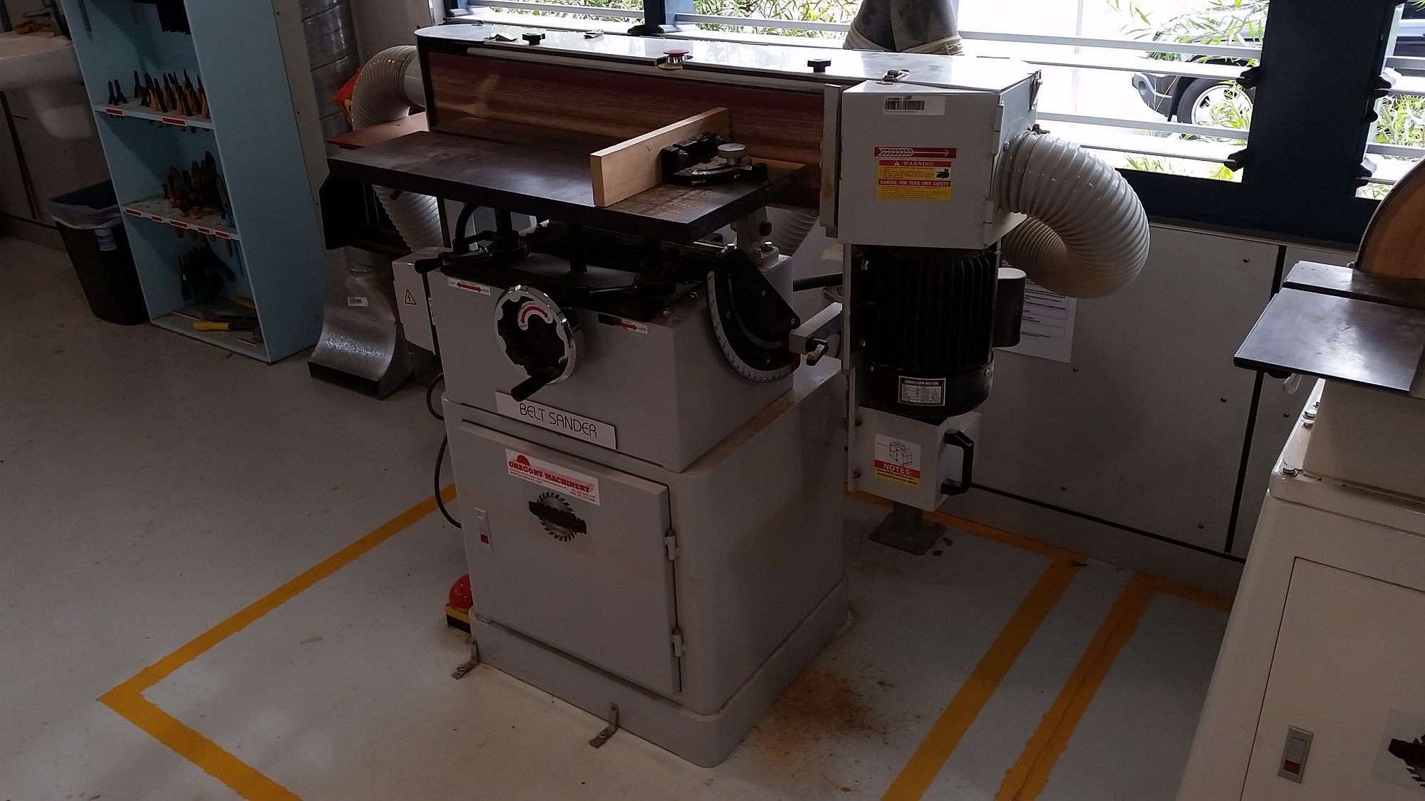

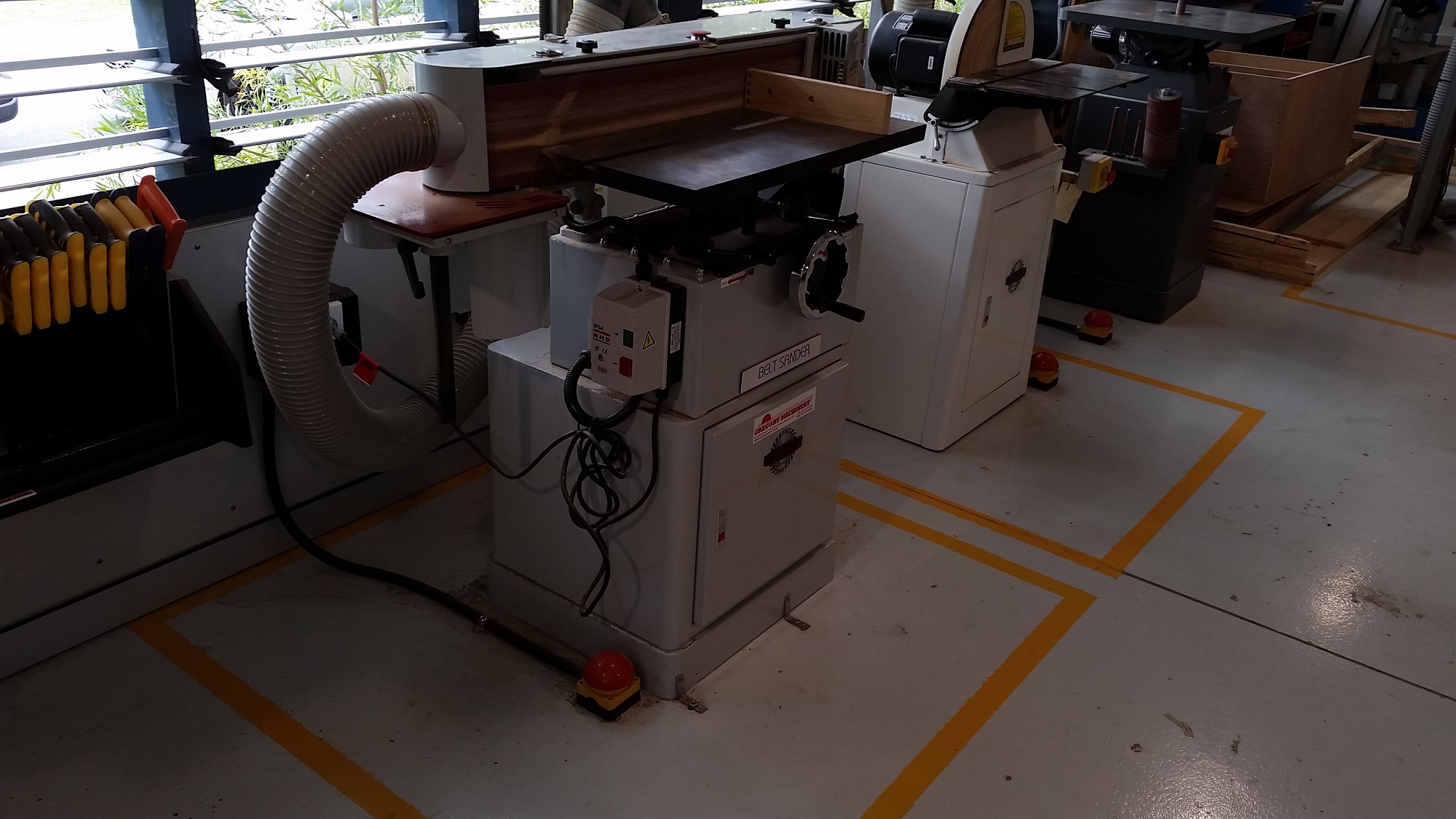

We have this one at school from Gregories. Does everything you need. Motor and belt assembly tilt if you need an angle. The left hand end has an adjustable height table. You can swing the guard out of the way and use it like a bobbin sander. The dial wheel on the front is for adjusting table up and down.
Have fun shopping.
