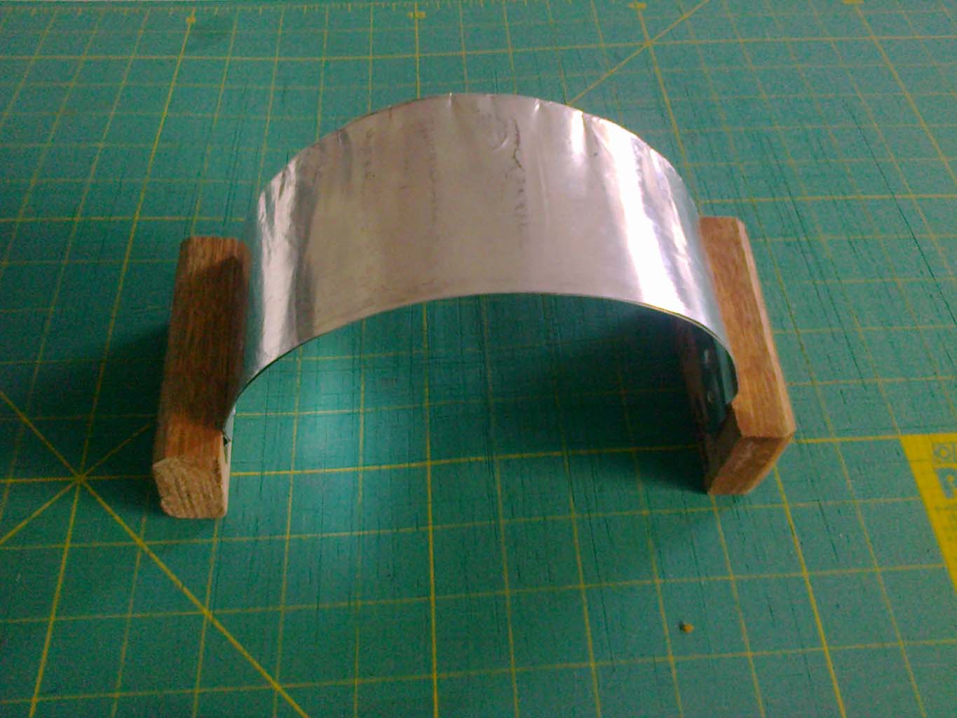

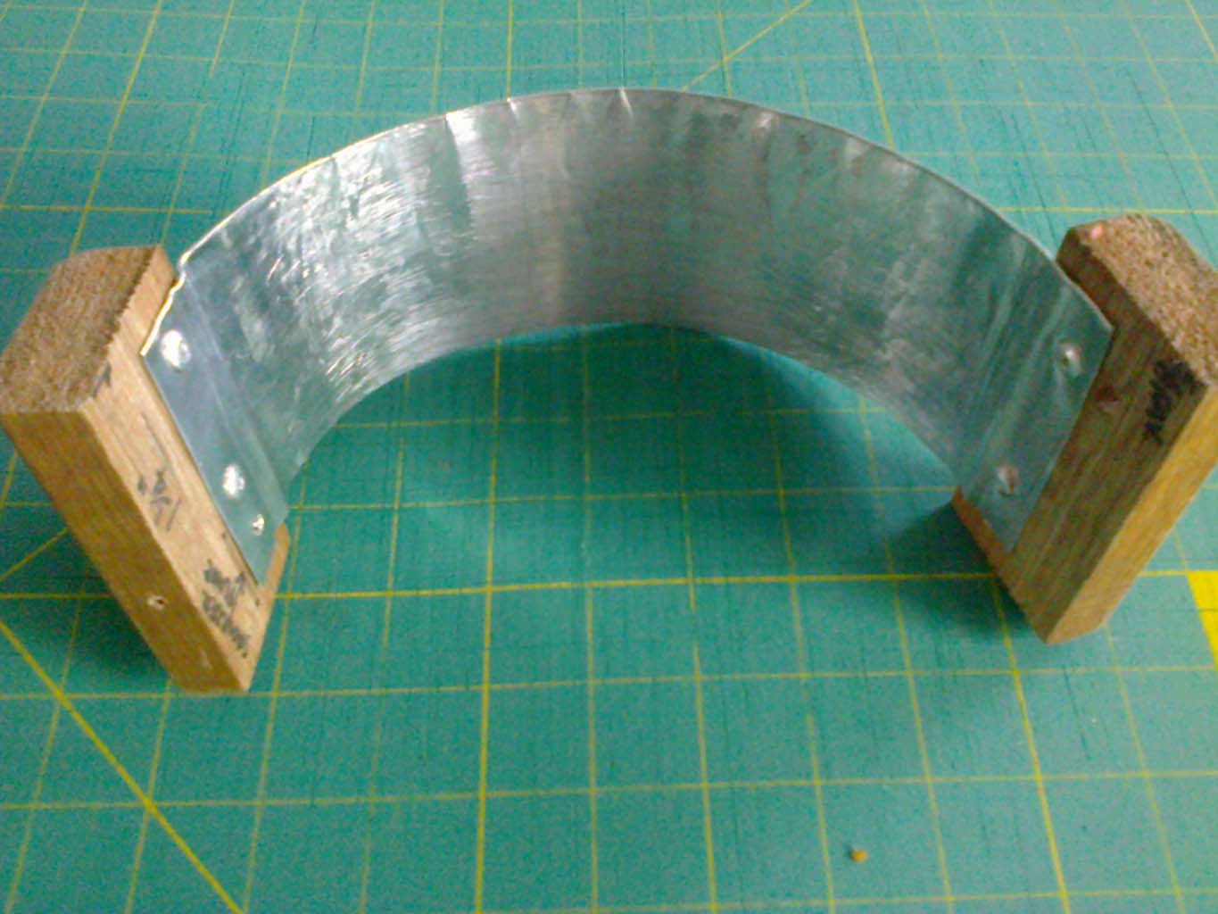

For what it is worth I made a bending strap using aluminium flashing. Bought the flashing from Bunnings, found it in the building materials section.
Not very expensive, it comes in rolls 150 mm wide by 5 or so metres long which is more than you'll need. My strap is approx 300 mm long
and I folded the flashing in half to stiffen it up a bit. Pop riveted a couple of blocks of scrap timber (quarter sawn of course) to each end for handles
and used it for bending sides for a uke.

@ Bruce McC :
Thats a nice jig!
Thanks for sharing.
I´ll make one for the next bending.
Thanks!
