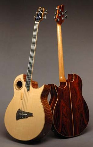

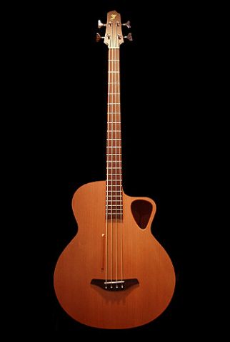

A lot of ABGs have the soundhole in the upper bout.
There's the Taylor:
The Furch
