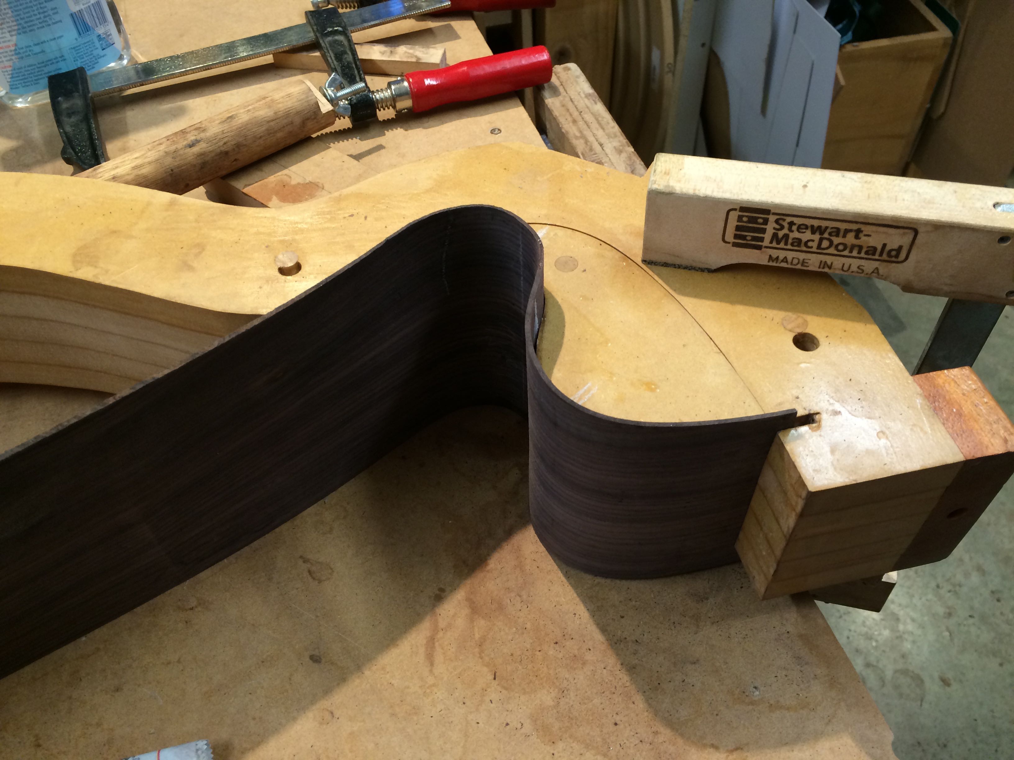

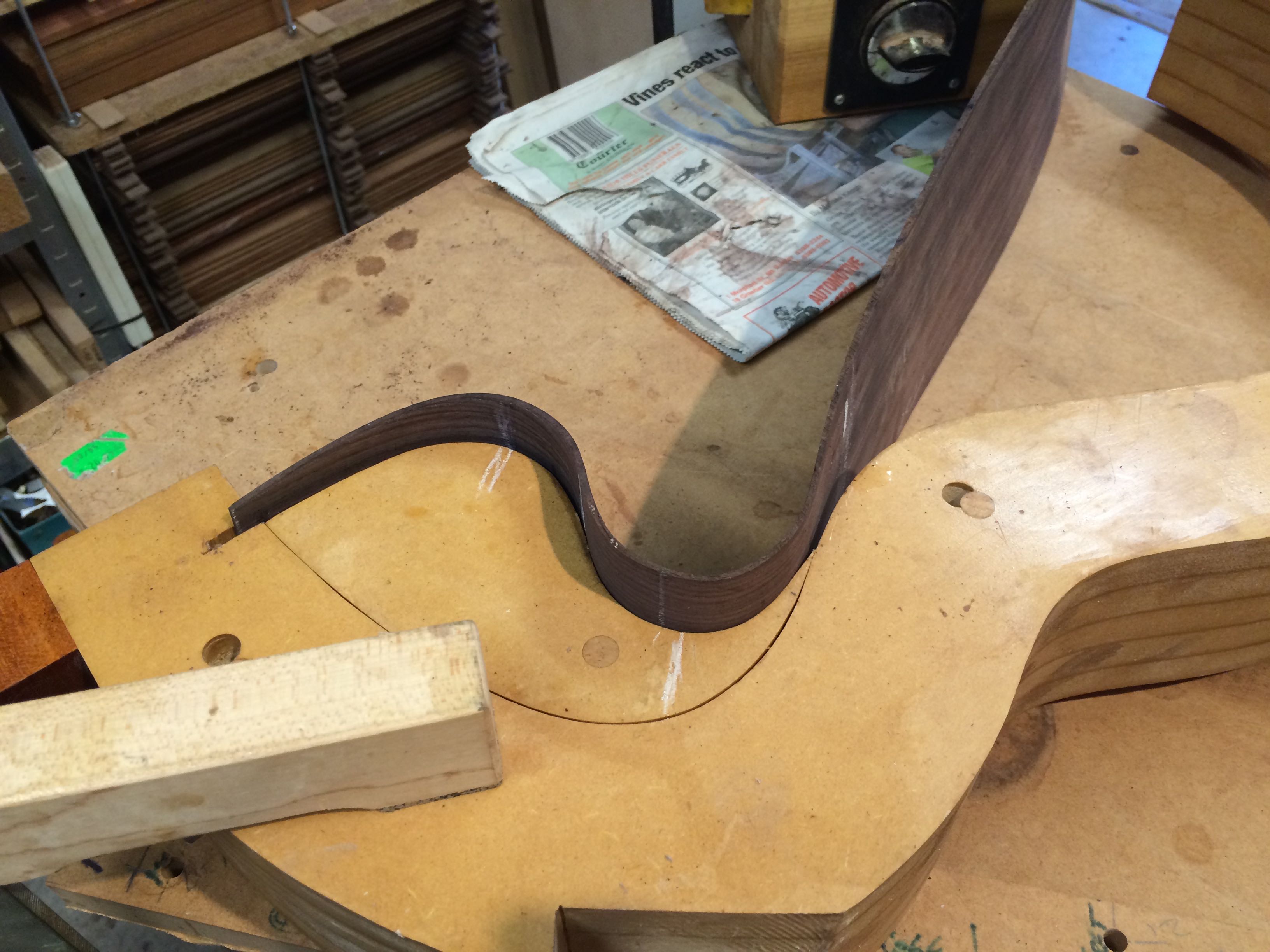

Third attempt at hand bending a venetian cutaway.......just about had it nailed...then the friggin' side split in half as I was trimming the end of the side with a block plane. :evil: :evil: :evil: :evil: :evil: :evil: :evil: :evil: :evil: :evil: :evil: :evil:

Ill get there....time to fine tune the mold insert so the cutaway curves are less tight.

What's the thickness of the sides at the cutaway?
Looks quite thick in those photos.
I work mine down to around 1.6 - 1.8mm in the cutaway area then add 2 small side braces for extra support.
Ohh and obviously soak for an hour in hot water.

Sides are worked down to 1.7-1.8mm around cutaway area.

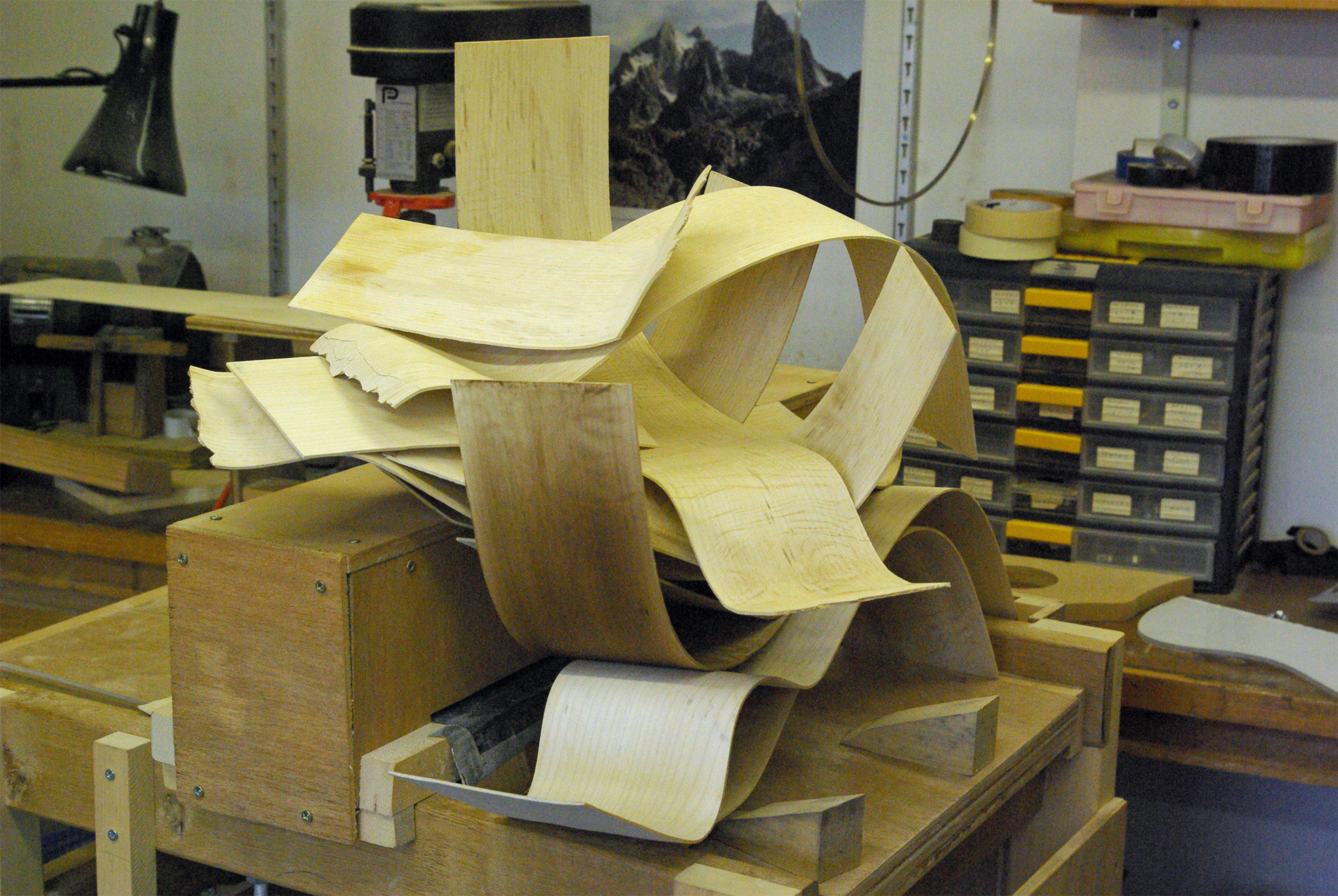

Funny that. I have completely failed to achieve the cutaway bend - and I have tried! Using maple so I can't afford to let it get too hot because of scorching. Tried with some water, with a bit more, a bit less. Wrapped in Al foil since I am using spring steel...
I am using a home made bender based on the Art Abrahams machine which is based on Mike Doolin's original insight that you have to tension both bending slats to provide support around the s bend. Silicone blanket, thermocouple, dimmer switch heat control.
Still can't do it.
I have put it to one side for now to have a practice at a falcate braced classical of traditional shape. I am going to try and find a guitarmaker willing to give a couple of hours tuition.
Good luck with your continuing efforts.

Maple I give the smallest amount of water, if any. Have done Florentine cutaways in figured Maple on my Archtops, IRW I give a reasonable spritz as I do with most other timbers I've bent (I've always built with a cutaway of some description) and the bend on a Maccaferri is the tightest I've done. I've always used an iron and hand bending, I just bend a little at a time (don't try to bend all in one go!) and let the timber bend at it's own rate I just supply a little tension to help it go, I hardly ever force it to bend unless it wants to be particularly awkward. Unless it's highly figured timber where it could split on the end grain figure, I've never used a slat behind the bend either to re-enforce it, fortunately to date I've never had to convert my efforts into kindling or firelighters :D So it is possible Dave, don't give up just got to be patient :wink:

Thanks Dave....your picture of the pile of mangled maple made me feel alot better....nothing like knowing someone else is having ten times as much trouble bending venetian cutaways as I am.
