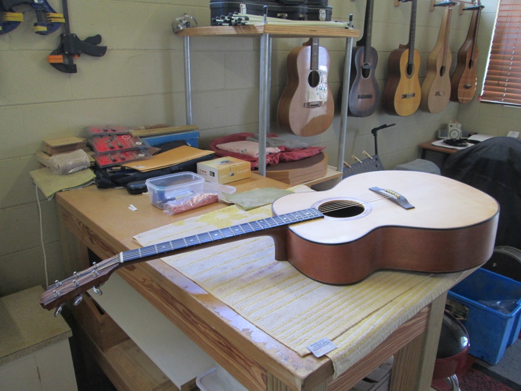

Thanks Jim I am stoked I pulled it off! The neck set was perfect so it was just the matter of getting the new top to fit in the old brace notches, I took off the clamps this morn, pulled out the paper inside the body and gave here a tap and as usual the pitch has dropped two tones to G. The neck is straight and lines up and there is a little over hang in spots that will be removed when the binding channel is cut.

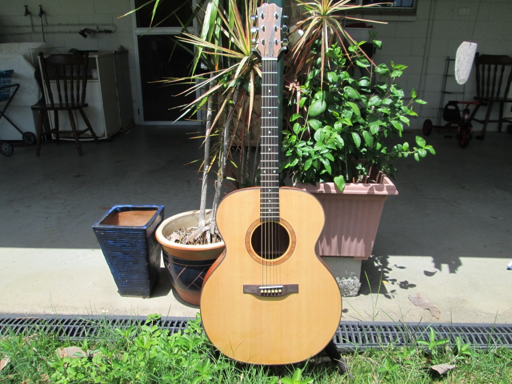

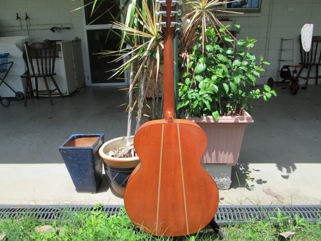

I started this guitar re-top sometime ago and my health went down hill so all stopped in the workshop. Health is much better now so back in the shop catching up on all my projects I had started. This Jumbo was going to be thrown out but I decided to have a go at a re-top and it worked a treat, I used one of the $10 Lutz tops that Shane offered on special. It's a big boomer, with great sustain and finger picks nicely as well. Very pleased at the outcome. A few final stage pics for you all:
