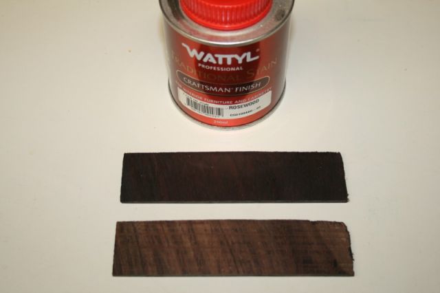

I did a quick test staining of a bit of the Op grade EIR from LMI that arrived during the week (Thanks Dominic!).
I used the Wattyl Rosewood stain, which is quite dark to begin with. I also applied it pretty thick, but wiped off the excess after only a few seconds. Use gloves!
Here's a before and after shot.
The ends look a bit darker than they really are. The colour is a bit more uniform across the piece. In the sunlight, it has a really dark red kind of look.

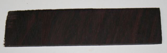

Here's the other side of the stained piece. The colour is a bit more even than my first try.
I quite like it nice and dark. But I may try thinning the stain a little in the future (with Metho?).
