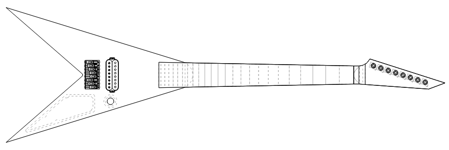

Hi Guys,
I hope with my tax return to start my very first guitar build. I'll be utilising the resources and skills from the very talented woodworking club that operates near me for guidance, as well as this forum.
I have been meticulously designing my axe with CAD software to analyse the dimensions. I have to describe in both inches and millimeters as some parts/tools are from the US :?
What we have here is an 8 string, 30" scale, 30mm thick very pointy V with a fender-style non-angled headstock and dual trussrods. The bride is 8 individual Hipshot solos, the tuners, 8 Grover mini locking rotomatics and Dunlop 6100 fret wire for shredding. The choice of pickup and nut will be decided later. It will probably be a bolt on, but I may be convinced to do neck through.
There will be a cavity in the bottom wing for the addition of counterweights, to prevent neck dive, and I will also be adding a fibreoptic side dot illumination system to the fretboard, no front dots.
Wingtip distance is 400mm and if the body is to be bolt on the body length from between the wingtips is just shy of 554mm. If you continued the outer angles of the wings they meet at the centre of the 12th fret for a distance of 650mm. Inner wing union is 230mm.
My big question is about woods for this beast. My goal is to use ethically sourced timber and ideally I only want to have an oil finish and price comes way before tone.
For accuracy of fret slotting I'll be investing in a Stewmac fret slotting miter box kit with appropriate fret template.
Lay it on me guys :D

Forgot to add it will have a 16" radius

30mm thick is a bit light on for fitting in pickups and electronics and also to have enough to bolt a neck onto.

Post by dougmurray85 » Mon Jul 21, 2014 5:05 pm
the 30mm came from the 1.25" description from some Gibson flying V blueprints.
*Googles a tele blueprint*
A whole 0.5" thicker :P

Just in case you cant see the V in the original post
