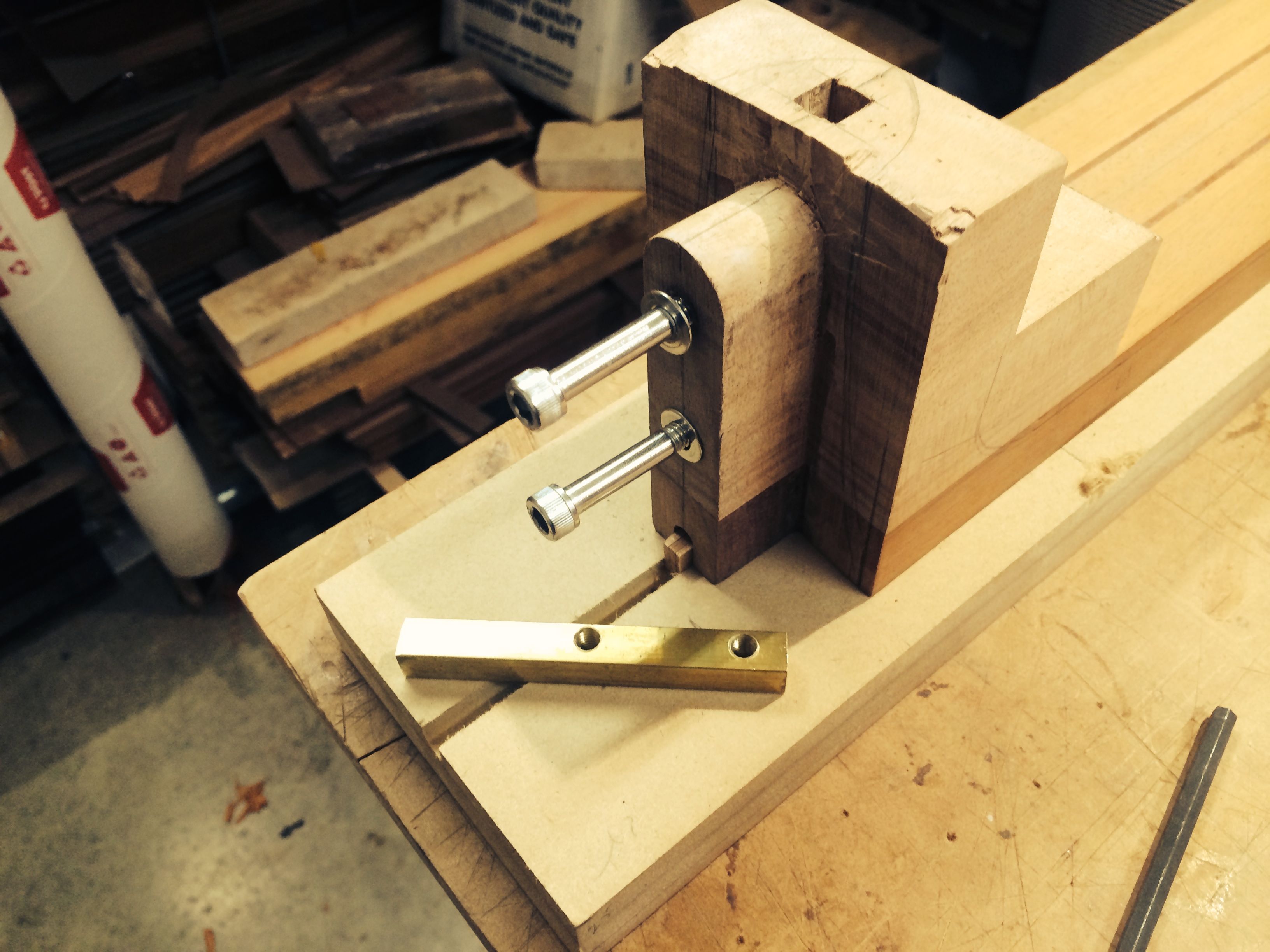

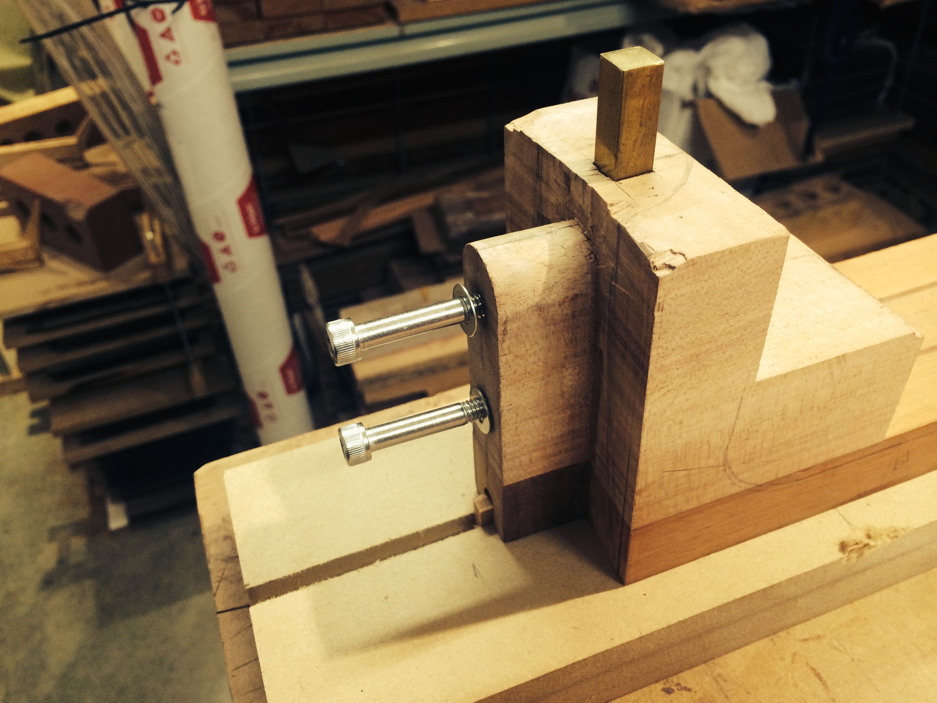

I like Trevor's bar anchored bolt on system much better.....there's no way you're going to pull a 10mm square brass bra through your neck.

Yes I'm currently building a classical with a bolt on/bolt down neck as per Trevor's book.
The only "complicated" aspect of the square anchor bar method is having to drill a square hole through the heel to fit the anchoring bar. Trevor uses a drill press with a morticing attachment, I went one step further and bought a dedicated bench mortiser.
In his book Trevor discusses the round versus square anchor bar argument and mounts a convincing argument against the former.
