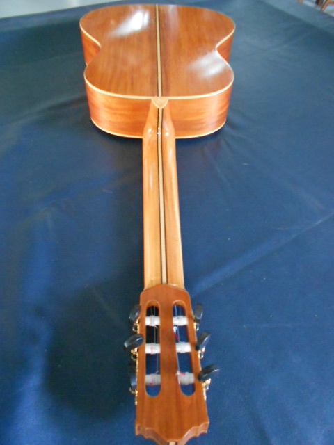

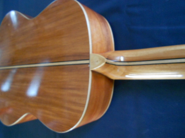

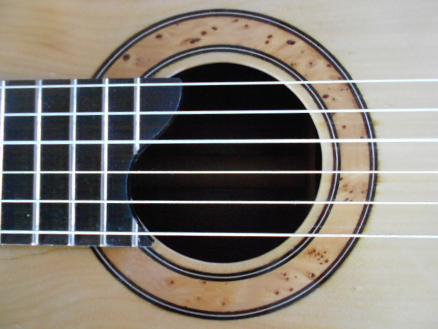

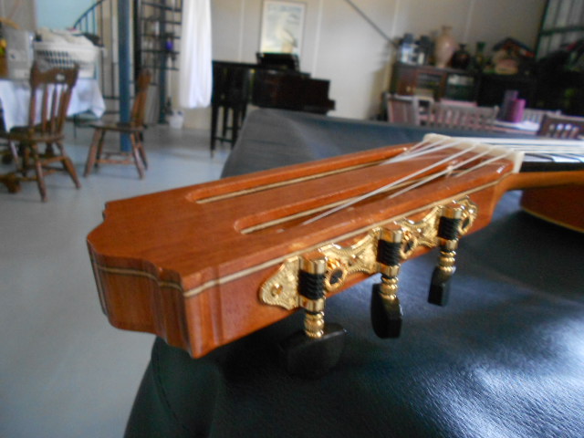

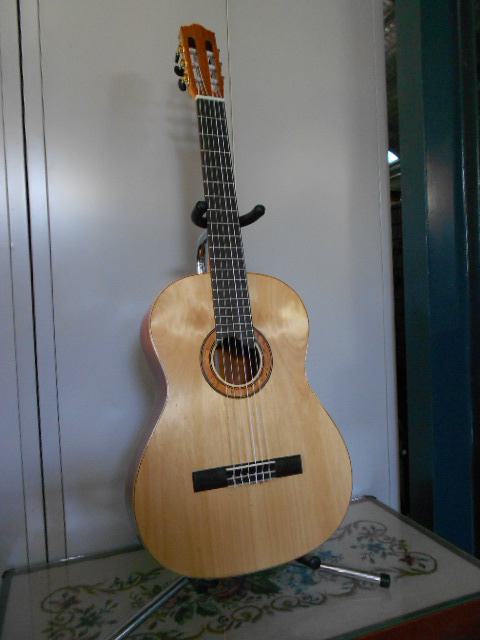

The christmas break allowed me to finally finished my first OM, it is only a shed guitar and nothing exceptional.
Specs.
NG Rosewood back and sides with jelly and ebony bindings
Figi Mahogany-Jelly-Ebony neck
Birds Eye Hoop Pine top with Huon burl and ebony
Fingerboard and bridge are Ebony
It actually sounds pretty good, possibly a little to much sustain, I will give it a final finish in a couple of months after the nitro has shrunk a bit.

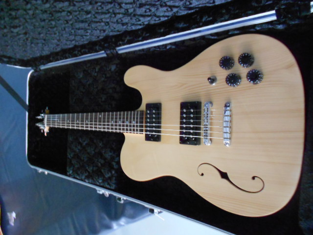

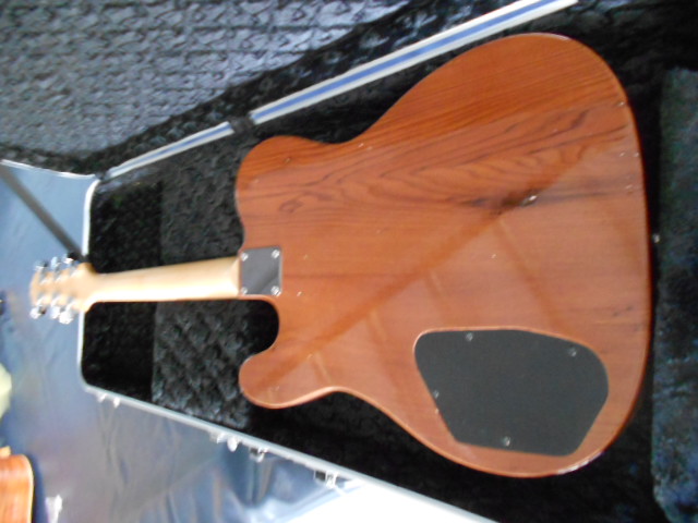

Also a couple of pics of a chambered electric made out of an old cedar door, a pallet and all sorts of left over bits.

It was very hard to buy a decent set of strings after xmass near me all sold out of the good stuff. I DON"T like the strings on it at the momement, the third string is fatter then the sixth.

Re: Finally finished my first OM
I totally missed this one - I searched for it because you mentioned it elsewhere on the forum
. Very nice and clean work here, and quite a bit of well thought out odd-ness. Simply striking!
The top of the classical guitar is puzzling me: the lower bout seems to be quarter sawn, and the upper bout flat sawn! Looks very unusual, but maybe not everyone's cup of tea (people want straight grained, tight grained, very uniformly grained, thus boring soundboards!

Did you use any of John Bogdanovich's teachings / templates for your classical?

Yes it is a John Bogdanovich's plan & templates I used. Now the nitro has had a few months to shrink back I am going to finish it off. I had a few great musitions give it a try and some believe it is too bright (they used a mike through a PA system to try it out I don't know if that made it sound bright) and others think it is a good midrange tone, the hoop pine top definalely gives a lower bell like tone when you tap it unlike spruce that I find bright in comparison they all commented the vibration felt in the top and back were excelent. The only problem I have is some vibration with the sixth string between the 4th and 13th fret, I flattend and re-radiused the frets checked with a rocker etc all looks OK, there is something in the build that is vibtating in that range, so frustrating.
I will put some more pics up after I finish it.
What it jelly you ask? well it's a commonly used pattern makers timber nothing fantastic but it's real nice to work and has very little movement or shrinkage due to varying temperatures etc. The name jelly is only a nick name the correct name is jelutong ( Dyera costulata ) it's used now as yellow pine, sugar pine honduras mahogany etc are too hard to get and too expensive. I had some lying around left over from some patterns I made some years back, I aslso had some sugar pine but the white ants thought it was nice and sweet.
