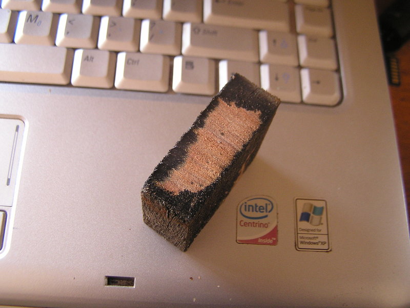

Post by woodrat » Tue Oct 29, 2013 2:15 pm
Jim this Blackwood blank has been in for about 2 weeks. As you can see it seems to penetrate fairly well. I think that several months would be the go...

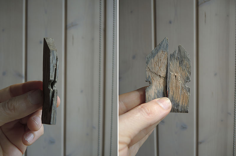

Re: Black Blackwood Bridge....
Post by charangohabsburg » Thu Jun 26, 2014 10:30 pm
woodrat wrote:Jim this Blackwood blank has been in for about 2 weeks. As you can see it seems to penetrate fairly well. I think that several months would be the go...
You experiments yielded some pretty amazing results John, thank you!
That kind of color penetration is really useful, and also is the black as black as black should be.
As there is no blackwood growing in the woods here around I thought oak, known to also contain tannin, could be a candidate for obtaining similar results. It turned out not to be the case. Two weeks of soaking a piece of oak in a magic brew after your receipt yielded a grey color with light greenish and dark blueish hues, and penetration was pretty poor at about 10 - 15 mm from the end grain side and 0.5 to 2.0 mm on the other surfaces.
However, good to see that "something" can be done.
Maybe I should add some planks of non-figured blackwood to my stash. :roll:
