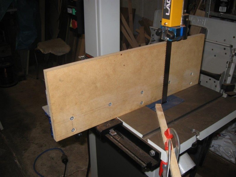

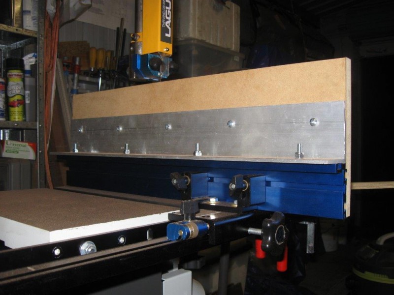

I had a Kreg Bandsaw fence off my previous Jet 14 that I fitted - no mods to the table required and just one additional hole need to be drilled in the fence mounting rail. I also had a long piece of Kreg L-Beam off a Kreg Mitre fence that I wasn't using. Added a high fence and some re-enforcement as per:
When I don't want to use the high fence it just come straight off and the original shorter Kreg L-Beam goes back on for everyday use.

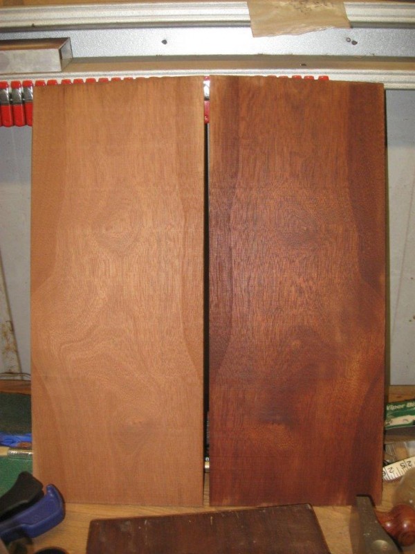

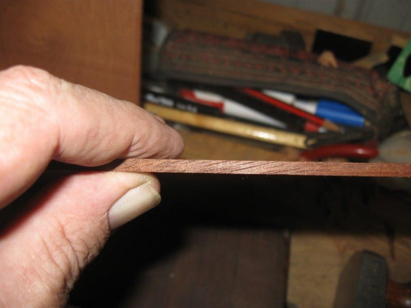

I've only done a few test cuts so far with a Laguna Shear force blade but all seems to work well - a little bit of "barrelling" to the cut - I think I have to play around with the drift angle a little to get a completely vertical cut. Tested it with a piece of Miva Mahogany I had laying around.
