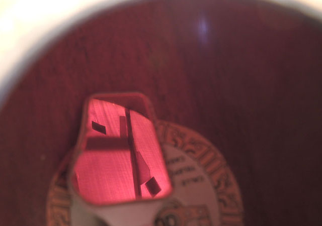

Last December I had to repair a nasty crack in a charango top that already had been repaired previously by a German guitar maker. He had done a very neat job, but one cleat for a crack that runs from the bottom of the top all the way up to the lower harmonic bar is not enough, not even on a small instrument like this (total string tension of a charango is about the same as the one of a classical guitar). Juan Achá, the maker of this little treasure is one of the most renowned charango makers of Bolivia, and all the tops of his charangos I have measured so far (maybe ten or so) are somewhere between 0.8 and 1.4 mm thin. I won't go into the details of the repair, but the following picture of my completed repair (the two transparent cleats) should illustrate why I wanted to use the lightest and strongest spruce cleats ever found on planet earth:
The dark cleats (mahogany I guess) are the ones used by the previous repairer and are about two or three times thicker than the ones I was using.
The crack holds up well and the owner says its sound and playability would be just the same as before.
I believe that not runout-free cleats of the thickness I used would not hold up. Not if that close to the bridge.
I had split completely runout-free cleats out of a discarded (free) spruce top with horrible runout. The cleats are about 25mm long and 0.4 mm thin. The bigger one brought 0.05 grams to the scale (one half of 1/10 gram), which I thought was acceptable.

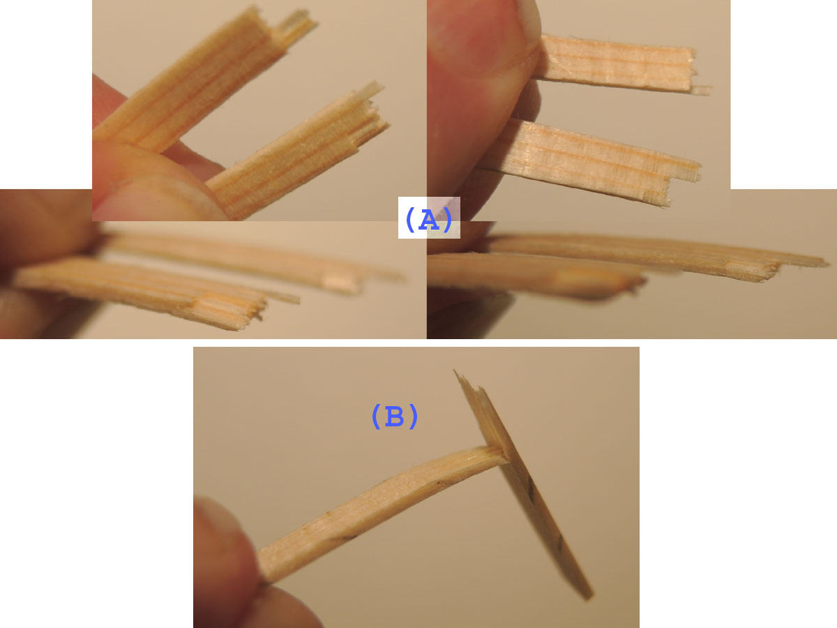

Back to runout: some close-ups of the broken samples and fibers, again (A) = no runout, (B) = runout ration 1:15 (click to enlarge).

At first sight your assumptions may look reasonable Trevor, but I wouldn't go so far to draw any conclusions regarding the bending moment by only looking at this simple experiment and without measuring applied forces. The only thing I can say is that the runout-free sample is much more resilient, thus less prone to cracking and plastic deformation.
Let's have another close look at the breakage. In the pictures below it becomes evident that the breakage of sample A occurred in a different way than the one of sample B. While in the runout-free sample A apparently all wood fibers let go much in the manner an stretched rope lets go when stretched too much, in sample B all wood fibers (except those that still hold the two pieces together) separated, without actually being cracked themselves.
Also, considering that wood, when bent will deform plastically before breaking, and observing that sample A stays slightly bent over its whole length while sample B only stays bent within the few millimeter of the skewed cracking zone I venture to say that the stress distribution only works well along the wood fibers, and much less so between fibers. This may seem trivial because we know that a sliver of end grain wood almost can not be bent at all without breaking it, but it still may be a surprise that a runout ratio that can be found in lower, mid, and even some higher graded spruce tops make such a great difference.
With this I don't want to say that it would not be possible to make a decent, good or maybe even very good guitar with a top that has a lot of runout, but I dare to say that it will be impossible to get somewhere like close to replicate the sound of a guitar with a well performing very thin top, if trying to use spruce with heaps of runout.
