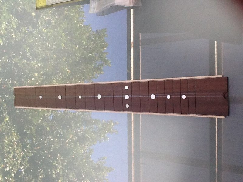

Post by nnickusa » Mon Feb 03, 2014 5:22 pm
I've got to decide on a fretboard inlay set for a 12-string I'm building for a mate. I do't want to buy more pearl just yet, so a quick forage in the pearl jar gives me this lay out. Like?
I've bound the board with white/blackpurfs and curly maple binding, so I think it's busy enough without going over the top on the inlays...'sides, I really do like plain dots a lot of the time...

Post by kiwigeo » Mon Feb 03, 2014 5:43 pm
The big markers don't work for me......personal preference and individual taste of course. I'd use only the small markers and I'd only use two markers at the 12th fret. I build alot of classicals so I guess Im heavily influenced by not having any markers or only side markers.

Post by Shane Woonton » Mon Feb 03, 2014 6:47 pm
I'm with Martin. I would just use the small dots. If you only have those in the image, go for 5,7,9, two @ 12, 15. It's the way Collings do theirs and I think it looks nice and clean.

Post by Tod Gilding » Mon Feb 03, 2014 8:45 pm
I would use the small ones only, if you have enough with two 1 under the B string and 1 under the A string at the 3rd one at the 5th 2 @ 7th 1 @ 9th 3 as you have using one large for the centre @ 12th and 1 only from then on @ 15th 17th 19th in small size.

Post by Wayde Christie » Mon Feb 03, 2014 9:20 pm
What everyone else said :)
It's interesting to me that everyone has a similar opinion... I often find in my day-job as a web designer that my clients have a certain expectation that a website is going to look a certain way. If I design something that deviates from their perceived norm too much, it's often hard for them to cop.
Personally I *expect* fret markers to look a certain way, and if they deviate slightly, my brain detects they're different and gets upset.
Yeah, it's "dot-ism" :D

Post by Kim » Mon Feb 03, 2014 9:51 pm
Must agree, when it comes to FB's it really is a case of less is more...Big shell is loud and does not allow the wood to do the talking. 8)

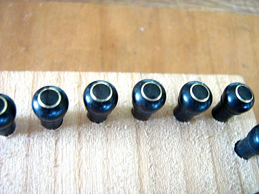

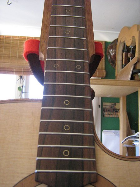

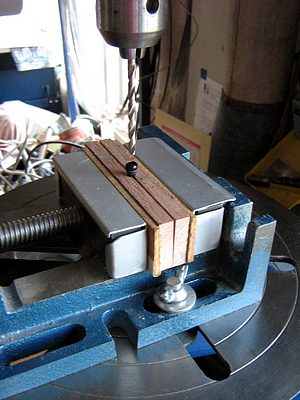

Post by Craig » Tue Feb 04, 2014 7:52 am
Here's a more subtle alternative I've made in the past rather than the solid mother of pearl or Paua dots
A bit more work than you might first imagine. Cut some round pieces from the fretboard offcuts to match the grain of the wood where they are to be placed. Glue those pieces into sections of brass tube and inlay them in.
I also did the same to some plain Ebony bridge pins to match

Post by nnickusa » Tue Feb 04, 2014 8:05 pm
Nice work there Craig. Very elegant.
I've decided to just go 5,7,9,12,15 which uses up my 6mm dots.
