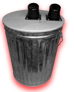

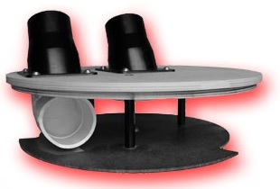

I don't know whether this is the type of thing you are looking for but you could have a look at The Thien Cyclone Separator Lid
w/ the Thien Cyclone Separator Baffle.
Regards,
Steve.

Hi Steve,
Thanks for that, I'll get some fittings together and make one up. Will be a whole lot cheaper than too.
I'll let you know how it goes
Thanks again
Graham
