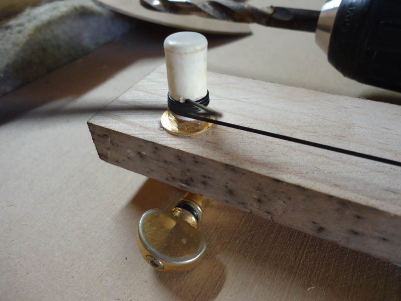

I am considering making a nylon string guitar. Not a classical but my "lounge guitar" (so the parlour guitar puritans don't come knocking on my door with pitch forks making sure I use a ladder brace) with nylon strings. I like the solid peg head but can't find a tuner with a large capstan, do they exist? is it necessary?

Thanks Allen, maybe this is not needed then. I just cut off and drilled a hole up the middle of this old plastic classical capstan as well as putting a bit of a taper from the hole down (like the taper on a steel string capstan) then slipped it over a old tuner. As the outer capstan is loose on the inner one it clamps onto the string when you tighten (worried it might cut right through the string). I would cut that down level with the inner capstan and could make them out of aluminium, brass or copper, wood might be too fragile but would look good. I have wound that prototype up seriously tight to see if in a bit of time it will sheer through the string.

This seems to be okay, I have been winding it up and down to way over normal tension and it hasn't cut through the string yet. I may have just invented locking nylon string tuners for solid pegs heads, does anyone have directions to the local patent office. :D
Edit, I can now see them in aluminium with wood caps to match the headstock.
