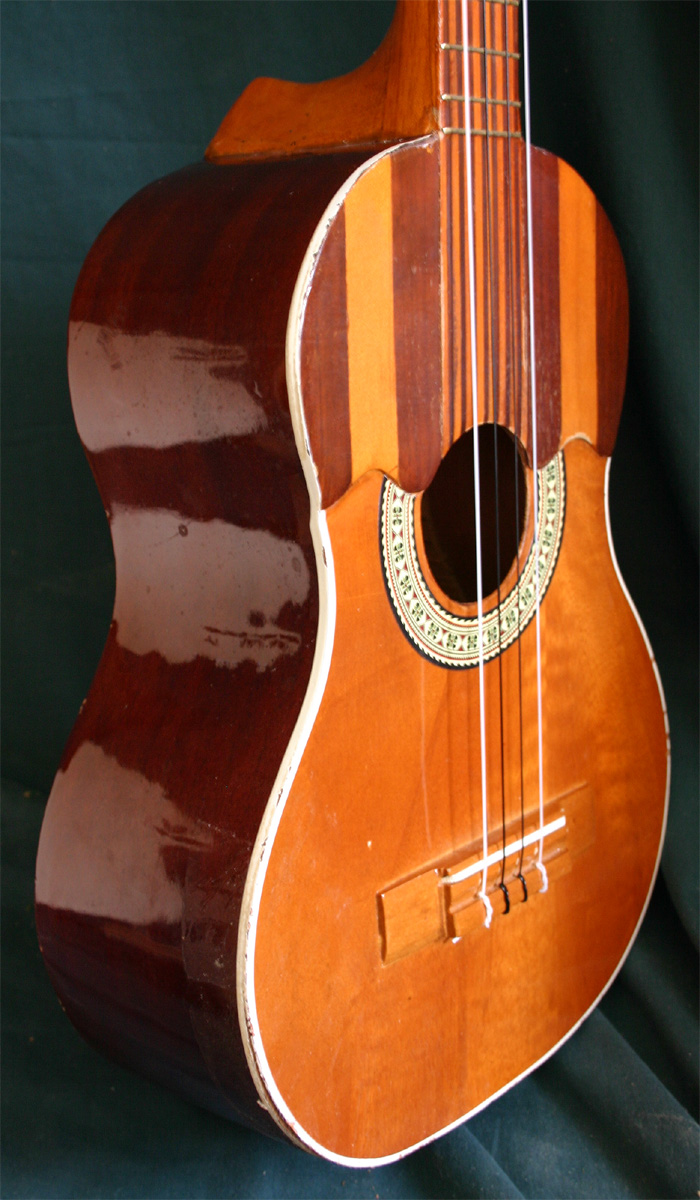

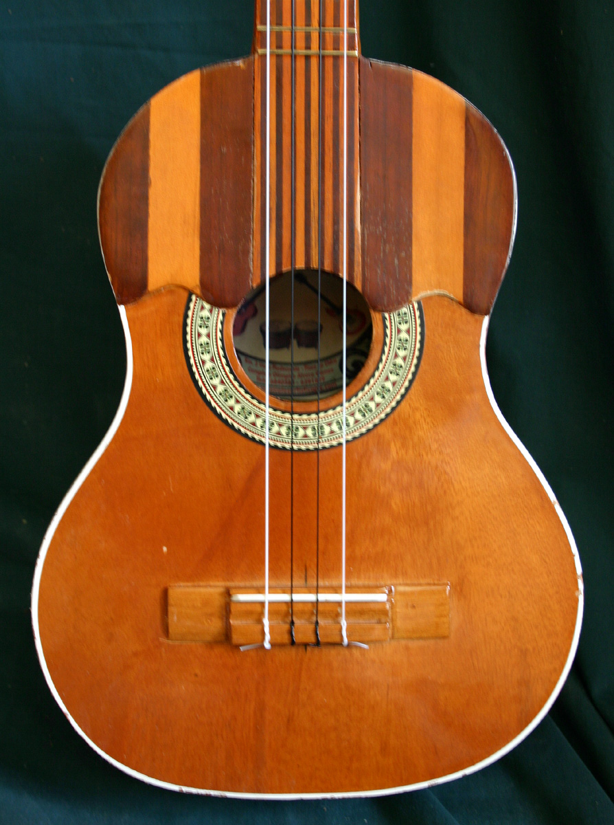

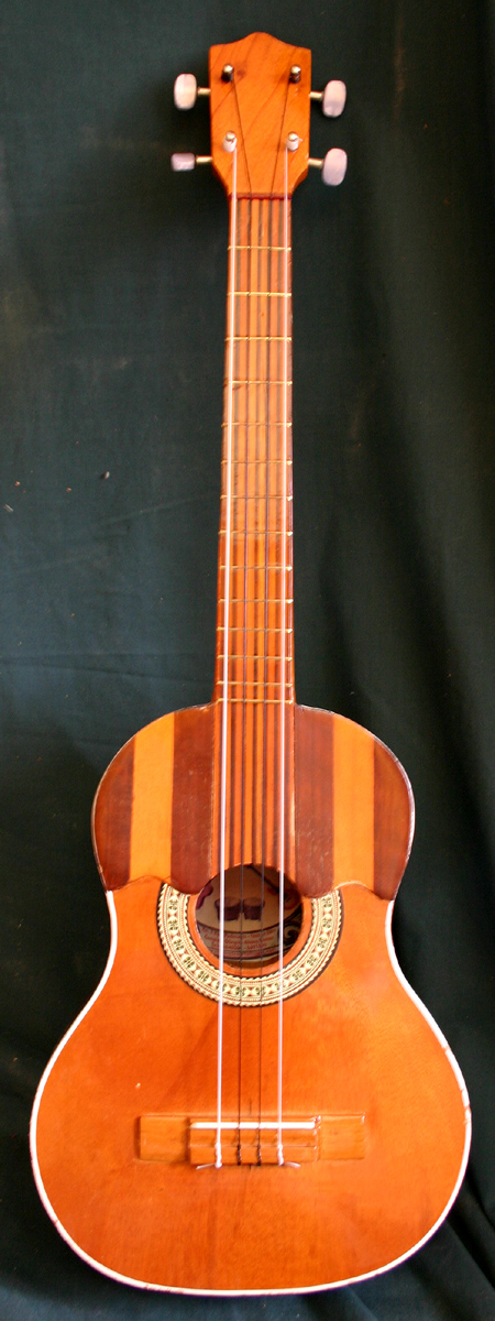

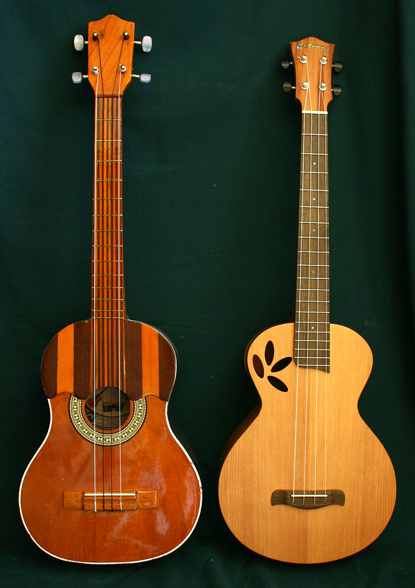

This is an old Cuatro instrument from Venezuela, which my friend brought about 20 years ago in a local market. Although crudely made, It has the most amazing tone. My mission is to uncover and replicate its magic, but with my own signature aesthetic. The depth of this instrument is more like a guitar at 97mm!!
Should be a fun build.
Christian.
Christian.

Nice.
How big is the instrument, looks like Tenor Uke size?

Re: CUATRO.
Hi Col,
It is similar to a Baritone I guess at 350mm long, 255mm Lower bout. The sides are really deep at 97mm and the scale length is 21.5"
Christian.

Re: CUATRO.
Yes, Cuatros are quite fat fellows.christian wrote: The depth of this instrument is more like a guitar at 97mm!!
Interesting how the maker made the 14th fret coincide with the body's upper bout boundary!

Re: CUATRO.
Yeah Markus that 14th fret placement is a cracker, actually I'm not sure any of the frets intervals are where they should be because it is bloody impossible to tune. Still, like I said it sounds awesome.
A few design requirements from the customer are that the neck needs to be easily taken off for easy international transport but with no visual impact on the design.
A slotted headstock, offest kauri leaf soundhole, A frame cored bracing, piezo disc pickup.
Materials, Kauri top, Rimu back and sides, Kauri neck Puriri fretboard and bridge.
The proportions are mud, so I'll refine that a little. If the customer wants 14 frets to the body I'll make the body longer because of where the bridge will fall, 12 frets would make more sense to me.
Christian.

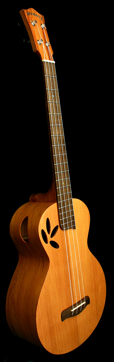

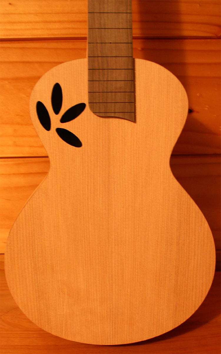

Hi,

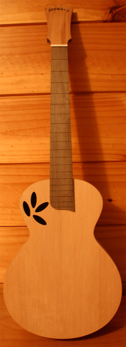

So I made a start last week on this cuatro, now called the Cuatro Kauri.
I essentially down sized one of my guitar shapes until I got the dimensions close to the original.
I went with a 21" scale body neck join is the 14th fret.

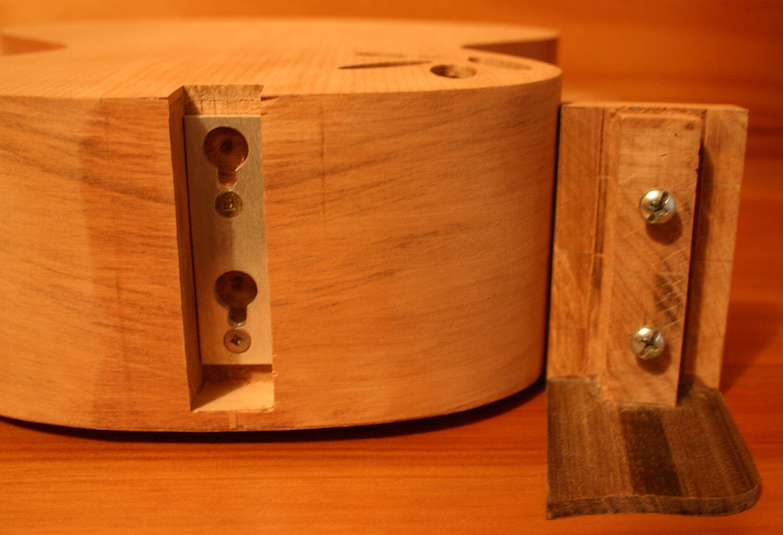

The neck body join is essentially a keyhole style set up. The neck has two corresponding screws which are tighten or loosened to adjust the fit, it works really well!
Christian

Re: CUATRO.
Beautifully proportioned, Christian, very elegant indeed.
The neck joint looks too simple to be true.
How do you lock the neck in place so it can't accidentally be tapped loose (or gradually work its way loose)?

Re: CUATRO.
Hi Miguel,
Thanks for the kind words. The neck can't really come loose as it locks down into the key. It is a firm fit but not so tight that you can't lightly tap it to remove the neck.
Christian

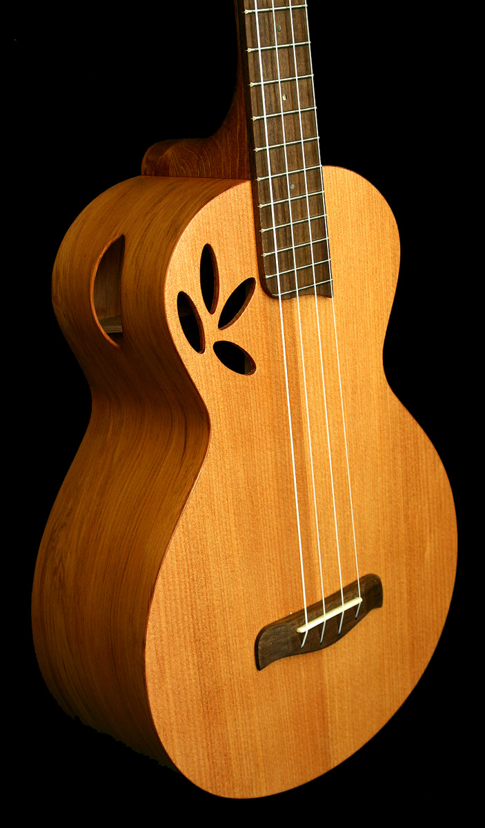

Well the Cuatro is all finished, nothing like the original of course.
certainly sounds good. I'm gonna hunt down some aquila baritone red series strings for it.
The proud new owner is gigging with it this Sunday.
Christian.
