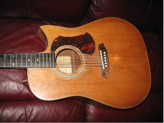

Pics aren't really showing much....apologies.

I'd be gluing and cleating the splits with Hot Hide glue
The Top definitely looks saveable

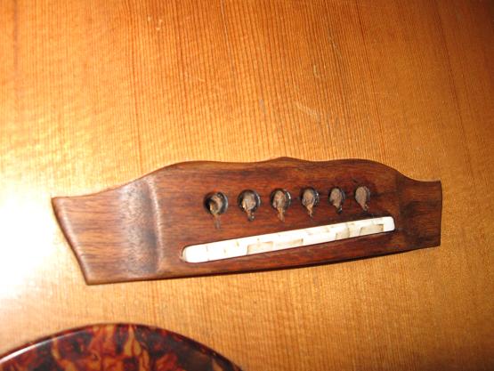

Is that a crack in the bridge too?

Yeah, Jeff the bridge has two splits. How would I go about fixing the roll in the bridge? Would a spruce patch between it and the soundhole do it? Is it fixable with the box intact, ya reckon?

Hard to say from the photos, the actual bridge rotation does not look excessive
The saddle has rotated because of the split in the front of the bridge
You can either pull the bridge and glue it, pull and replace with a replica, or see if the parts will come together without string pressure and do a dust and superglue job.

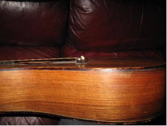

The pic doesn't really show it but there's a dip in the top between the bridge and the end of the fretboard of about 4mm.

Looks good, dont replace. Cleat and glue and steam any bridge lifting areas flat again

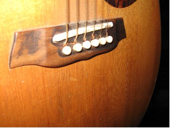

I managed to pull the split bridge back together and lined the slot on one side with a sliver of brush box.
The saddle sits on top of a piezo wire shrouded in material similar to plastic fuel pipe.
To adjust for the roll I have glued a shim of hardwood onto the underside of the saddle and sanded it on a slight angle so as to make it stand more perpendicular as well as adding a tad more string height to the treble strings.

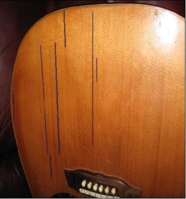

The cracks in the top are next but I have one query about how to re-glue one of them....The crack closest to centre runs exactly along the edge of the top's centre-strip. The strip is only a short piece between the tail-block and the intersection of the X that sits behind the bridge.
As the strip and top are on different planes it is not practical to cleat unless the cleat was 'stepped'...but this sounds very difficult to pull off. If I could mask either side of the split and fill with glue would this suffice and what glue would be preferable?

(I have traced the cracks on the picture to show what I mean.)

Here's a pic of the bridge now.
