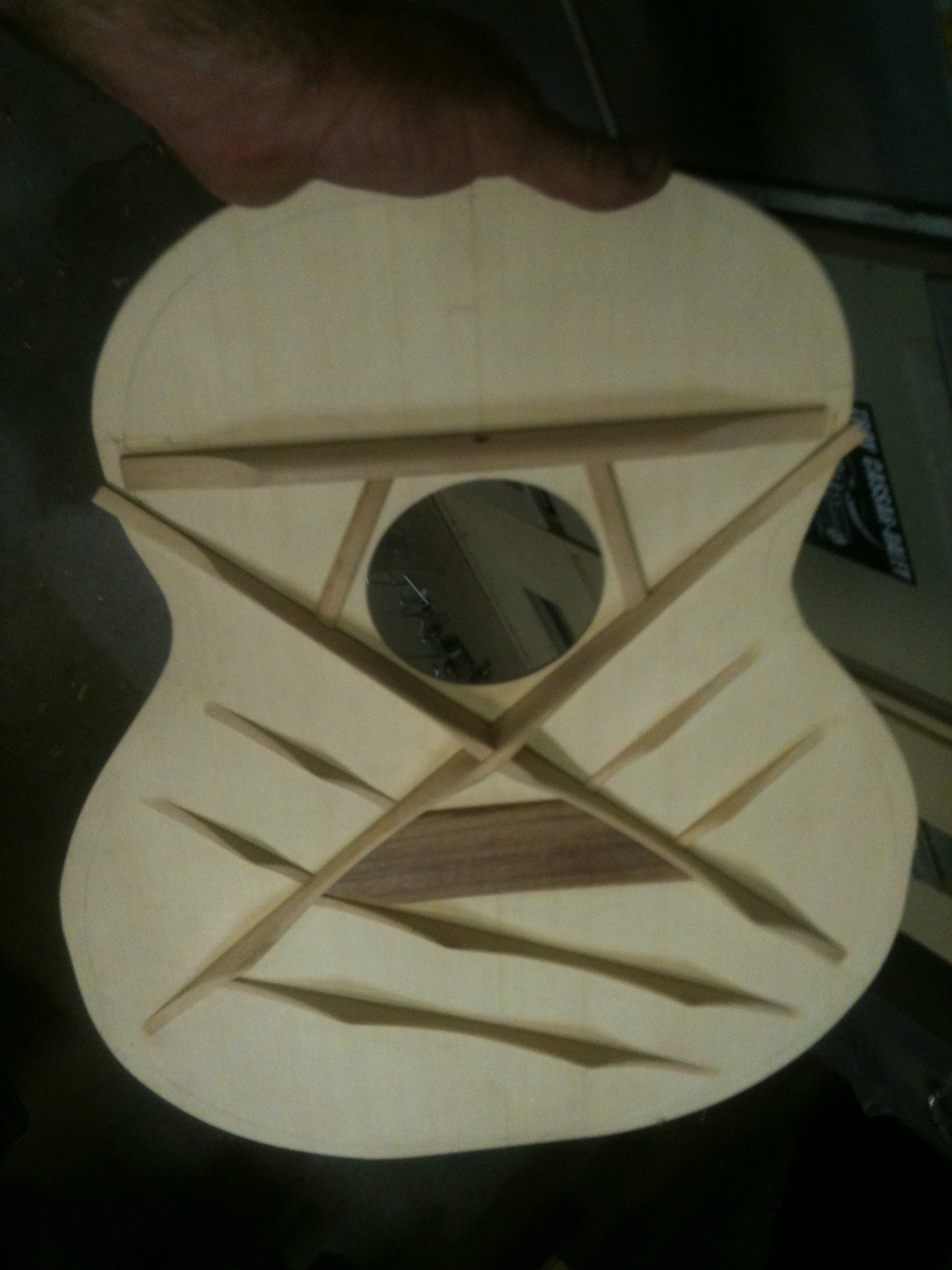

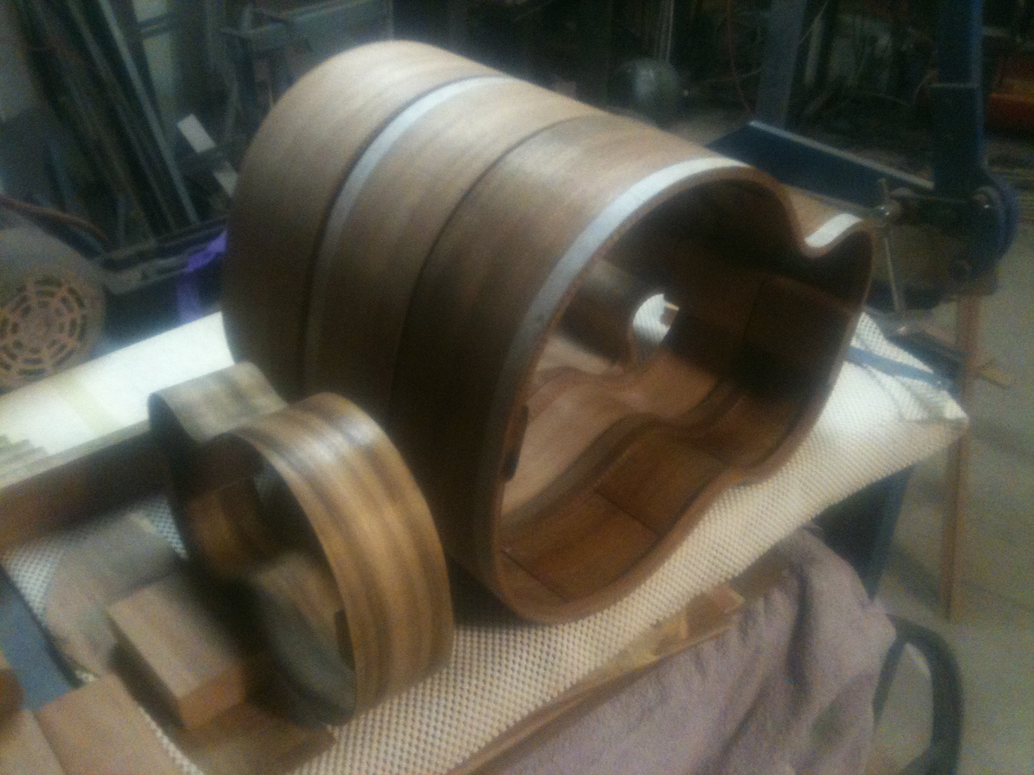

First acoustic builds.
Post by soulman » Sat Sep 28, 2013 9:44 pm

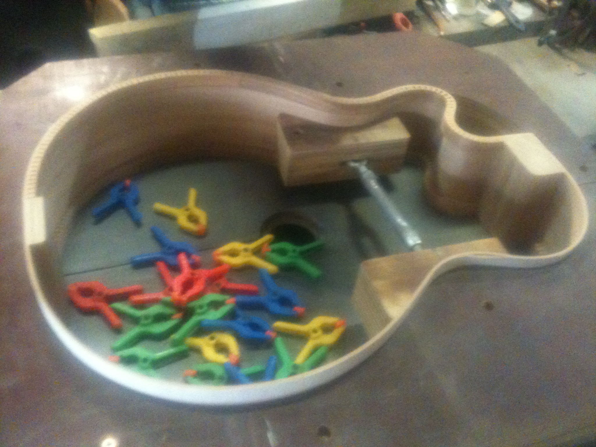

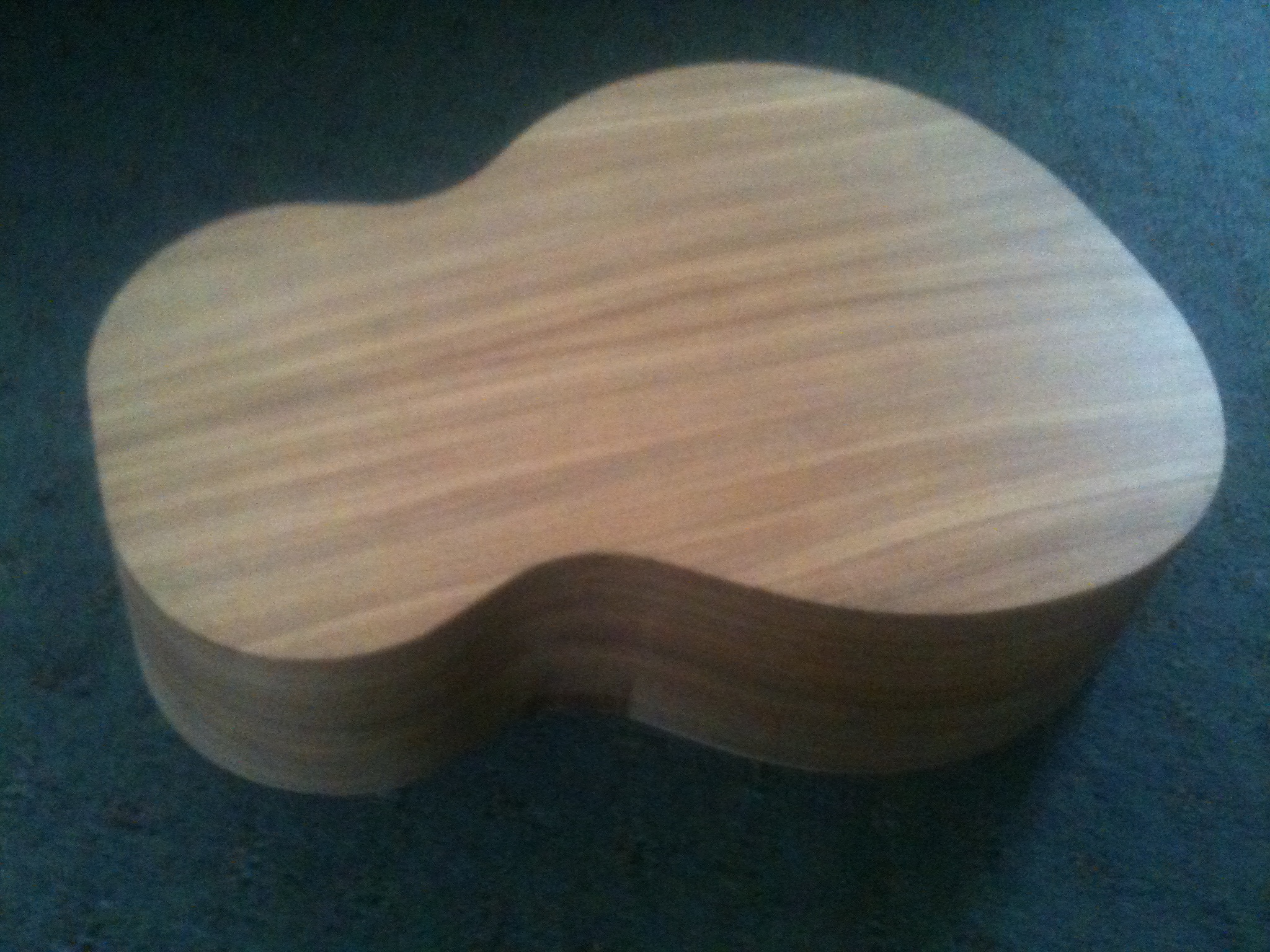

I started building ukuleles to learn about building and developing my ideas and skill level as I`m a fitter and turner. Kinda got hooked. So now it`s time to build some acoustics.
This is where I`m up to. Two are Qld Maple B&S and the other is Tassi Blackwood. Tops will be Sitka spruce. May put a cedar top on one of the maple bodies.

Welcome Soulman,
All looks in order to me, got the makings of some fine looking instruments there , can't wait to see the final product.
Seems the Ukes have taught you very well, do you have any photo's of your Uke builds, we all like looking at them as well.

Hi Soulman
Looking good so far .
Three at once you really are hooked.
Regards Steve
Re: First acoustic builds.
Post by simso » Sun Sep 29, 2013 1:17 pm
Your mould making is very good, all three look consistently the same shape, hard to achieve when your starting out.
Off to a good start I say

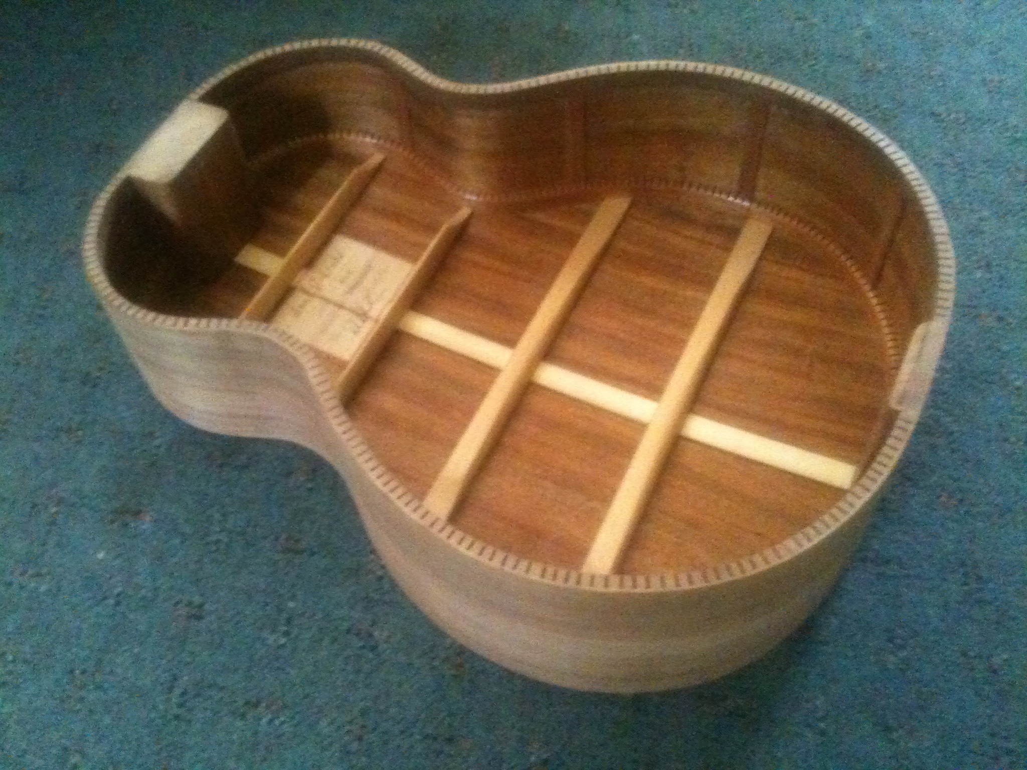

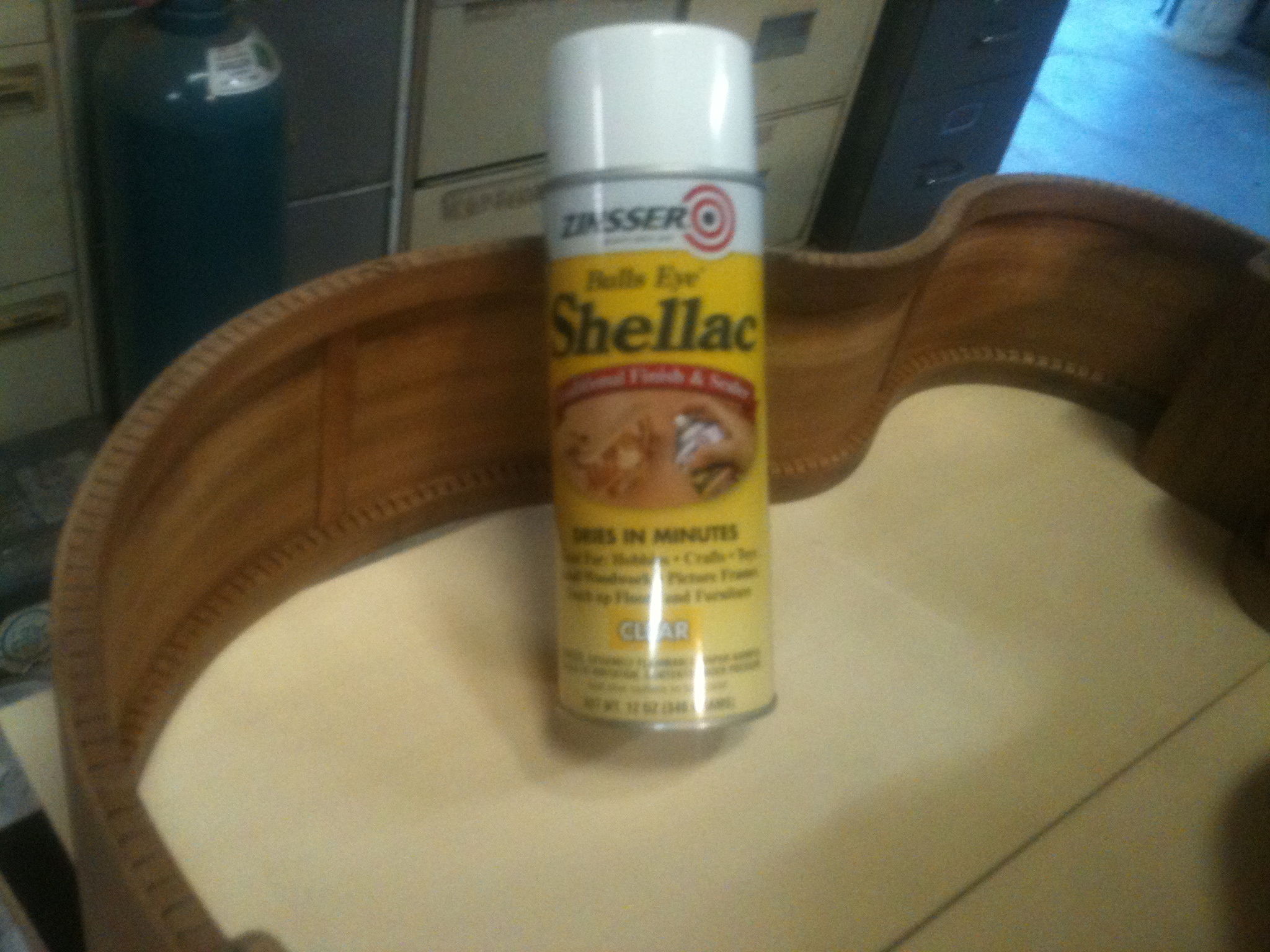

Post by auscab » Sun Sep 29, 2013 4:38 pm
They look nice Ross.
Whats with the blurry look , is that a romantic setting on your camera ? :lol:
Just kidding , I'm guessing mobile phone.
Steve [simso] pointed out " Your mould making is very good, all three look consistently the same shape"
How did you bend them ?
And I can see a finish on the inside, second picture down , what did you put on it ? It looks good.

Hi Paul. No not the settings. I`m about as romantic as a brick. :D So yes the mobile phone.
I bend on a bit of water pipe using a heat gun as the heat source.
I use spray can of shellac stuff. I get it from Masters also the cheapest place to buy titebond from.

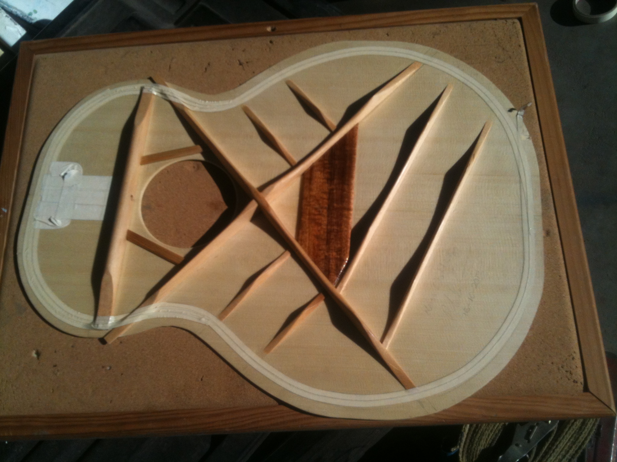

Post by soulman » Sun Oct 13, 2013 10:35 pm

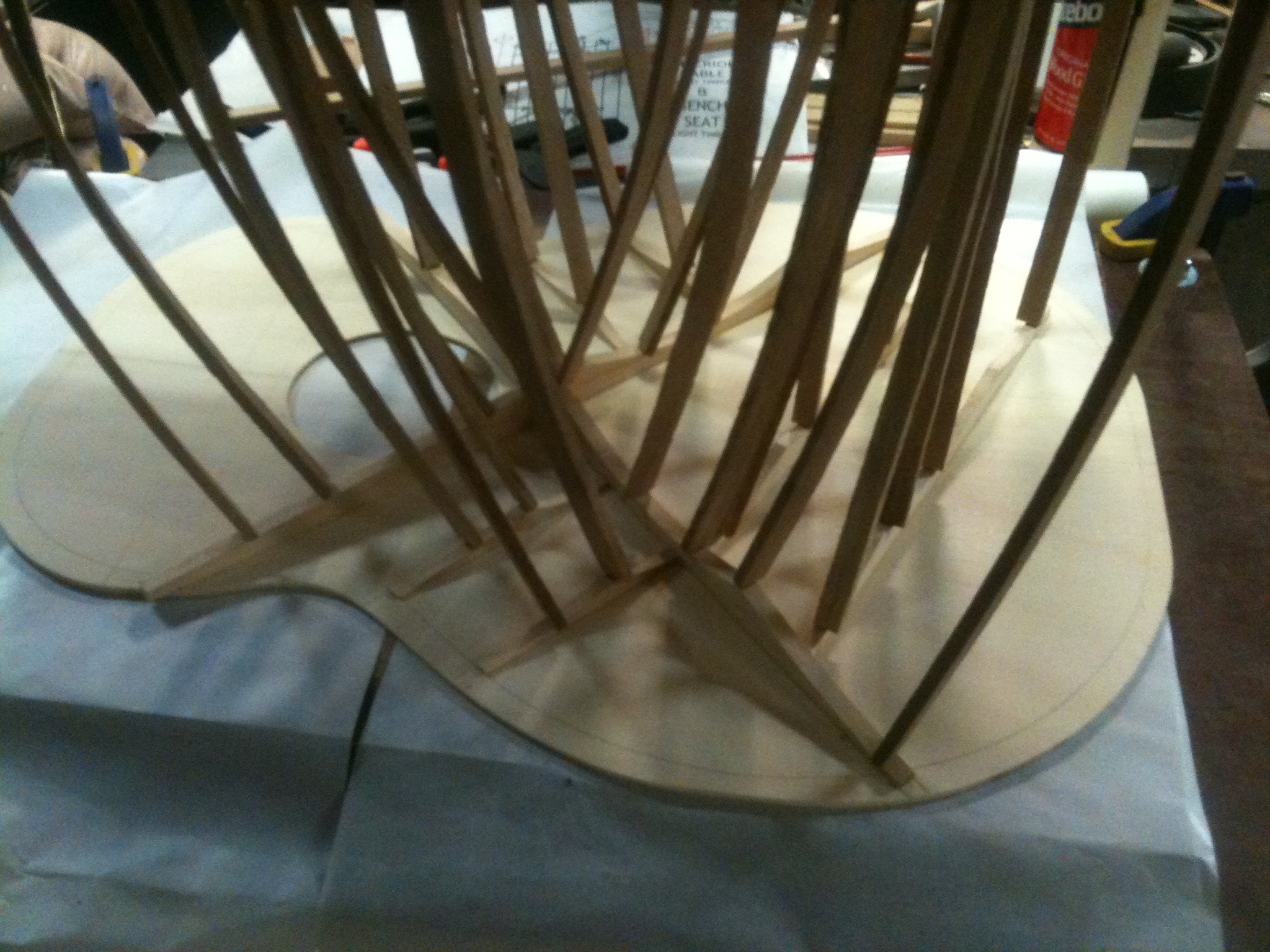

Just about ready to put top on blackwood body. Also knocked up a go bar system. They work great.

Post by Woodsy23 » Mon Oct 14, 2013 12:58 pm
Soulman,
I'm about to put together a go bar deck and like yours. What wood did you use for your go bars and what size were they? What was the height of the top deck?
Woodsy

Post by kiwigeo » Mon Oct 14, 2013 1:54 pm
Woodsy23 wrote:Soulman,
Woodsy
I use lengths of hoop pine dowel (8 or 10mm). I have a false floor on my deck which I can jack up using various thickness blocks to allow for gluing up items of varying height. The length of the lengths of dowel are such that they need flexing to fit into the deck but not to the point of snapping.......just do a test run with a long length and keep trimming it until it feels right. The dowels will snap occasionally so wear safety glasses when flexing them.

Post by nnickusa » Mon Oct 14, 2013 4:07 pm
Mine look like Soulman's. They are cedar strips, about 6mm by 18mm. For no other reason than the cedar was what I had on hand. They do snap at times, as Martin suggests, and you need to be a bit careful.....

Post by Eric Scheper » Mon Oct 14, 2013 6:12 pm
Woodsy
I found some 6m long lengths of thin fiberglass (about 5mm I think) from a website that sells kite boarding supplies and cut them to length. I bought some replacement tips when I ordered some stuff from LMI and had 24 go bar clamps that cost about half of what the LMI rods cost.

Hi Woodsy
My bars are about 12mm x 5mm. I cut them about 15mm longer than the distance
Between top and bottom plate. Just have to experiment with that. I used some wood a guy
Gave me. Apparently some sort of bean. It is a bit brittle as there was some breakage.

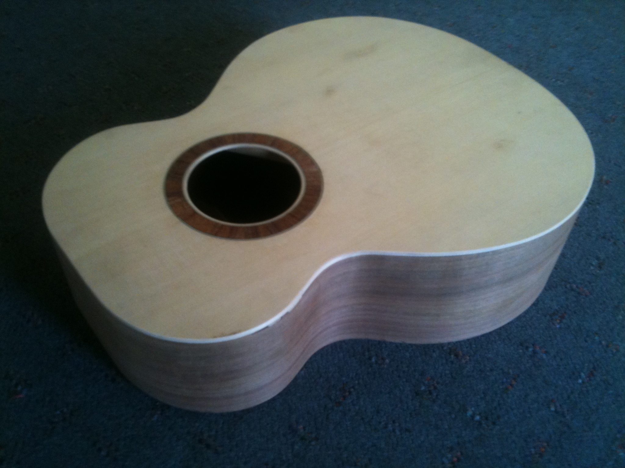

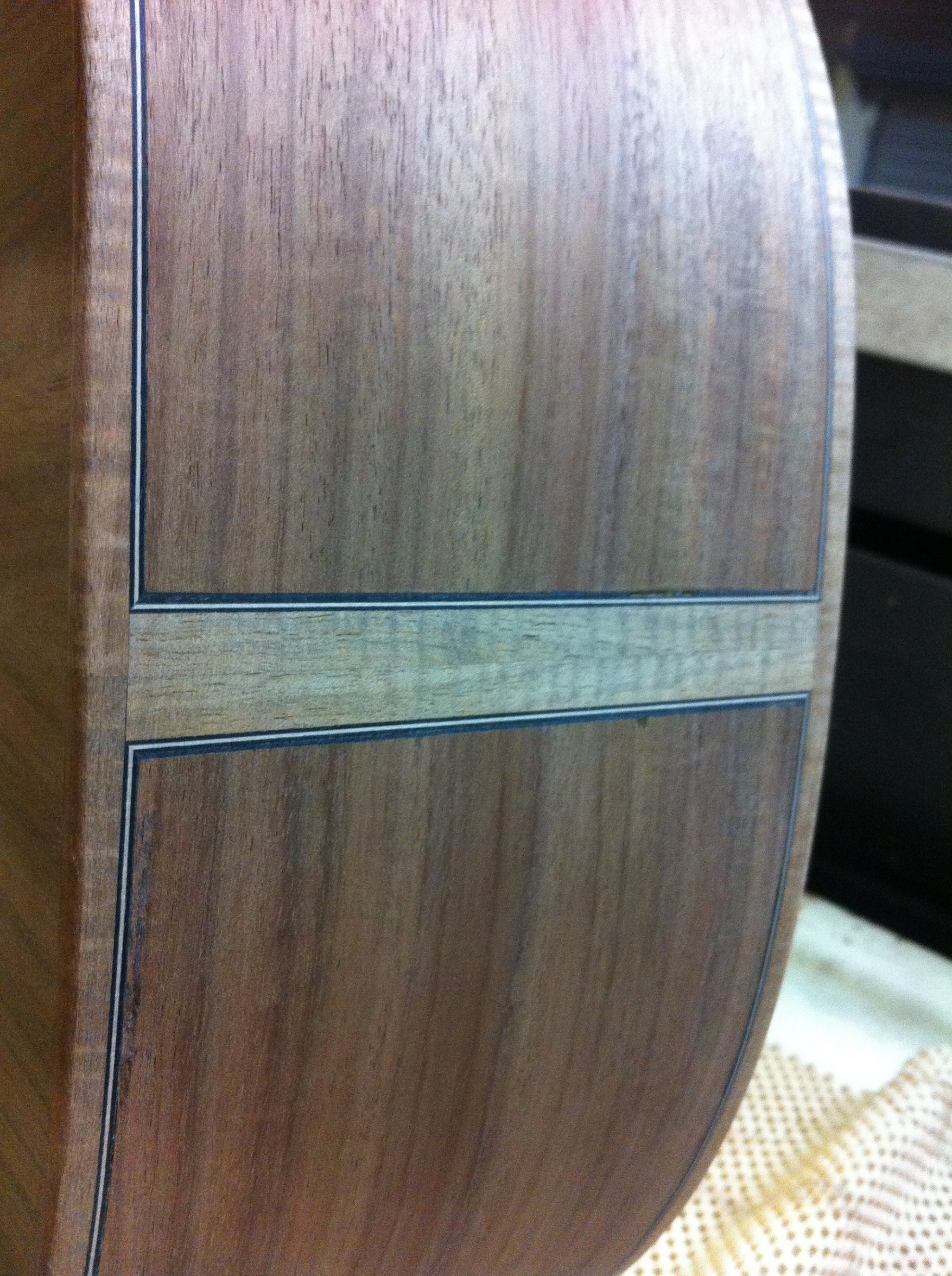

Post by soulman » Sat Nov 02, 2013 11:36 pm

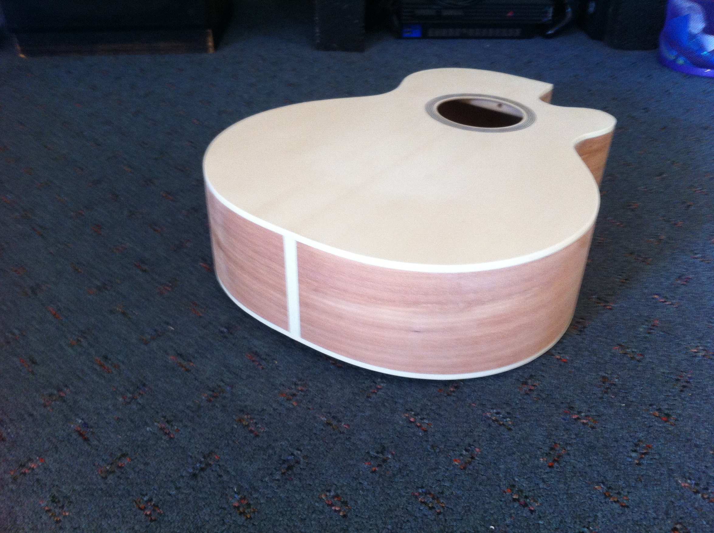

Top is now on the blackwood body.

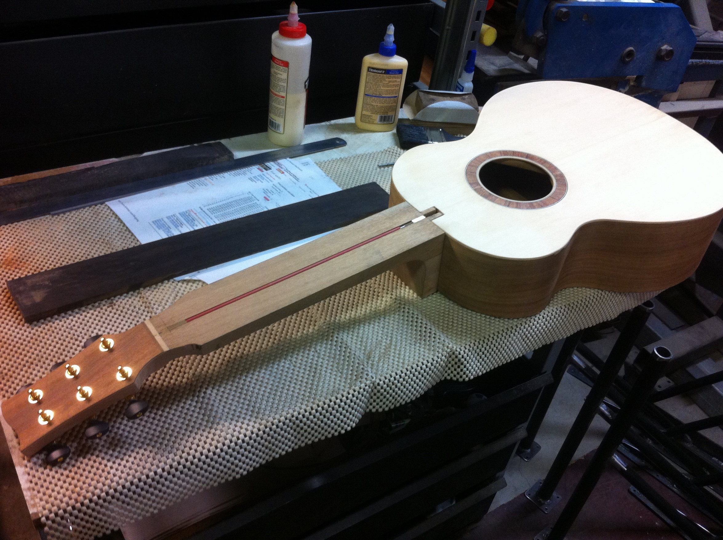

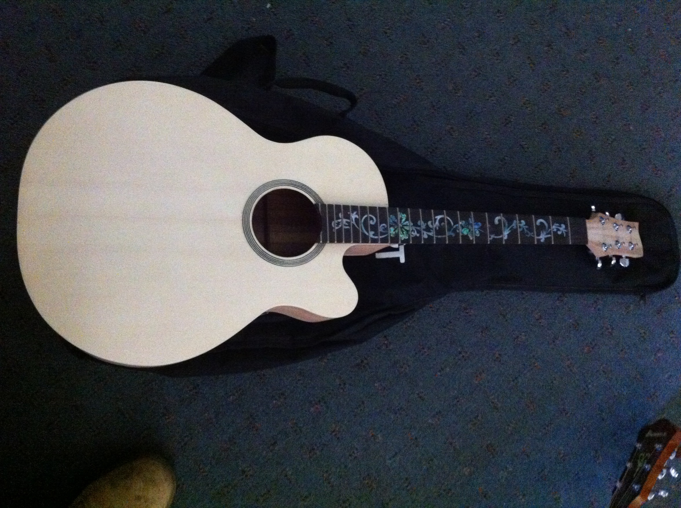

Here is an udate of the maple one.

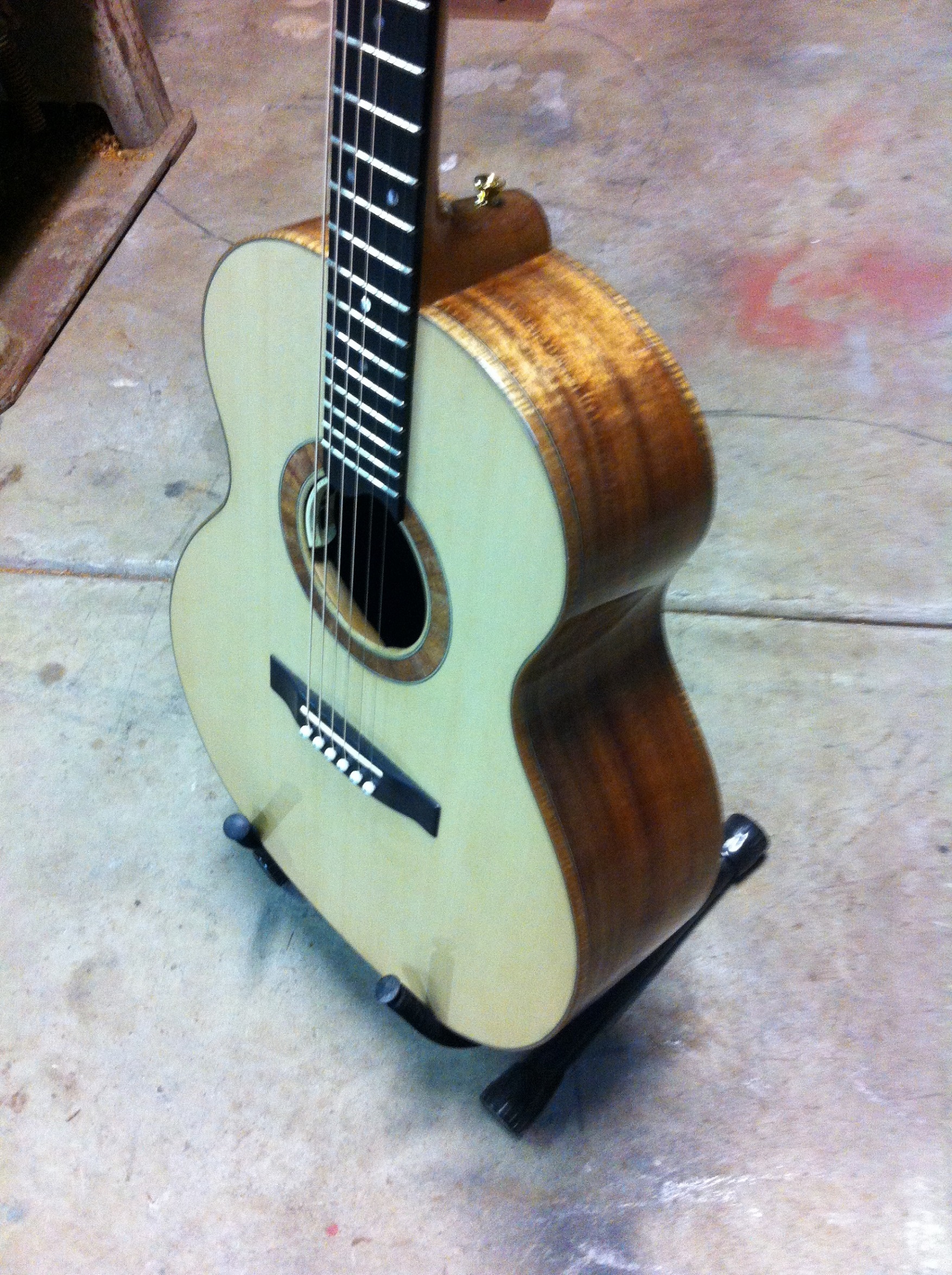

Post by soulman » Mon Feb 10, 2014 12:53 pm

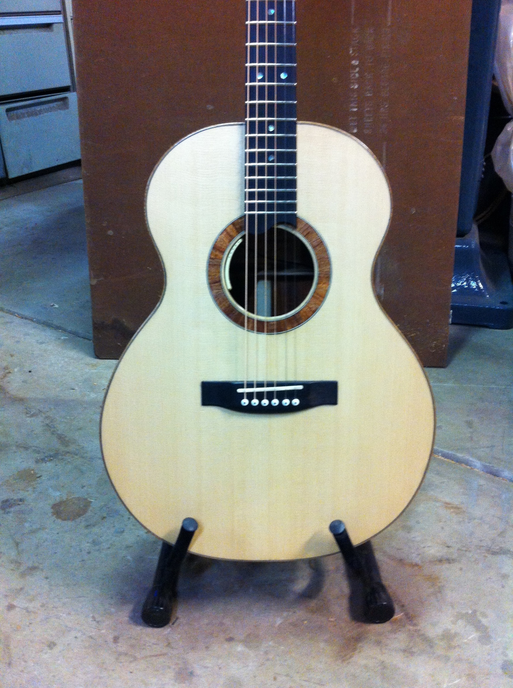

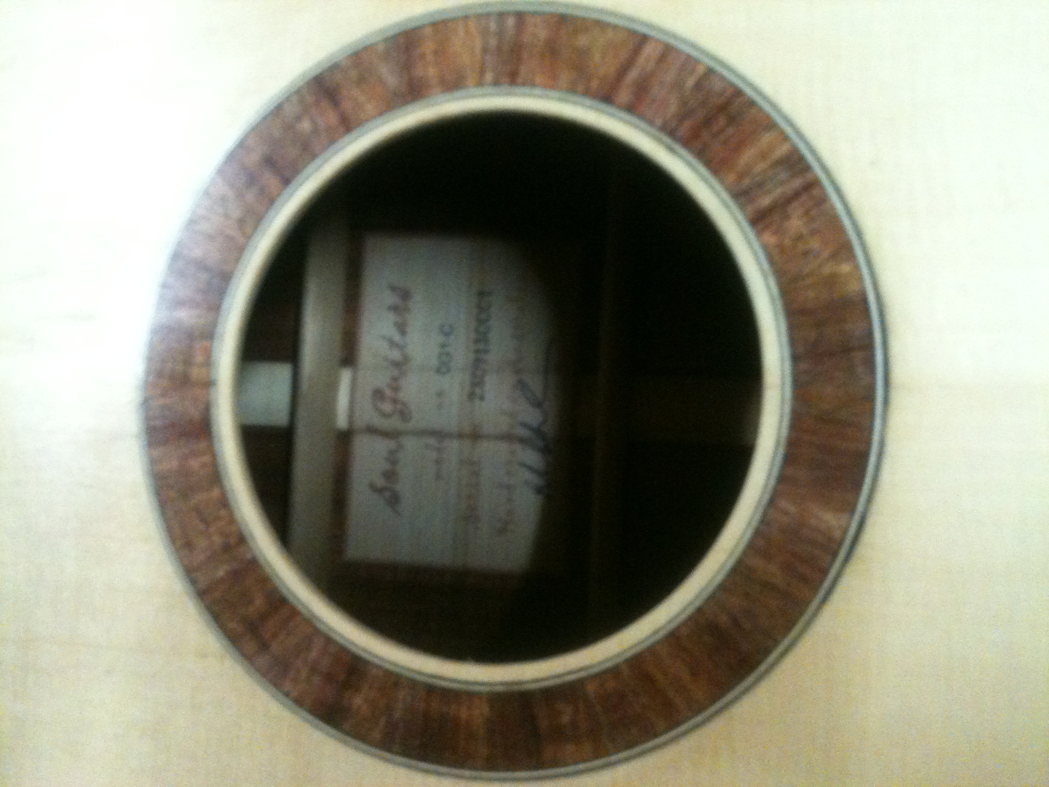

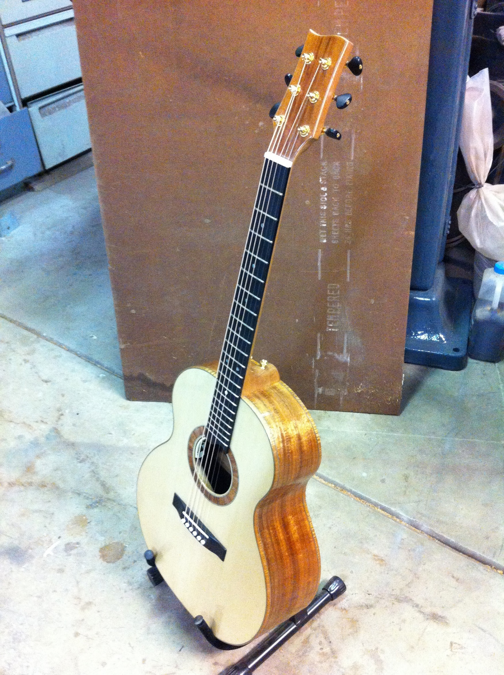

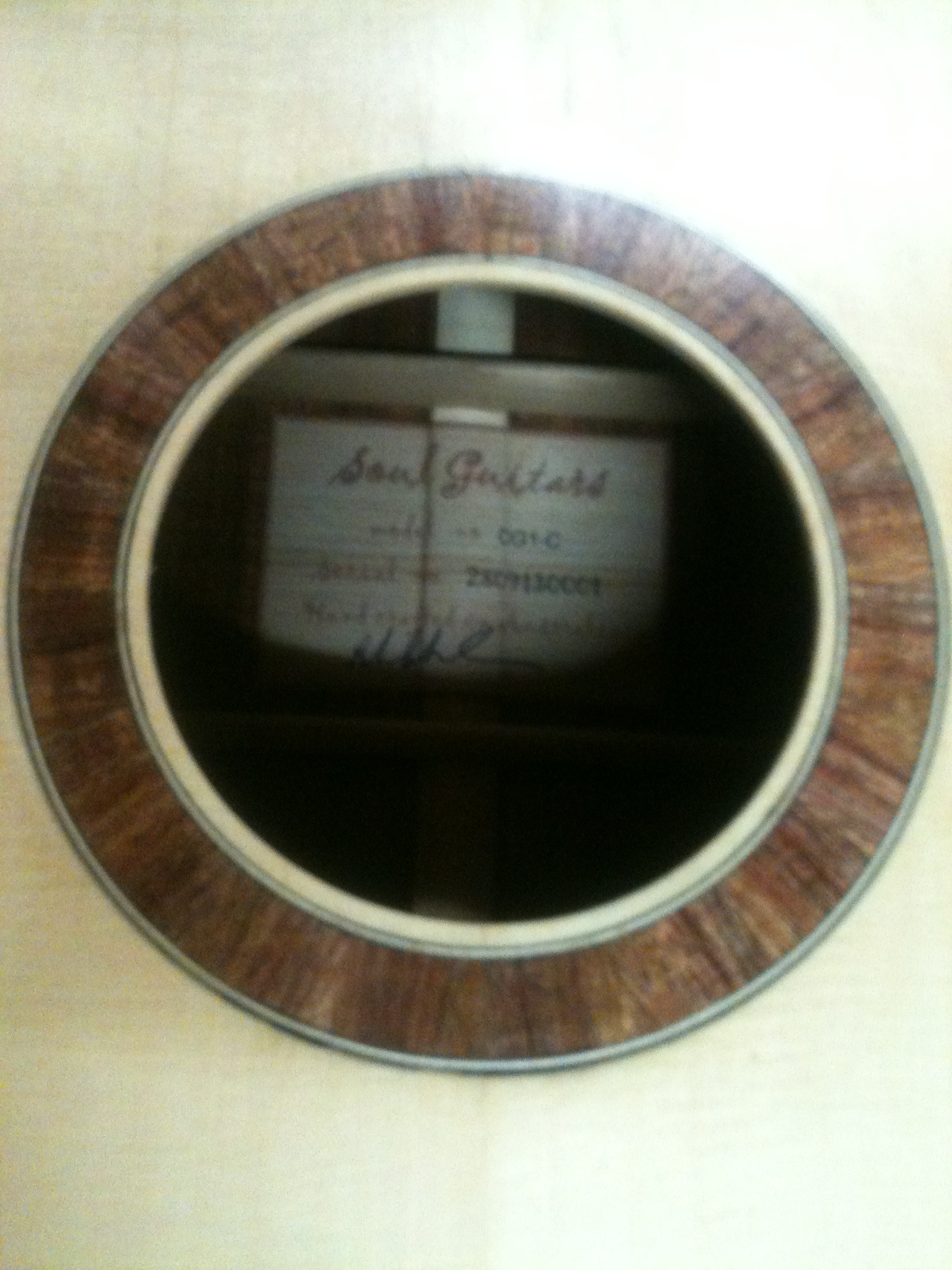

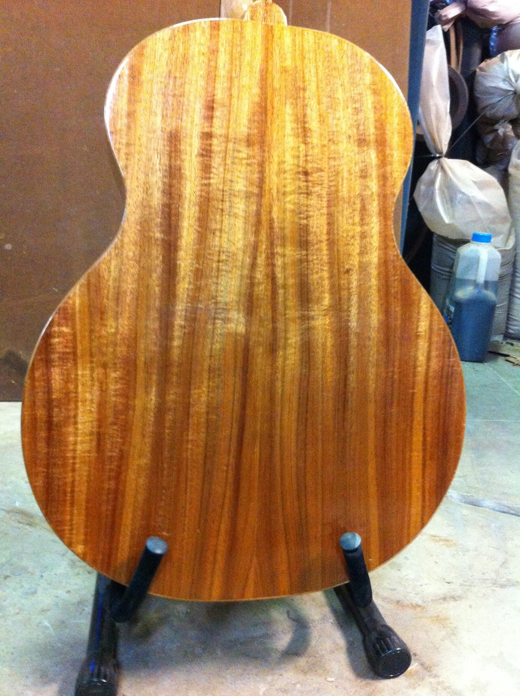

This is the blackwood one. it is now complete. Got to perform with this in Tamworth. It sounds much better than I could've dreamed of. I'm blown away. I have put the LR Baggs Anthem pickup in it. Love it.
