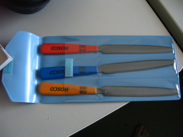

Allan was kind enough to send me down his set of nut files to try.
I did a nut for a new guitar today and I must say these files crap all over the Stewmac ones we've been using.
They are Japanese Hosco files (same as Dave White uses)
They cut quicker, the curve in the file lessens the tendency to have the end of the file heading perilously toward the finished headstock, and they don't catch like the Stewmac ones do.
The g-string slot profile is heaps better as well - no catching of the string at all.
Big thanks to Allen for his generosity and we'll be getting a set of these in the very near future.

I have a set of these also. I got mine from Gerard Gilet ,and I think he may still stock them. From memory , they weren't cheap.
Cheers , Craig
Post by Allen » Tue Mar 25, 2008 9:55 pm
I think that I got mine from Gilet Guitars. And yes, he still has them . Australian Luthier Supplies carries something that looks very similar on sale. I'd drop them a note and see if they are the same.
Post by Bob Connor » Tue Mar 25, 2008 10:28 pm
Gilet has them for $104 and Aust Luthiers Supplies $75.92.
They look like the same files.
I know it sounds expensive but if they do the job properly I don't mind forking out a bit extra.
We bought the entire set of the Stewmac ones which cost $155. :evil:
They'll come in handy for something I'm sure. But every nut we've done has had the string bind up on the G string and sometimes on the D.
Bob

Post by Bob Connor » Tue Mar 25, 2008 10:38 pm
I just ordered them from Aust Luthiers Supplies.
The $75.92 is without GST which I discovered on the last page of the Paypal form.
They ended up costing $97 delivered.
And yes they are still cheap at that price if they do the job Craig.
Bob
Post by Bob Connor » Fri Mar 28, 2008 9:08 am
They arrived this morning and they are indeed Hosco's.
Whoopee. No more sticky G-strings. :shock:
