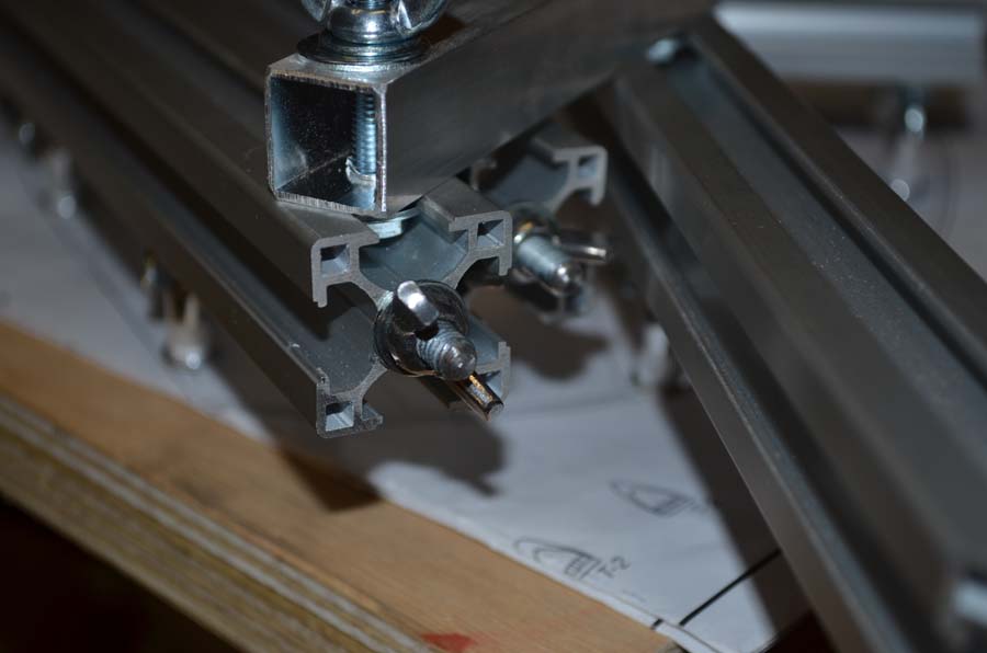

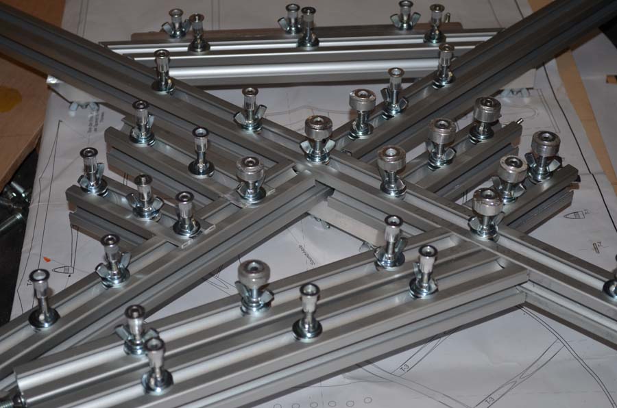

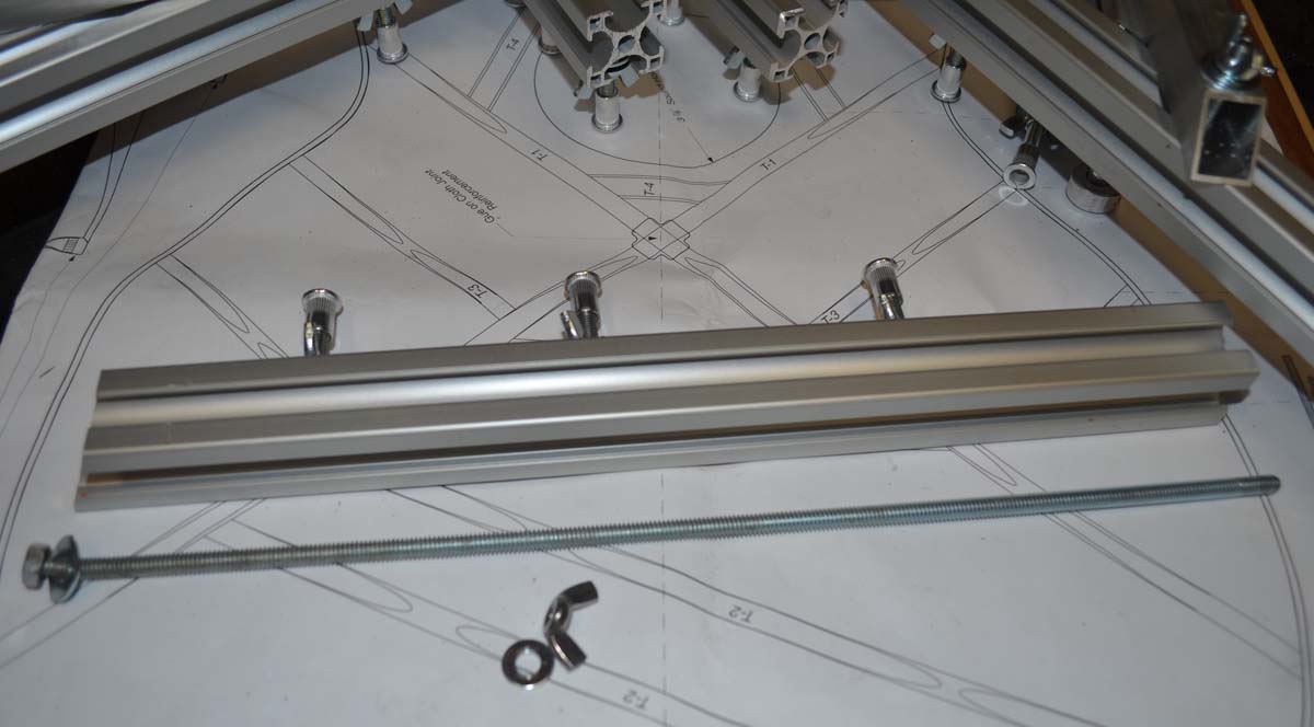

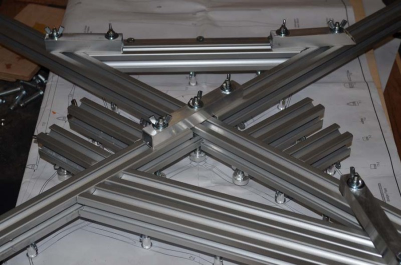

This particular bracing option would be used in conjunction with a poly carbonate template to correctly locate the braces. However there plenty of options if you want to vary the location of each brace. The x-brace point is adjustable and the each of the minor brace legs can be moved along the x-brace and angled as required. While I have abraded the minor brace leg ends (where it connects to the x-brace) to match a preferred angle , you could either make additional legs or wedge the leg to get the preferred angle. Not pictured in this post would be a board that would retain the aluminium extrusion and resist any vertical pressure as you rotated the feet on the threaded stems on the underside.

In actual use - do you make it all up according to the plan for braces, then try and get all of them in place in one go before clamping it down ? Or can you slot in a piece at a time?
My first thought was you'd need to work pretty fast to get things lined up, but those that use vacuum jigs must be in the same boat.

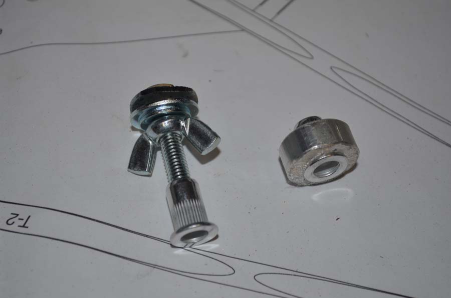

In operation the x-brace goes down first , then the assembly goes over the top. As the feet (nutserts) are elevated, you can then place each minor brace into position then wind down the foot. The only urgency is clamping the x-brace. Cost wise the System 30 T-Slot extrusions was about $90 and the nuts/bolts were about $50. Extrusions of this type in Australia are about $35 per metre and $10 in the US. With USPS shipping via a friend you could probably get it for $17 - $20 but it is inly a small quantity anyway. I could have use t-slot bolts but they are quite expensive at about $2 per piece. I would suggest that a slimmer extrusion might be more appropriate for the minor braces in terms of access, but the jigs seems to work fine.
