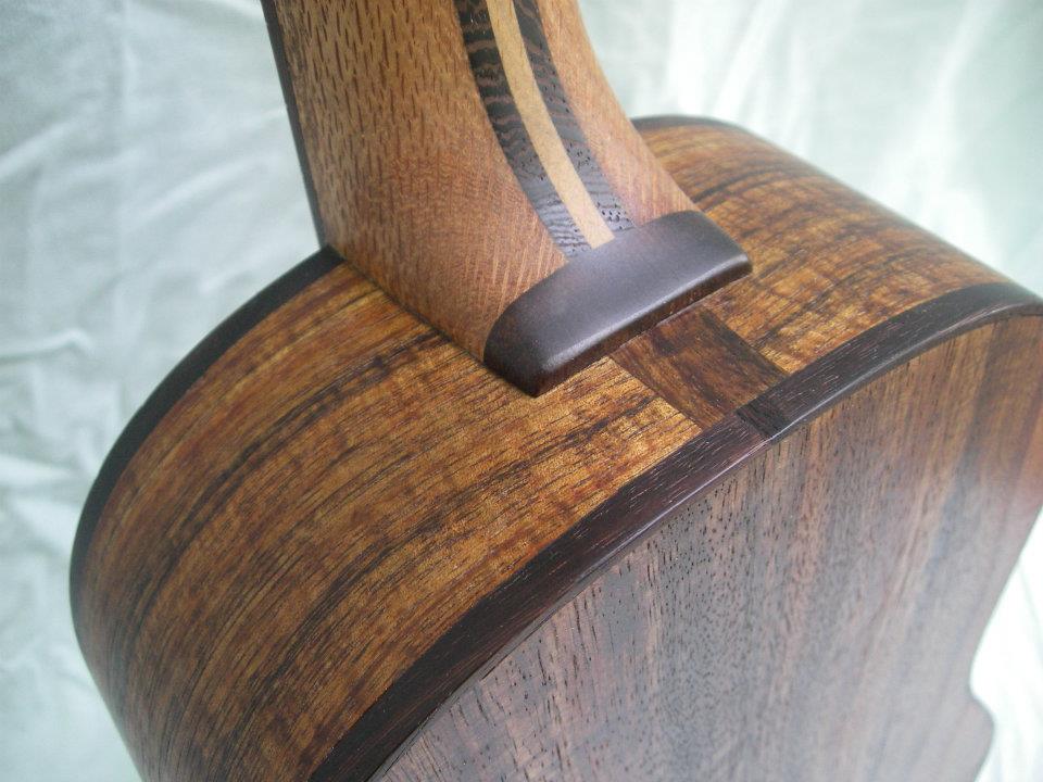

And one more Jim... !
Randomly came across this one today that 'looks' much more like yours, but I doubt it is attached in the same fashion. Possibly just a set neck but don't know for sure... A Matti Custom Ukulele - made in Qld? Had not heard of them until today.
More proof that they are "out there"...

Cheers Jeremy, more food for thought in that one. A few more millimeters longer and it would be a heel.
