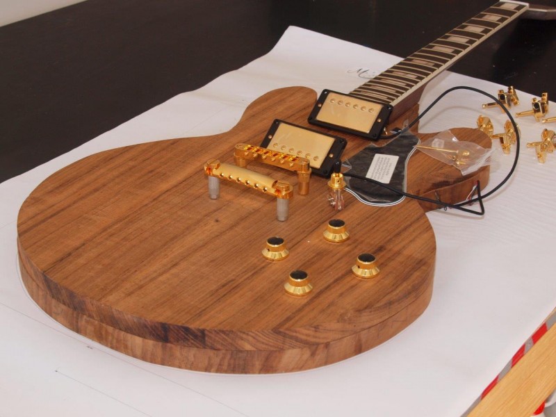

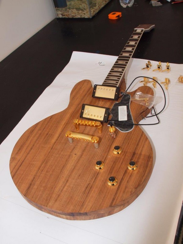

Now settled in Canberra for a while and about to get stuck into and complete my first build. I'm basing the technique on that used by Chris Greed in the UK for his CS-336. http://greedguitars.blogspot.com.au/2007/10/2-plan.html

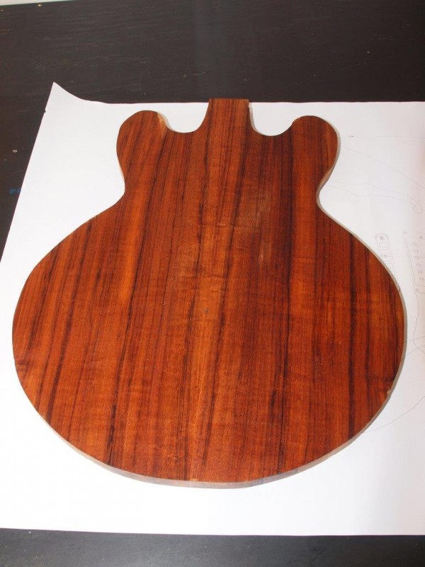

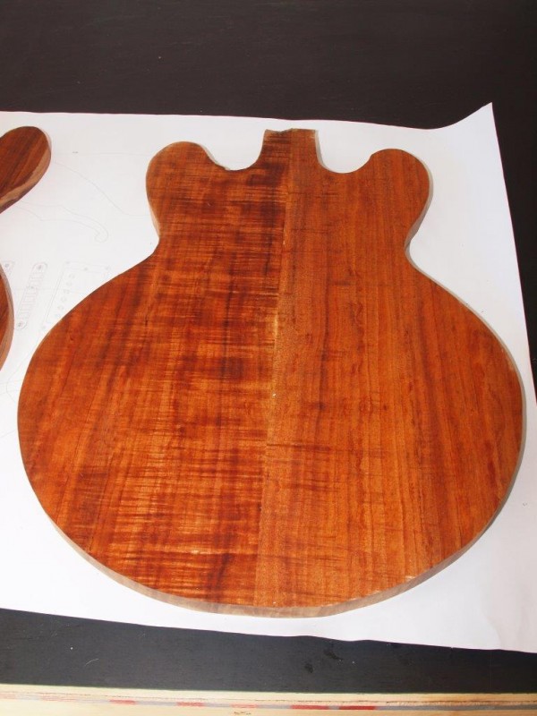

I've had the timber for quite a while and completed the initial joining and shaping. The blanks (dampened down to seen grain and fiddleback:
Top
Back

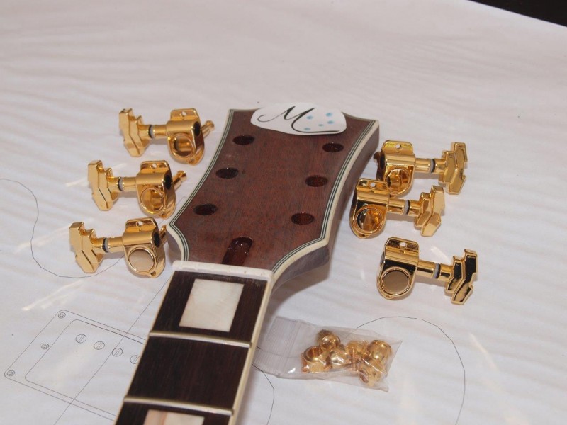

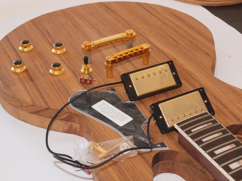

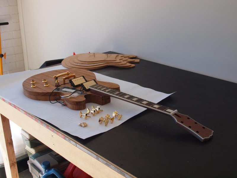

I have also purchased all my hardware (except pots):
Bolt-on neck (for 24.5" scale length)
Neck headstock
Headstock with Gotoh machines

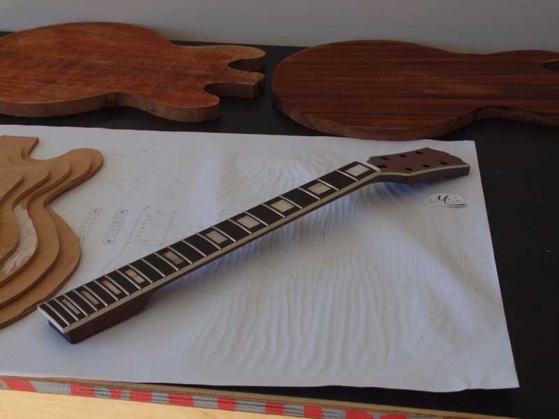

I still have a little work to do on my contour drawings. The basic contours are designed, I just need to map them to the scale profile and check the required neck angle. Plans so far:
Es-335 v5.pdf
Scale plans. Drawn in Visio.
(681.7 KiB) Downloaded 611 times
I plan to use push/pulls for the volume pots if I can get them in and use the following wiring:
2h2v2t3w2sp.pdf
2 humbucker, 2 volume, 2 tone, 3-way switch. Series/poarallel.
(587.49 KiB) Downloaded 694 times

The MOP piece for the logo arrived, along with the "bling" for the Southern Cross (see plans).
I've spent this week reworking the plans, especially the contour plan for the body carving.
I also drew a mockup of the neck I purchased and added it to the side elevation view of the body to calculate neck angle. I paid special attention to the height of the nut and the bridge (screwed up a couple of winds to allow up and down adjustments on setup.
It turns out to be an exact 3 degrees.
Check out the updated plans.

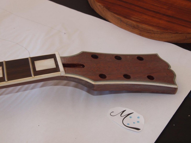

Post by GourmetSaint » Tue May 14, 2013 11:52 pm
Had a go at MOP inlay on the week. My design is too thin in parts and it snapped, ruining the piece.
Later found John Duff at LABEL EXTREME in VIC who is laser cutting the MOP to my design and installing in my neck
headstock for a very reasonable price. Love outsourcing to pros when required.
On a tight budget until our August US trip so no more purchases forcat while. Except maybe a collet for a router bit...

Got the neck back from John at Extreme Labels. Great work on the MOP inlay.
I added (loose) the rhinestones to preview the final look. It'll be fine sanded and shellacked first.

Post by DarwinStrings » Sun May 26, 2013 12:42 pm
I am curious about the cost of that "M" inlay Mark if you don't mind posting it?

DarwinStrings wrote:I am curious about the cost of that "M" inlay Mark if you don't mind posting it?
GourmetSaint
Posts: 15
Joined: Tue Apr 23, 2013 11:56 pm
Re: Build Log - Tassy Blackwood ES-335 Copy
Post by GourmetSaint » Sun May 26, 2013 11:30 pm
GourmetSaint
Posts: 15
Post by GourmetSaint » Sun May 26, 2013 11:33 pm
Under $40 for the shaped mop. Under $20 for the installation in the headstock.
Postage of the neck to and from John at cost from Auspost.
