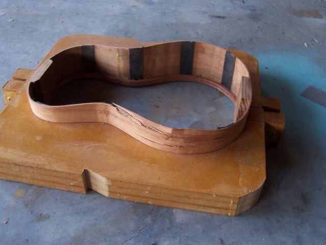

So not wanting to take over Alan's thred about his lovely uke,
here is a picture of mine after suffering a car accident (driven over by wife)
I am going to use this as an opportunity to practice my repair skills

Looks like youll need more than super glue to patch up that damage. I'd replace the whole side. But thats just one amateurs opinion.

I agree with replacing the side BUT....
The concept of this particular instrument is to do it as cheap as possible using leftover wood and I don't have a spare side plus i am intrigued to see what I can achieve with a repair.

Carefully push things back into place and fibreglass the inside with light chopped mat, when it goes off, CA the outside.

I think that this is going to be great practice. I say take the opportunity to hone your repair skills.
I absolutely destroyed a side by bending too aggressively and I used it as an opportunity to try repairing it and learn some things. I used HHG and small cauls with baking paper to stop gluing things that I didn't want to stick. I took it one small section at a time. The repair ended up taking about a week in total. Each day I'd glue and clamp up another small section. Mostly dry time for the glue to totally cure, but now that it is done, I simply can't see where the damage was. It gave me a lot more confidence in knowing that it has to get pretty bad before it can't be repaired. One never knows when you'll need that skill.

I seem to have a lot of nice timber that isn’t long enough or wide enough to use for sides. So I’ve often wondered if it would be possible to make two or three piece sides? The join could either run the full length or splice two shorter bits together along a diagonal. With this thought in mind for this repair, maybe cut away the worst of the damaged timber from the top of the waist to near the bottom of the tail block on both sides, you could be decretive about it and curve the cut so it flattens out at the tail block (kind of guitar shape) . Then find a bit of contrasting timber bend it up, trim it to fit and glue it in place. Turn the repair into a feature rather than trying to hide the damage.

I am currently thinking I will repair it as best I can, some of the cracks I am sure I can get an invisible repair and then in the centre where the fibres are too mashed I will greate some sort of decorative element. :D

And Back together again.
Area moistened with turps.

Brilliant Jeff. No tyre or skid marks showing either!!! :lol:
Post by Allen » Sat Mar 22, 2008 6:52 pm
That's looking great. A little more work and some purfs and you'll be hard pressed to spot it.
Post by jeffhigh » Sat Mar 22, 2008 8:23 pm
Yeah, it has come out better than I thought it would.
The camera flash actually makes the picture look worse than in person.
And the before picture was NOT how it looked initially, the whole corner above the mold was bent over horizontal with only the cloth tape holding it together
