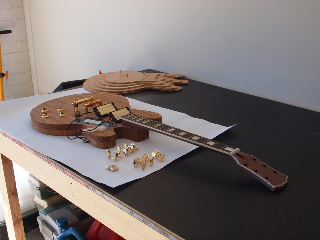

Now settled in Canberra for a while and about to get stuck into and complete my first build. I'm basing the technique on that used by Chris Greed in the UK for his CS-336. http://greedguitars.blogspot.com.au/2007/10/2-plan.html

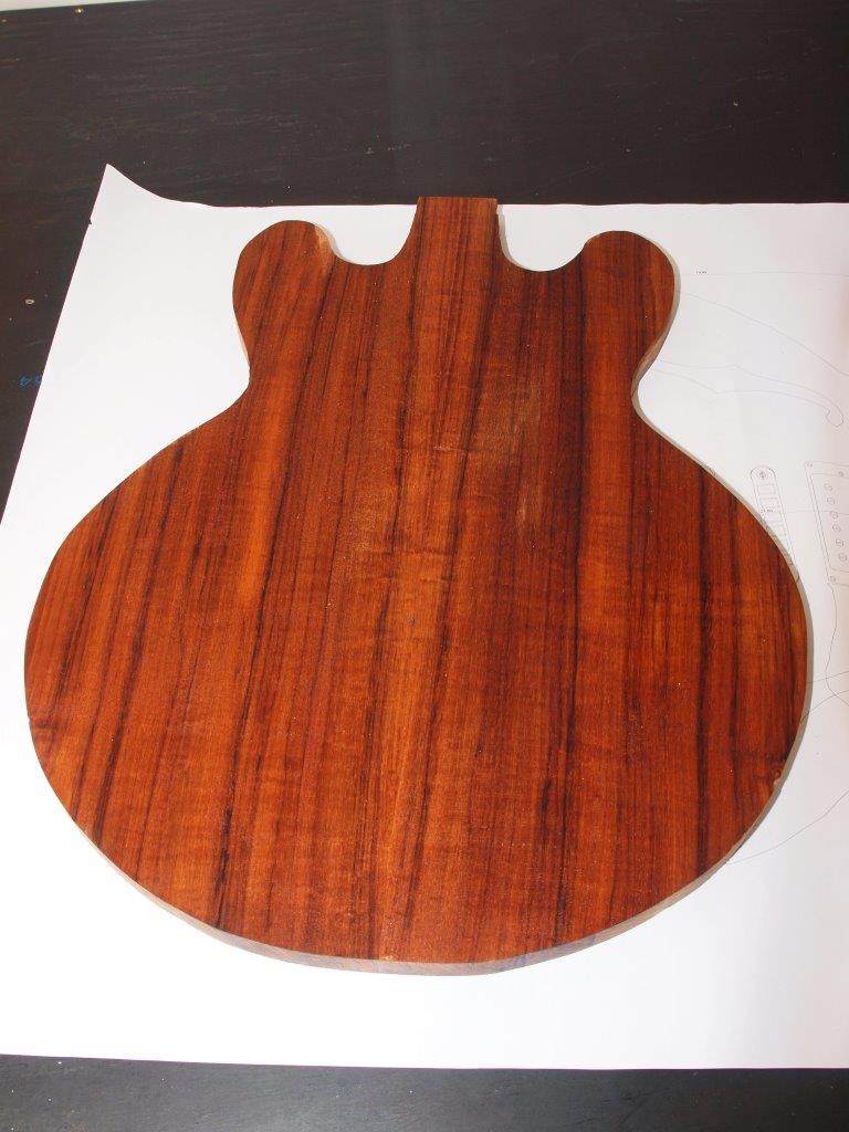

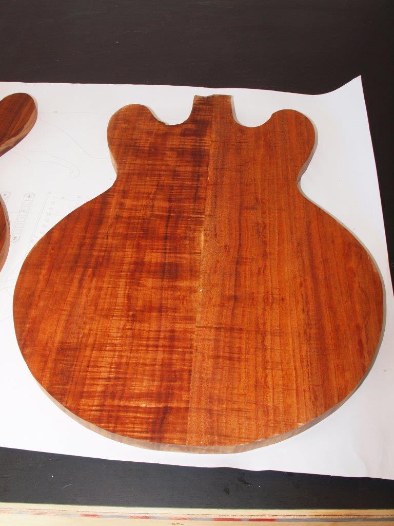

I've had the timber for quite a while and completed the initial joining and shaping. The blanks (dampened down to seen grain and fiddleback: I have also purchased all my hardware (except pots): I still have a little work to do on my contour drawings. The basic contours are designed, I just need to map them to the scale profile and check the required neck angle. Plans so far: I plan to use push/pulls for the volume pots if I can get them in and use the following wiring: Couple of opinions wanted:
1. The original ES-335 had the mounting block inside extend from top to bottom giving two separate "wing chambers". Later (and smaller) models had the block extending to just below the level of the stop-piece, thus connecting the chambers and increasing volume (and reducing weight). Should I stay true to model or go for the additional routing?
2. Many early players of ES-335s criticised the jack being on the front of the guitar. I have also seen posts of owners having problems with damaging the jack sockets and the timber around. Should I move the jack to the edge ala later ES and CS models and use a jackplate or again stay true to model?

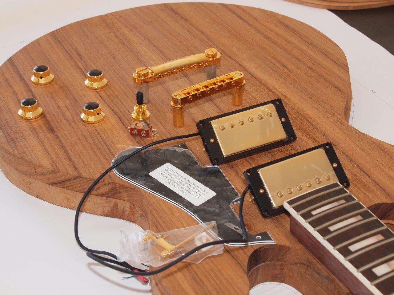

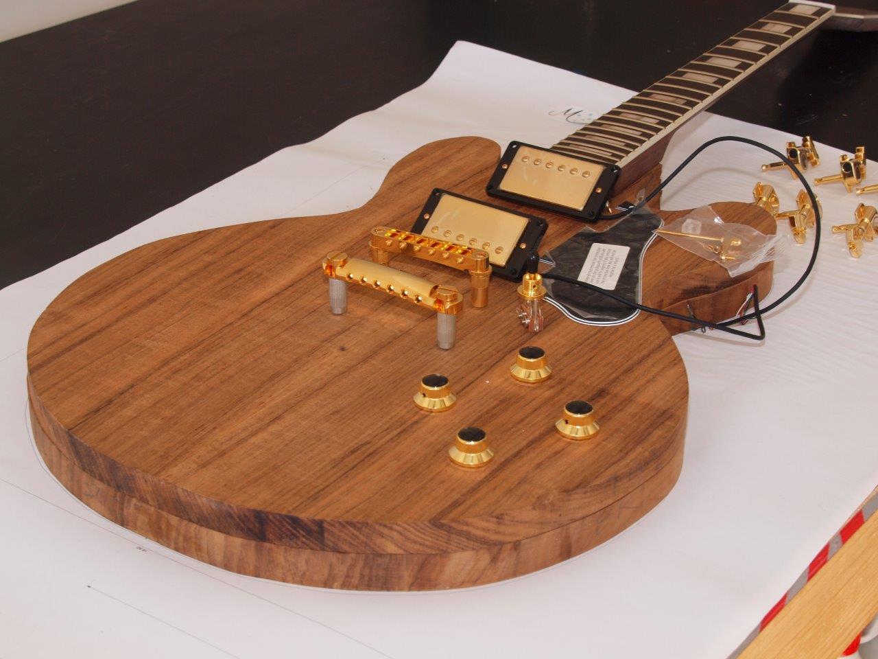

More on the build. I worked out that I won't have the room to install push-pull pots to give me the serial/parallel options. However, I've ordered the Seymour Duncan Triple Shot humbucker surrounds which have tiny dip switches in tbe surround giving quite a few sounds options with no real noticeable visual changes.
I would still appreciate some opinions regarding centre block and jack.

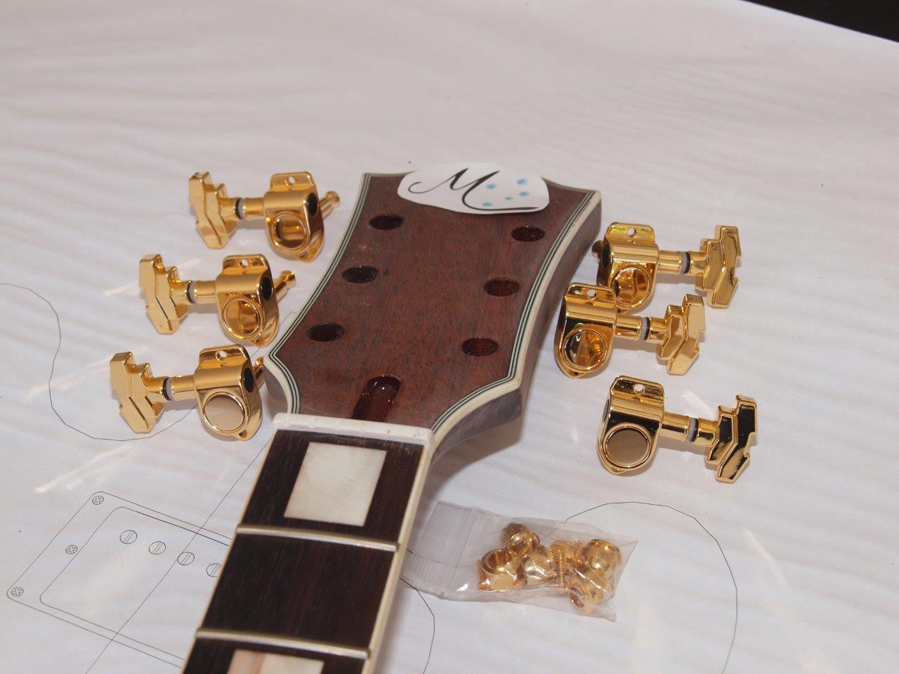

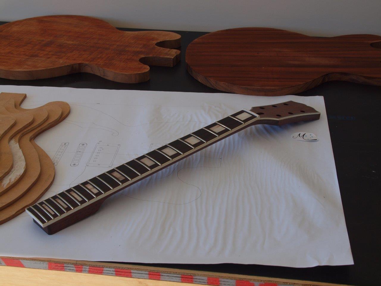

The MOP piece for the logo arrived, along with the "bling" for the Southern Cross (see plans).

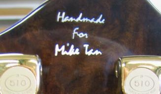

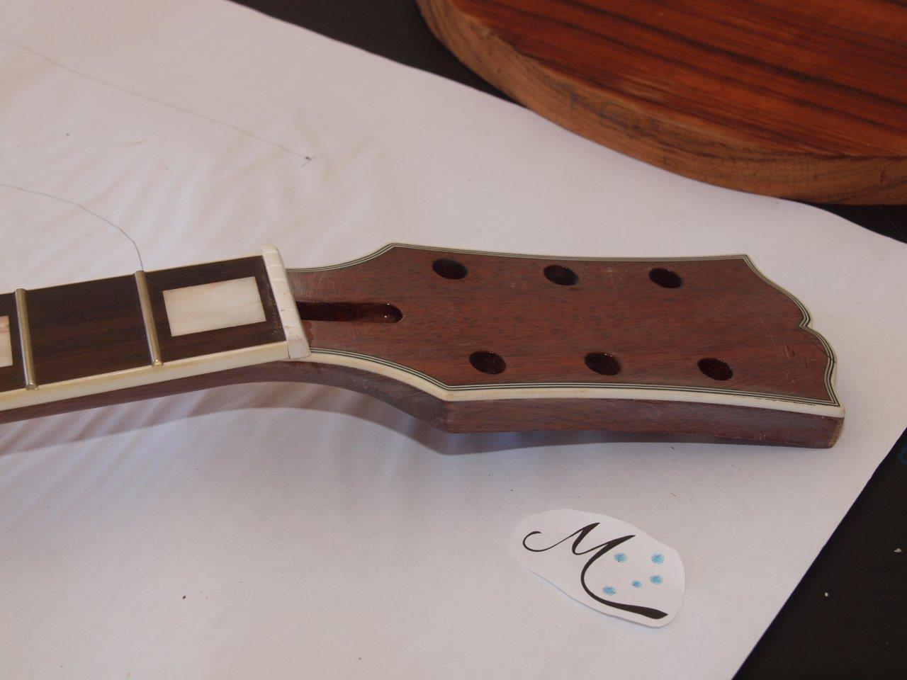

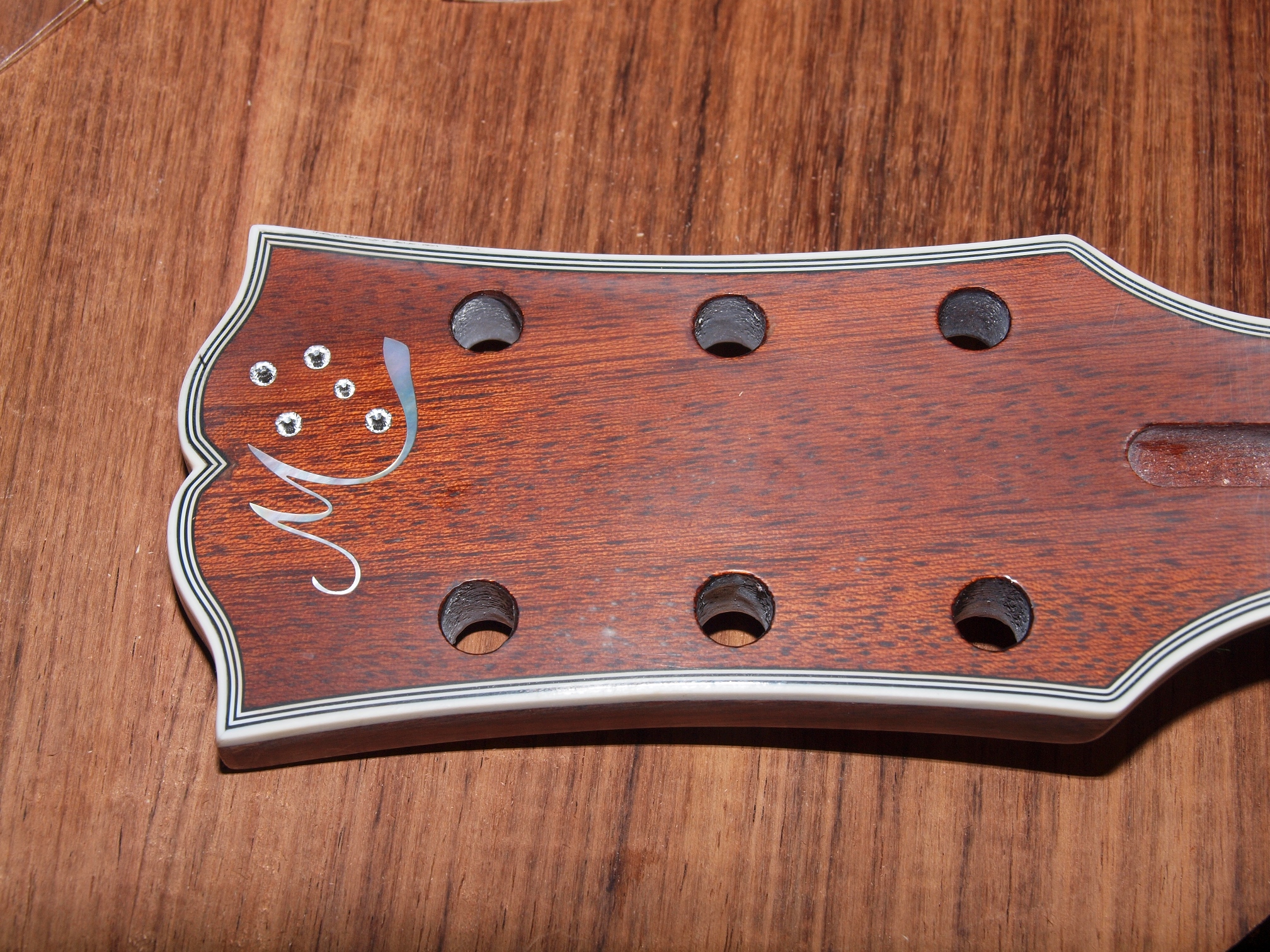

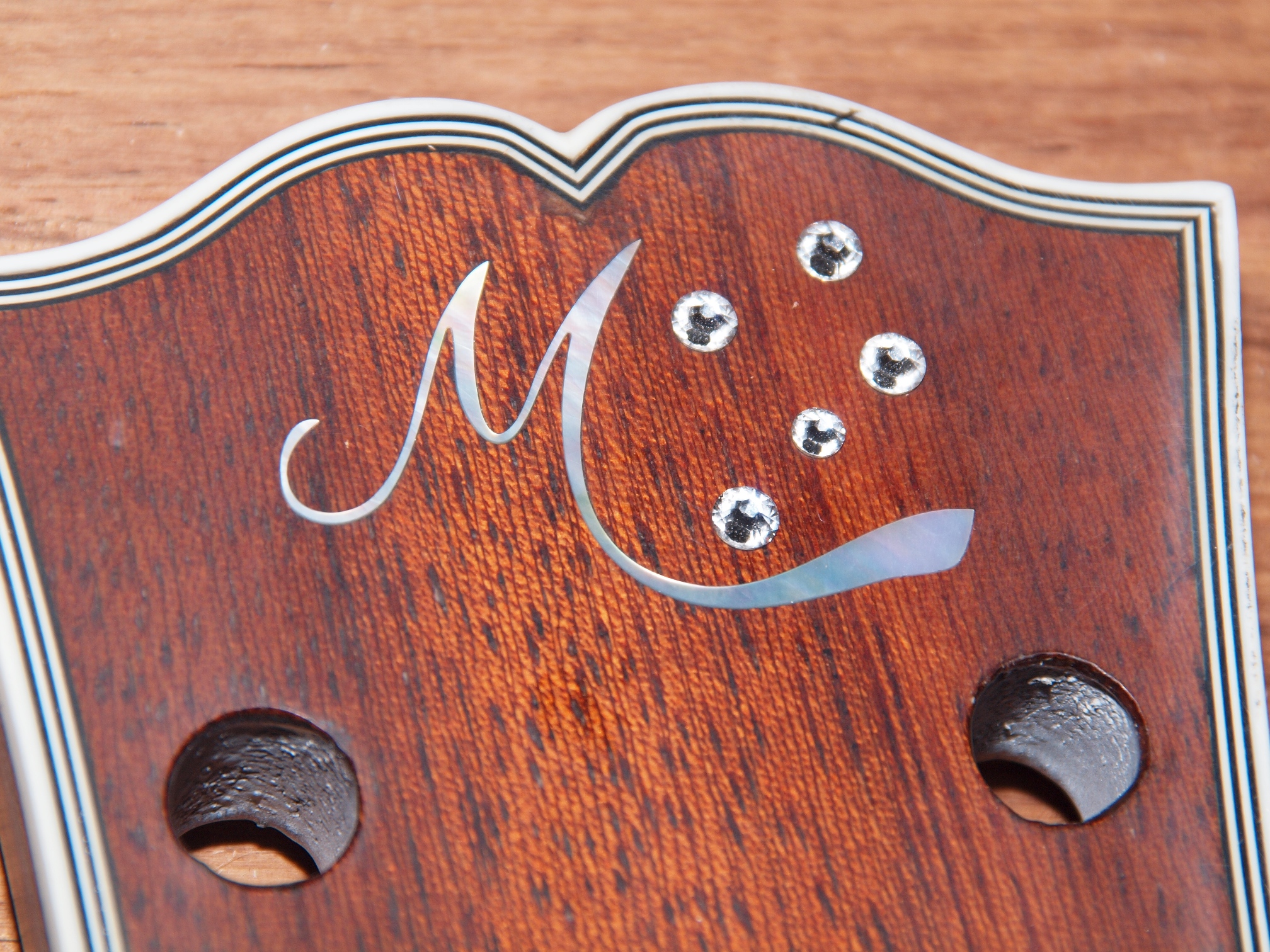

Had a go at MOP inlay on the week. My design is too thin in parts and it snapped, ruining the piece.
Later found John Duff at LABEL EXTREME in VIC who is laser cutting the MOP to my design and installing in my neck
headstock for a very reasonable price. Love outsourcing to pros when required.
On a tight budget until our August US trip so no more purchases forcat while. Except maybe a collet for a router bit...

Well done for having a go, it can be a daunting part of the exercise. I've found that the secret to not snapping thin sections is to keep the MOP hard down against the work board and make sure the blade is kept moving at a regular stroke (not too fast and not too slow) and also kept perpendicular to the work. As soon as you 'tilt' the blade it will bite into the shell and that's when snapping occurs.GourmetSaint wrote:Had a go at MOP inlay on the week. My design is too thin in parts and it snapped, ruining the piece.
Here's one I did on a guitar last year, the tuners give you some idea of the scale of it. If you can, keep practicing, because if you can get the hang of it it's one of the most rewarding parts of building a guitar, not to mention....cheaper

I added (loose) the rhinestones to preview the final look. It'll be fine sanded and shellacked first.

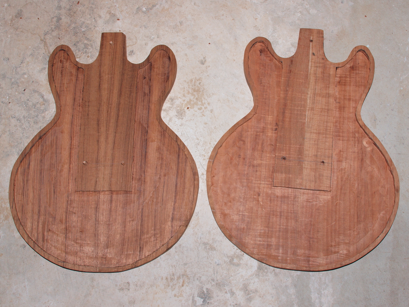

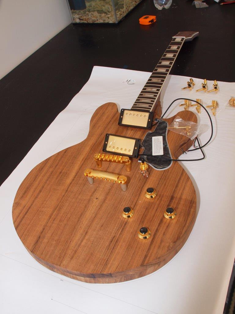

Did the rough routing on the inside yesterday. 5mm depth on the top and 100 on the back. I had no template for this so just a 'steady" hand. I'm not brilliant with the router but as this will all be hidden on the inside...
- DarwinStrings
- Posts: 1873
- Location: Darwin
Re: Build Log - Tassy Blackwood ES-335 Copy
I am curious about the cost of that "M" inlay Mark if you don't mind posting it?
That is a very professional result - you don't mind paying for something when it comes out as nice as that!
Col
DarwinStrings wrote:I am curious about the cost of that "M" inlay Mark if you don't mind posting it?
- GourmetSaint
- Wandoo
- Posts: 15
- Joined: Tue Apr 23, 2013 11:56 pm
- Location: Canberra
- GourmetSaint
- Wandoo
- Posts: 15
Under $40 for the shaped mop. Under $20 for the installation in the headstock.DarwinStrings wrote:I am curious about the cost of that "M" inlay Mark if you don't mind posting it?
Postage of the neck to and from John at cost from Auspost.
- DarwinStrings
- Posts: 1873
- Location: Darwin
Not bad, not bad, not bad, thanks Mark.
I would have guessed $100, that is inexpensive really.GourmetSaint wrote:Under $40 for the shaped mop. Under $20 for the installation in the headstock.DarwinStrings wrote:I am curious about the cost of that "M" inlay Mark if you don't mind posting it?
