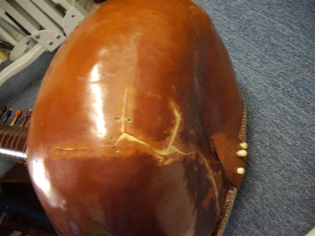

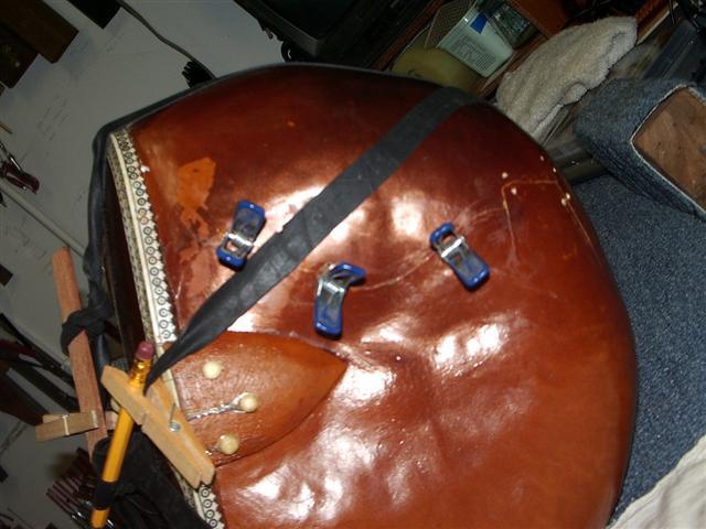

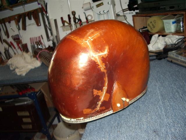

Some time ago I think there was a post about repairing an instrument that could not be accessed from the inside, I cant find it now, but here is my approach to a repair on an instrument that has no access to the inside.
I had this repair some years ago on a Sitar where the bowl back was badly cracked in transit; I think the pictures will tell the story. I can’t find any photos of the finished job, but the work was touched up with stain to hide the repair and varnished.
The rubber bands pulled the gourd back into shape; I then drilled holes at strategic points to take spring clamps that I had customized for the job, to pull the cracks together after the glue was applied. The holes were then filled with timber dowels and stained to match the rest of the body.

How do the points of such a customized spring clamp look like (side view)?Taffy Evans wrote:I then drilled holes at strategic points to take spring clamps that I had customized for the job, to pull the cracks together after the glue was applied.

Hi Markus, just reshape the ends of the clamps you have [normally flat/wide] to fit into the size hole you chose to drill which of course will be round.
Re: Sitar repair
Thanks Taffy. I have not been sure if you soldered something on them. It's good to know that reshaping will do the job.
