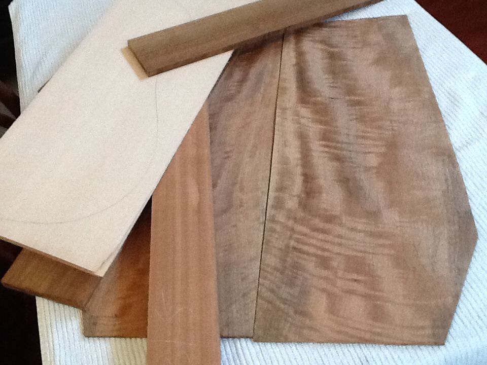

OK, so some friends have asked me to build a guitar for their son, Jack's, 18th birthday. You could knock me over with a feather. Gonna be done cheap for them, really just to cover costs and maybe sneak in a B/S set or two.
Jack came over yesterday and we went thru my little stash, and settled on mango (from bobthebuilder,maybe?), a AAA Sitka top from Brent Cole, Qld Maple neck from Tim, and have spoken to Graham at Loggerheads(first time, and nice to deal with) to get some ringed Mulga for the FB, bridge, linings and head plates......a picture of what I have on hand. It's pictured dry, and I think it'll really pop under lacquer.....
