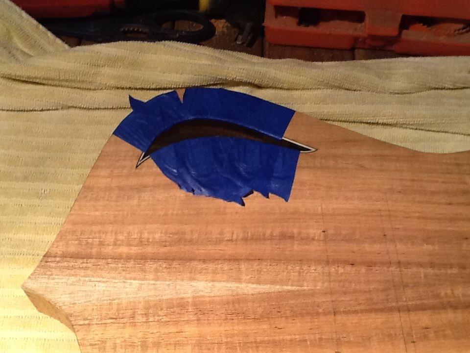

However, after much time, effort, dilligence and patient mangling, deforming and otherwise destroying the better part of 36 inches of otherwise offence-less BWB purfs in order to bind a simple F-HOLE, I have discovered that the real meaning of the term is linguistically dervied, in that there was a profusion of the use of the F-WORD during this rather unseemly process.
I tip my hat to those of you who pursue and excel at this process, however, I feel and am unanimous in this, that any and all future Holy Guitars that mayor may not be produced by me will feature an UNBOUND F'N-HOLE, which will be described as an acoustically superior method to create a guitar that will rock the ages......
My poor effort, without any refinement, tho I do have some textas to fix it up later....currently and justifiably swathed in the tape, which replicated the bandages that would have been applied to a human being in similar straits.....

Cheers, Nick....
I undid the bandages this morning, and it actually looks better than I thought it might, or had any right to expect. Enough so, that I'm in the process of binding the access panel on the back....
At least that's the plan....we'll see. I do have one tiny gap, that I ought to be able to fill.....

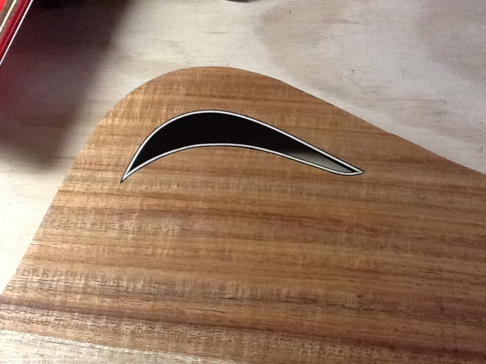

Rod, my work and yours are two completely unrelated prospects. Here's mine.
You can see a gap or two, even with the simpler shape, but it'll work out well enough. Timber purfs, too....I've got some plastic, but can hardly keep a hold of it, much less do anything with it.....I'll keep trying until i get better. There is, after all, a first time for everything..I wish I was half the man my dog thinks I am....

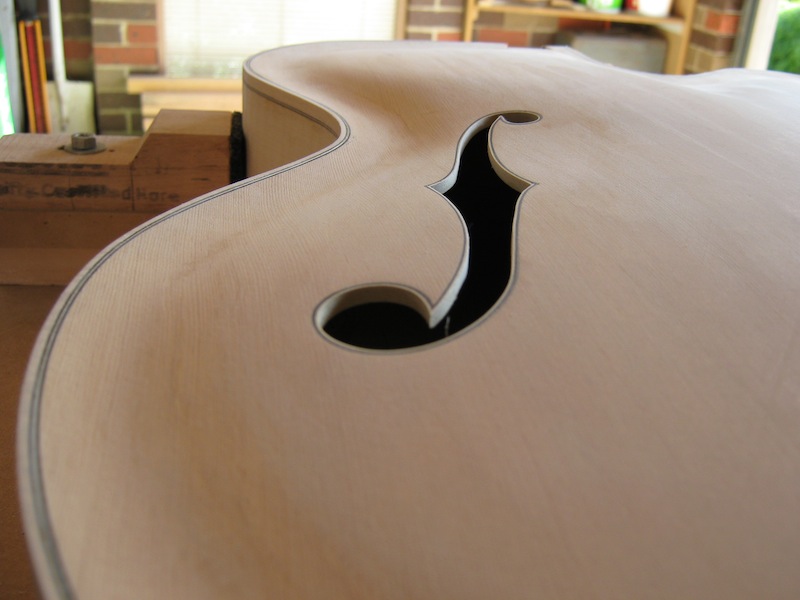

After 35 years of doing tricky bits of woodwork, binding ff's on my first archie was one of the trickiest. After a few false starts using commercial BWB, I made up my own. It takes 4 pieces to do a trad ff, I made up 4 outside moulds and laminated. Quick and easy, still had to mitre with a chisel though.
