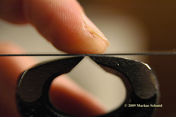

I use a dedicated soldering iron with a tip I filed a grove in. This not only saves nerves for sitting steady on the fret, but also provides a more efficient heat transfer.
The nippers I use are common, cheap ones, with a modified, ground edge:
Re: Removing frets from an ebony fingerboard
Post by ozziebluesman » Wed Mar 27, 2013 10:07 pm
A picture paints a thousand words.
Thank you Markus.
