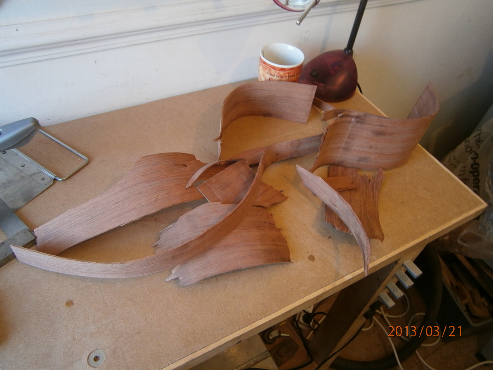

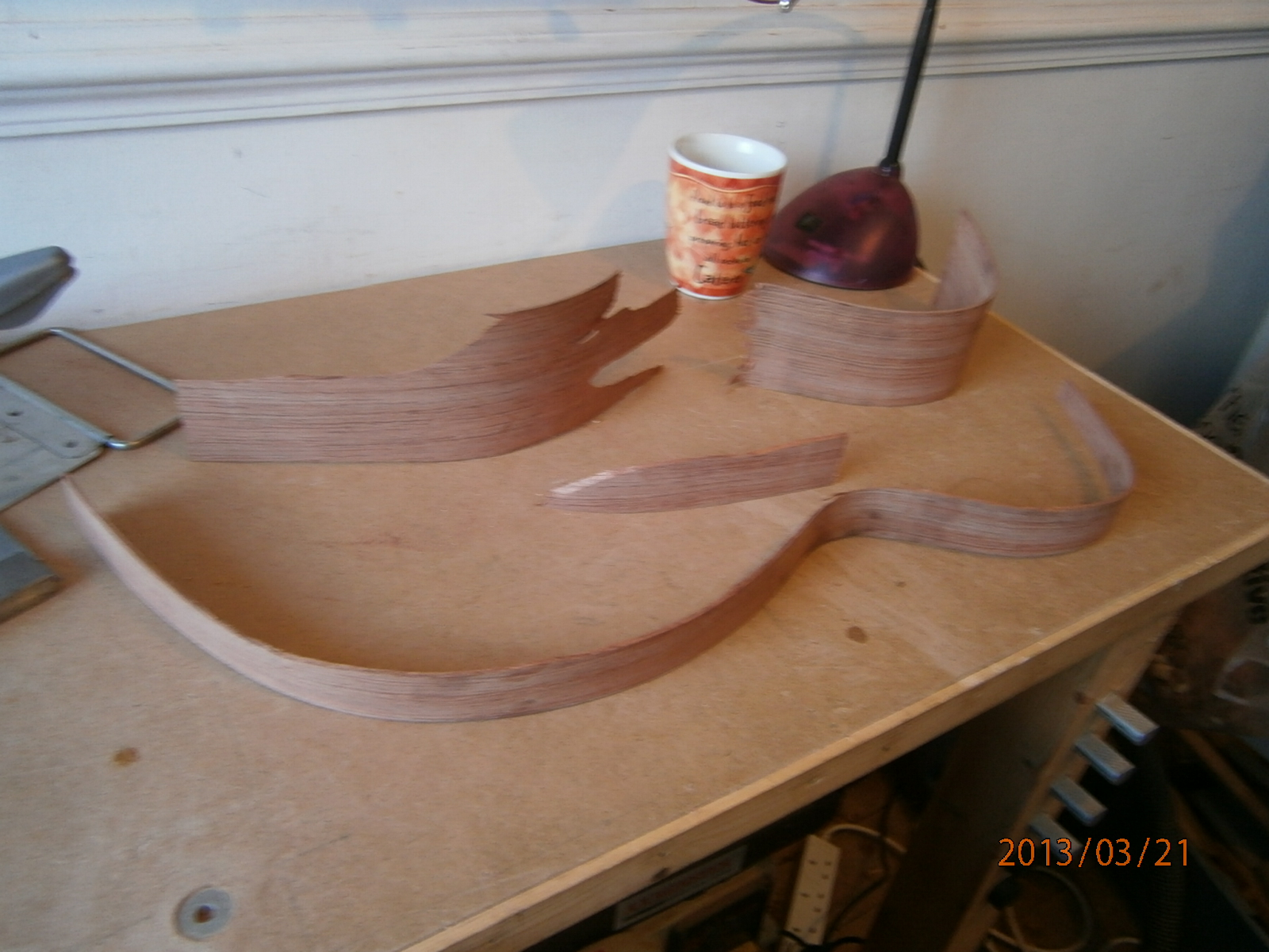

After trying for almost a week to stop my bubinga ribs from warping and faceting i just gave up and fueled the fire... :evil:
going...
going...
Gone...

Hi Nick i used a ibex bending iron, i bent the first rib slightly damp and in places it just rippled and bowed, the second rib i bent dry with the same effect, the wood bent fairly easy it just didnt want to stay straight, i have scratched my head all week and the only thing i can think of is that the wood may not be properly seasoned, i was told by the supplier it was 4 years dry and ive had it a year and a half, coming to think of it the back was a nightmare too, it joined okay but started to buckle when it was thicknessed, i read somewhere that bubinga can be a hit or a miss when it comes to being worked, i think i got the tough stuff lol..

The wood bent well and did stay in shape, in fact nearly zero spring back, the grain wasnt figured either, i cant explain it really just a weird bloody wood lol, the ribs where thicknessed to around 2.2mm... I think i will stick to Indian rosewood... :)

Cheers Nick but i couldnt burn it, im Scottish and to tight to burn it haha, im actually ordering another set of bubinga from a company in Spain called Madinter, it is cheap as chips at only £19.00 per set, i have my mind set on trying this stuff again to see the diference, i will keep you all posted on how this stuff works out... Oh and i nearly forgot that i examined the broken bubinga sides and in parts it looked like the ribs where 2 laminated peices joined together which where coming apart in parts ...very strange i have never seen this before, funny old stuff wood :?
