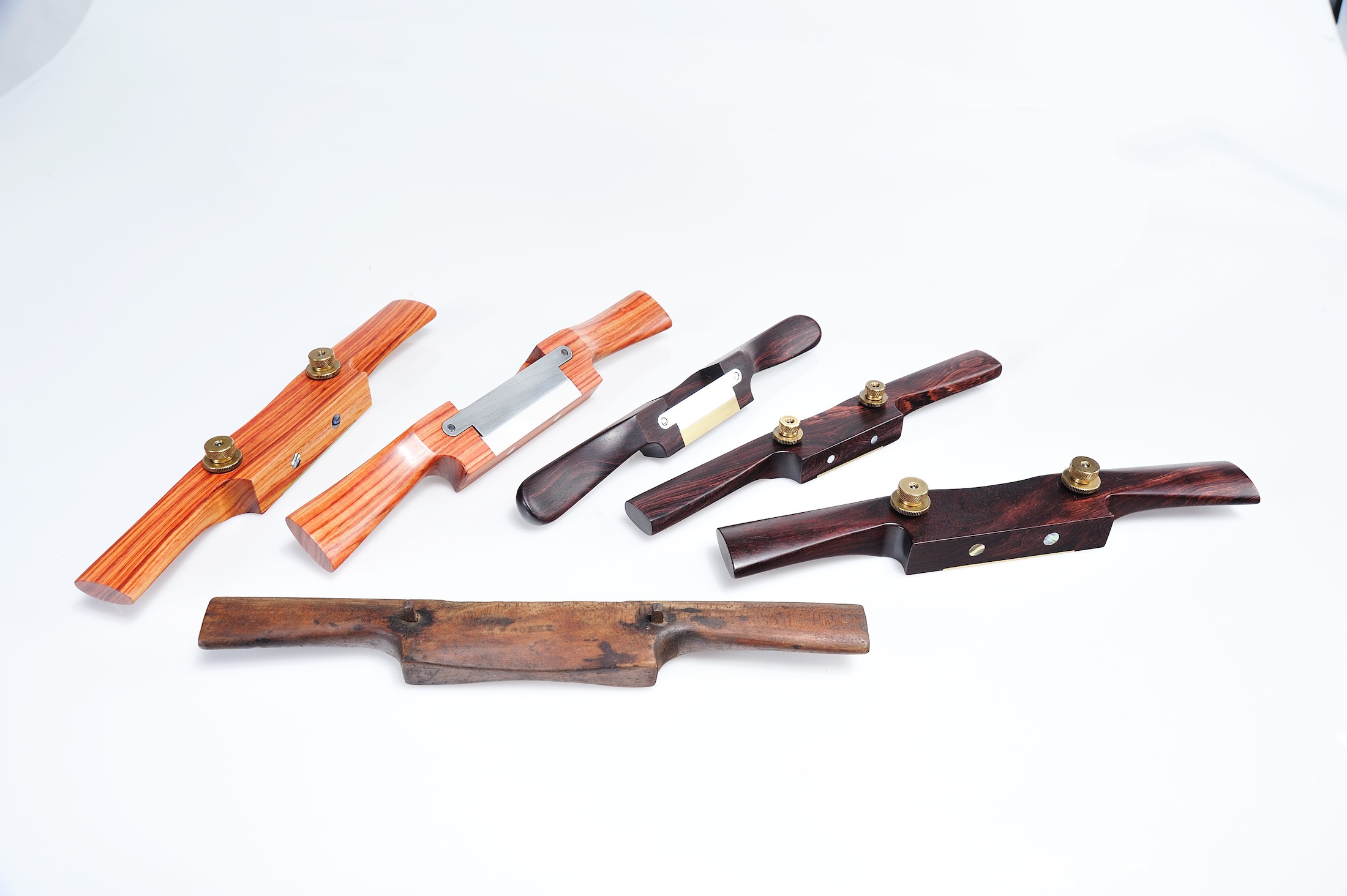

I don't have Lie Nielsen planes or catalogue so can't comment on them. I do have a number of planes, collected over many years including #4 Stanley smoothing, #5 1/2 Stanley Jack, #7 Record Jointing and various little planes of all shapes and sizes. One of my standout favourites is Veritas low angle Block plane which I purchased last year.
And, of course, you may also benefit from getting a spokeshave. Again, I favour my recently acquired Veritas low angle.
