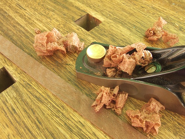

You will all have seen pictures something like this - continuous fine shavings from a piece of curly wood, in this case Jarrah.
Veritas Hi Angle.jpg (128.96 KiB) Viewed 8881 times
So what's different?
Well, it's what this blade went through before I got to this.

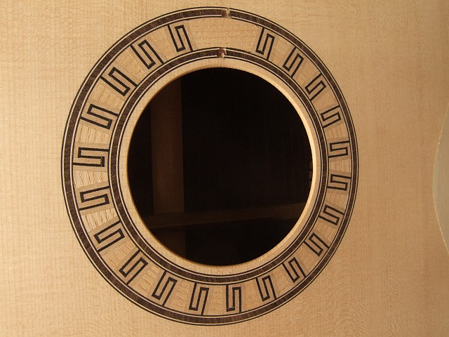

First, I sharpened it and used it to level a rosette; a combination of face and end grain:
Then, a few days later, I used it to straighten out the edges of some bandsawn Perspex, then to do a similar job on some bandsawn polycarbonate (jigs) and THEN I needed to take a few thou off a 500mm length of aluminium, so I used it for that, too. It planed it rather well and left a smooth, shiny finish. And then I did the curly Jarrah, a few days after that. No resharpening over any of those jobs.
How cool is that?
The plane is a standard angle Veritas bock plane with the standard blade sharpened at a 40 degree bevel to give a 60 degree cutting angle.
