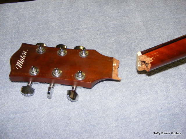

This is the third broken neck job I have had to repair this week. Some guitarists must have partied hard over Christmas.

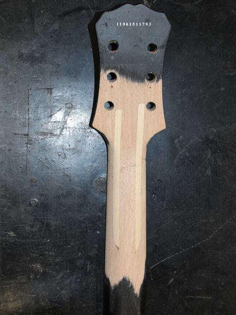

Your going to need splines in that one, similiar to this one, I grabbed the pic of one of my tutorial pages
sanded spline version 2.JPG (40.9 KiB) Viewed 7009 times

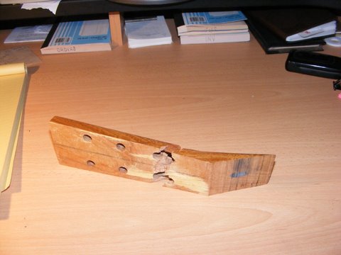

I thought that there would not be enough gluing area for a strong enough joint even with the cleats, so I planned to go down the, splice the old peghead back on or a new peghead spliced onto the neck, path, I've done it both ways in the past.
A bit like this.....
