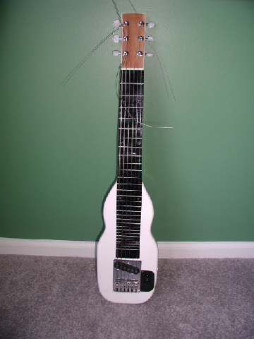

So, this one is an entry in someone's $30 and under contest.

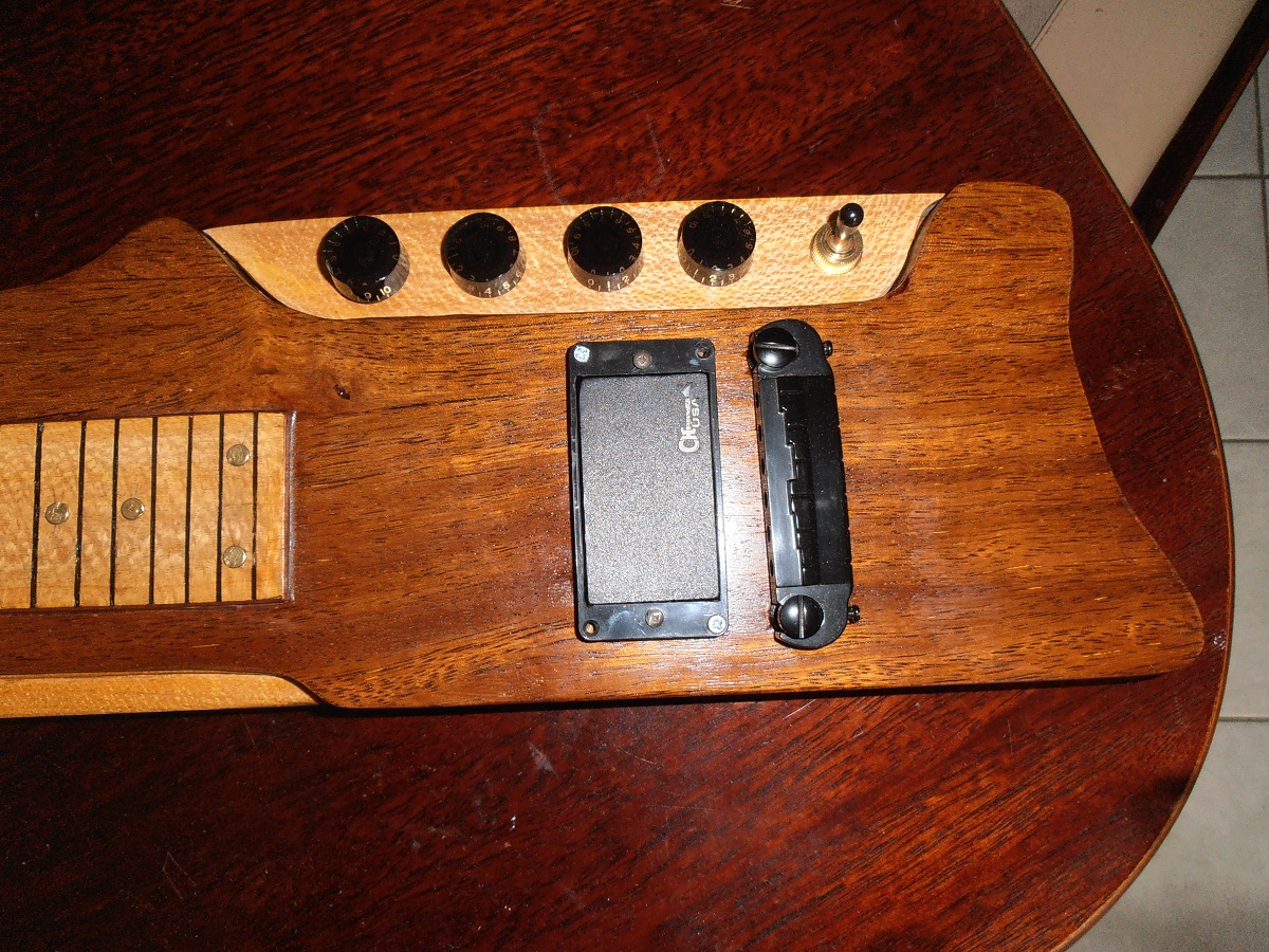

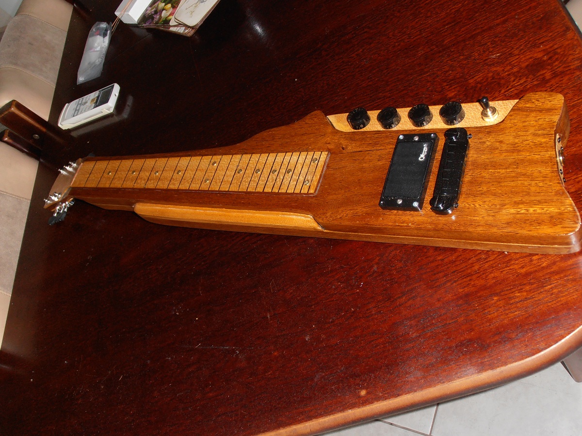

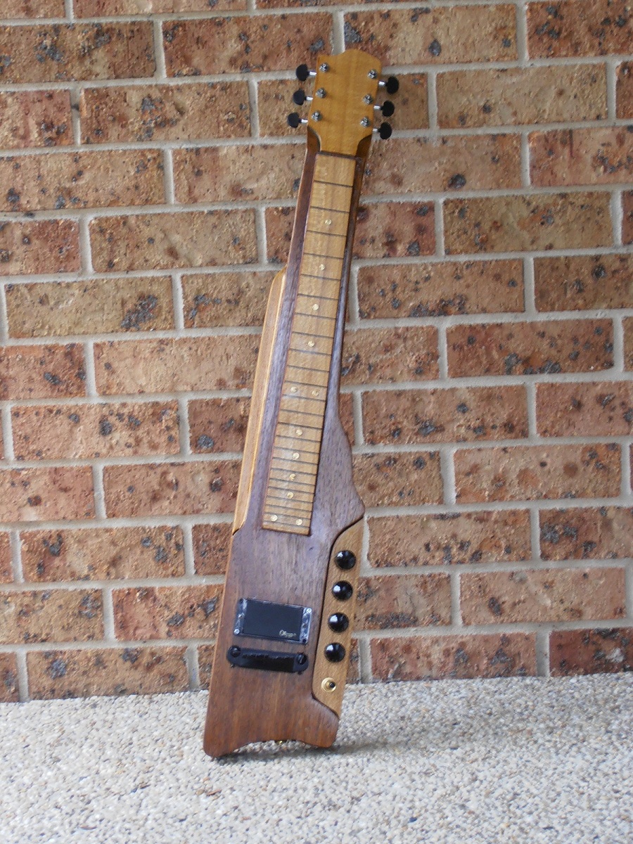

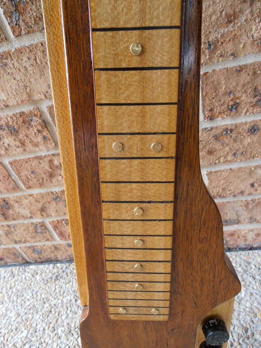

Just a quick update on the lappy.
armed with advice from Jeffhigh and ozziebluesman, Alan, I decided to make a prototype and work it from there, but it seems to be coming along ok,the prototype may be it. I only have get some wiring worked out over the next couple of days and I should be trying to play it. I may even qualify for the Jim Kirby $30 contest
Check out the Bullet Fret Markers, Took a very steady aim to get those in the right place

Annie Oakley eat your heart out!!.......Dead eye Dick is back in town!!!!! nice grouping there Tod & I'm liking your original thought out build.

Hmmm...
One pickup, a switch, and 4 knobs, what's the plan?

jeffhigh wrote:Hmmm...
It may have piezo disks under the bridge (or Somewhere )( If they Work OK ) So that would be 1 tone 1 vol for Magnetic and same for piezo, 3 way selector for Mag/ Mag, Piezo/ Piezo
if I can get a suitable piezo tone then one of my valve preamps will also be installed and with the humbucker (which is suitable (a bit like a EMG ) ) it will become an all active pickup system ....well that's the plan, at worst I will end up with unused pots and will call it future proofing.

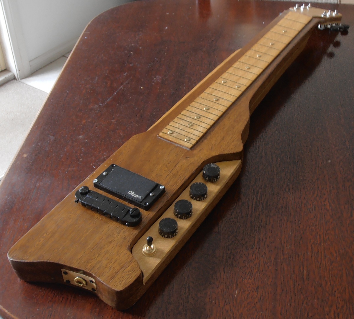

All Finished, and an update for anyone interested.
I didn’t bother with any further photo’s as it looks the same except for strings.
My Idea of positioning piezo disks and switching with the 3 way toggle didn’t work, I couldn’t find a position for the piezo’s that sounded the way that I wanted so therefore the toggle is not used, also no need for a preamp so it ended up just a passive bucker with 1 tone and 1 volume.
But at least it was a good learning curve and I am very happy with the tone it sounds fantastic, I am thinking that could be due to the heavy strings.
Now I need to learn how to play it, the tuning is open E that’s E B E G# B e.
Thanks For all the help and advice.
