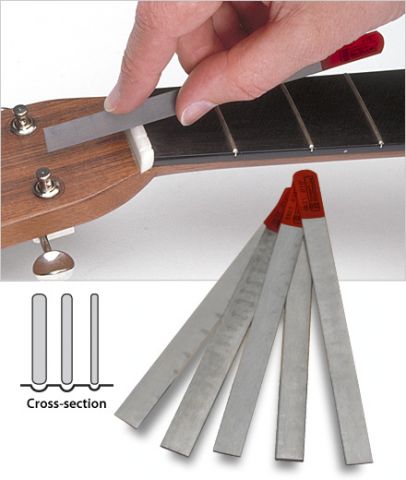

We've been using these double sided nut files from Stewmac
but we're not overly happy with them as they leave a V shaped slot.
I've been looking at these ones, also from Stewmac
which seem to be straight edged and have a rounded filing surface.
The other option are the Ibanez set from LMI.
Has anyone used any of these and what are your impressions?
Or are there any other suggestions for a decent set of files?
Bob

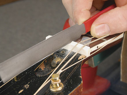

Post by Kim » Thu Feb 28, 2008 11:52 pm
Bob I cut close to depth with a razor saw, then slot with the relevant stewmac double side file as you show above (Had persistently borrowed a set of the Ibanez double sides that Allied sell with the tapered point so you have less chance gouging the headstock and they were better than the stewmacs ) and then I finish with a set of these.

Post by jeffhigh » Fri Feb 29, 2008 7:53 am
I use the stewmac guaged files (your second picture). They work perfectly for me
Can't imagine not having them now, all the stuffing around I used to do with needle files.

I've been using the rounded end files and thinking of getting the V shaped ones. The reason being as Dennis says, they should hold many diferent string gauges equally well. I assume that the string hieght would go up with a fatter string sitting in the V shape, but I'd like to get some to try out how pronounced this is.
The rounded end files are perfect for a string of the same size, but can't take strings that are thicker, and thinner strings are not held as tightly.
Jack

Pros repair guys will cut the nut slots to the proper depth and the file the top of the nut with a large file AND the strings on until they are also filing, just slightly, the string tops. It is not unusual for a pro set-up guy to go through three sets of strings doing a perfect set-up.
Be sure to angle the nut file when cutting as around 1/2 the difference between the fret board and the head stock angle (15 degrees). So this means cut your nut slots at around 7-8 degrees.
