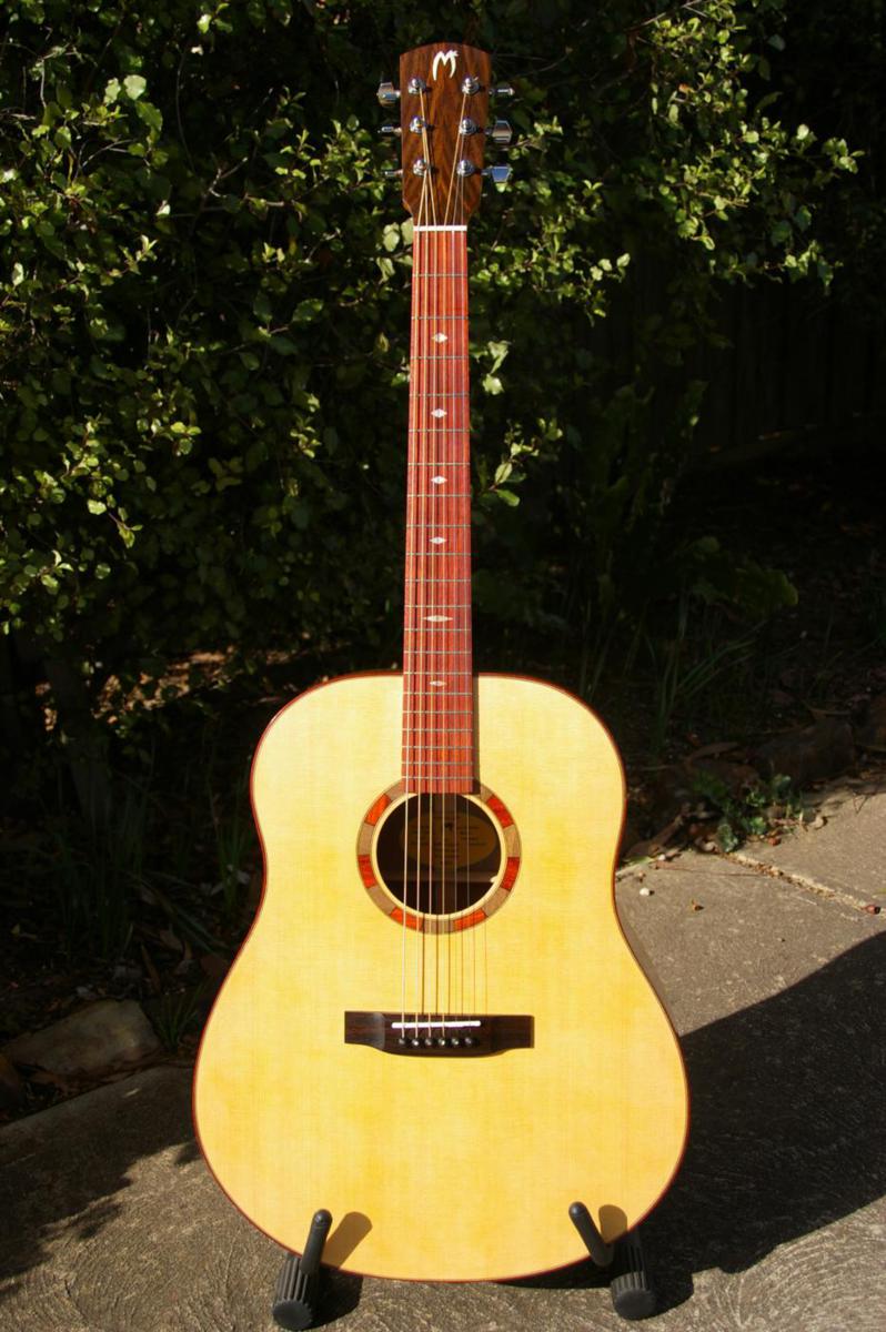

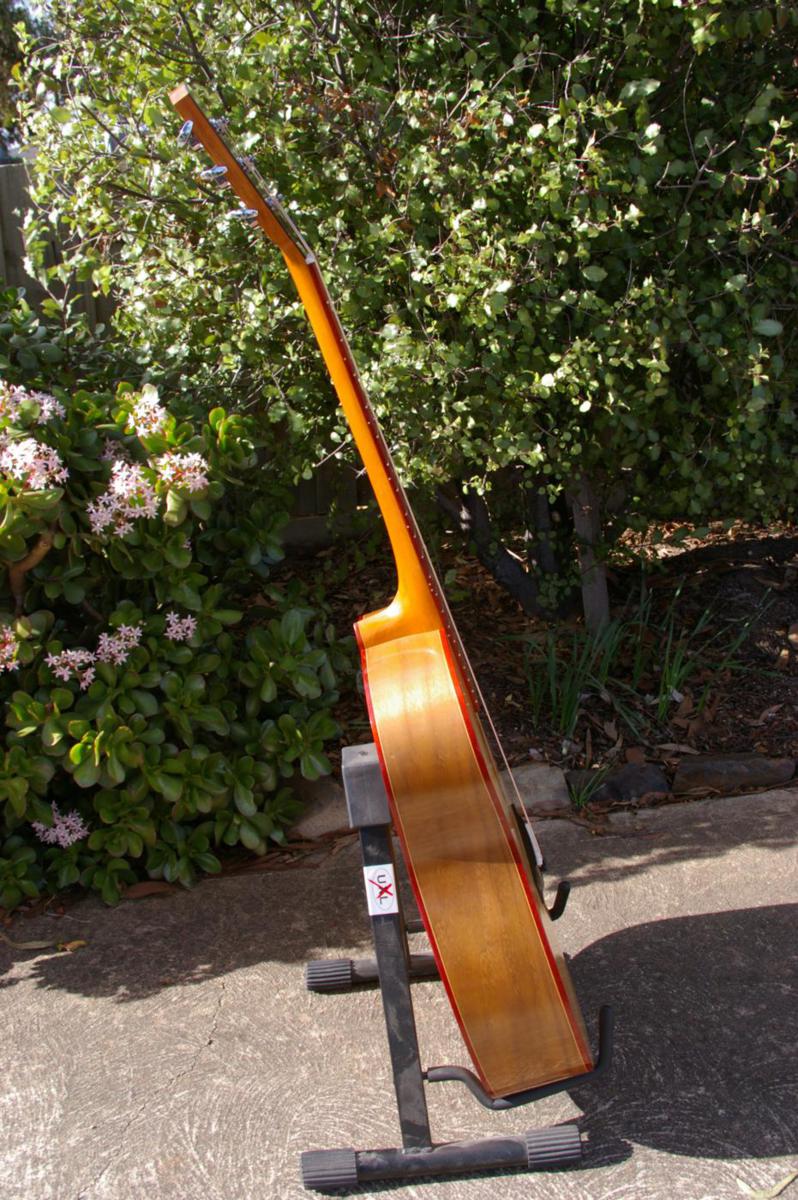

I have a Walnut guitar that i built about 6 months ago, turned out real nice, played beautiful and had a fantastic tone. Anyway i'm not sure why or how but the guitar developed a bad case of fret buzz, when i look down the neck i can see it's warped. I tried a refret but that didn't work so i'm thinking of taking the neck off and making a new one. I'm a bit worried about damaging the soundbox and also getting the new neck back in right location seeing as the bridge is in position. Anyone got any ideas? Wayne
