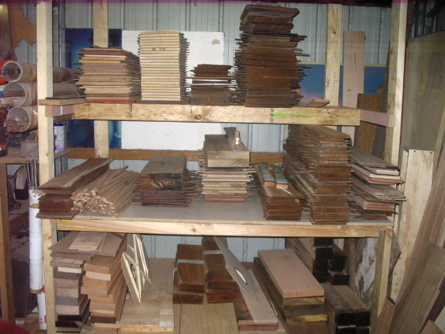

Being that I am an international tonewood embezzler by trade and make my bread and butter by luring unsuspecting forum members into group buys and then pissing off with their wood. It is very important for me that i remain highly mobile. After all, one never does know in this game when those angry villagers armed with their silly pitchforks will come storming up the driveway.....again!
To address this problem and keep your wood, errrmmm sorry that should be MY wood, in tip top shape until I get a chance to move it on, I came up with the Larkim Transportable Wood Press or, as we call it in the trade, the LTWP
Here are a few of the suckers (sorry, no offence intended) lined up ready for the getaway

Kim wrote:Being that I am an international tonewood embezzler by trade and make my bread and butter by luring unsuspecting forum members into group buys and then pissing off with their wood. It is very important for me that i remain highly mobile. After all, one never does know in this game when those angry villagers armed with their silly pitchforks will come storming up the driveway.....again!
To address this problem and keep your wood, errrmmm sorry that should be MY wood, in tip top shape until I get a chance to move it on, I came up with the Larkim Transportable Wood Press or, as we call it in the trade, the LTWP.
Here are a few of the suckers (sorry, no offence intended) lined up ready for the getaway![]()

Thanks Bob,Tigermyrtle wrote:Hi Kim, just love the set up you have for storing and drying sets.
cheers Bob,
It is handy because I can keep an inventory on my PC of what set is where. If I am looking for some macassar ebony for instance I know it's number and the spreadsheet tells me all I need to know about the set from initial cost to dimensions, any feature or incursion, who supplied it and when and that it's in press 9 so I can go straight to it when I want to use it.
Also I can quickly move the stash out of the way as required, this can be handy if you need some extra room for a particular project. Also, curse the thought, but just imagine a fire for instance
