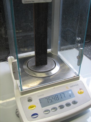

OK so I dug out one of my IRW bridge blanks that I've had in a climate controlled room for around 2 years now. Size of the blank is 38mm wide x 220mm long x 10mm thick. Next I weighed it using a 4 decimal place balance scale.
Bridge on scales.jpg (51.69 KiB) Viewed 19587 times
The weight, as you can see, came in at 75.4817g . I had to stand the sample on it's end, you couldn't get it inside the scale's doors laying down, the scales are so sensitive that even a breeze can change the numbers so they put doors on to eliminate the possibility of this error.

Maybe let the acetone wash liquid evaporate on a weighed open dish to see what residue is left and how much it weighs.

Thanks for that idea Jeff, certainly easy enough to do. I can pour the 'waste' in a dish of known weight when I comes time to refresh the Acetone, & then just let it evaporate off. I guess theoretically the 'new' weight of the bridge after leaving it for a week plus the residue waste should add up to the weight shown in the pic!

Weighing the residue would probably be more accurate than weighing the bridge. You won't know for sure if you've removed all the solvent from the wood, you might remove resins only to replace them with solvent and see no change in overall mass.
Now that you've already started you can still do both. Weigh the glass thingy with residue in it, and weigh it again after you've cleaned it. Then compare your results with the 'weighing the wood' method.
