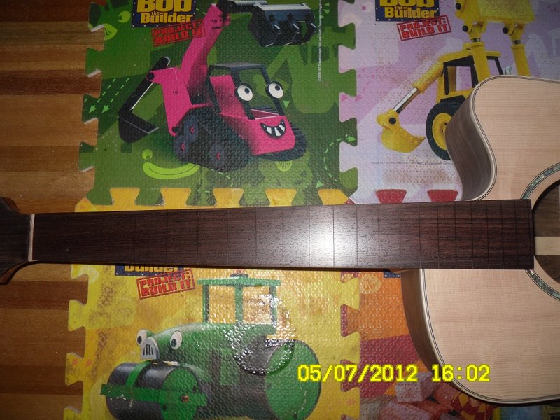

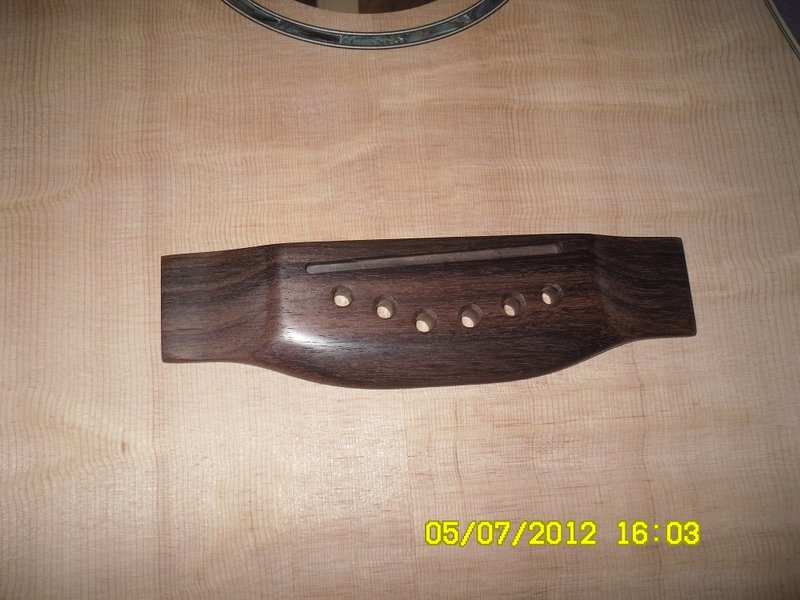

Hi everyone,
Thank you all for responding, all of the replies have been great & I guess it shows there's no single way to achieve a nice shine to you're bridge/fretboard.
I ended up taking Kim's advice, with the use of elbow grease and sandpaper (400 - 2000) and then a final buffing here is what I ended up with.
The EIR is just a natural finish, no polish or wax, the photo's are'nt that great but the finish is nice & very shiney, just what I was after.

The date on the photos are wrong & should show 05/08/2012, camera malfunction.
Thanks again guys.
Thanks again guys.

Great to here things worked out for you Wayne, looks real nice.

Glad it worked out for you Wayne and the results came up nicely, that top looks as though it's got a nice bit of bearclaw running through it
I'm more interested in where you got your Bob the Builder work mat from though
