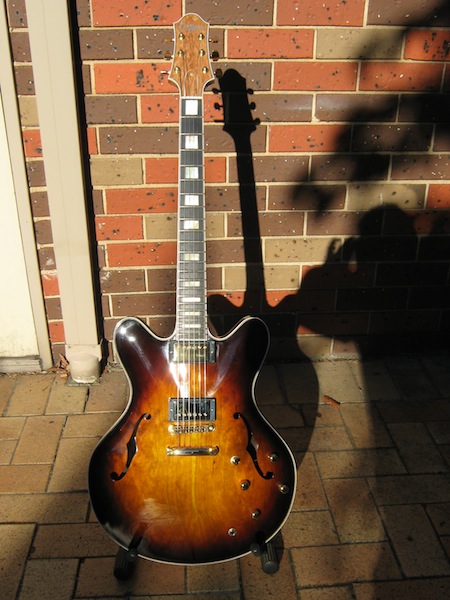

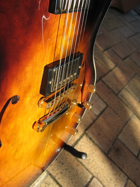

Re: Going electric
Strangely enough Paul despite your failing memory(pavliku wrote:Hi guys,
I want to make the neck wood run through the body of the guitar - I forget the exact term for this type of construction.
As to your other questions, Gotoh now make excellent hardware (tuners, bridges e.t.c), when they first started out the quality was a little dubious but they've really put the work in & now make a product comprerable to any 'quality' parts the likes of Schaller (German company) make. Gotoh's have the added bonus of making a range of products to fit any budget, they do fairly cheap for quality right thru to top of the range stuff. Stewmacs are a great source for their products, infact there's not much you couldn't get from Stewmac. Their electrical components, which can be bought as kits which include wiring, pots & caps aren't too bad although having said that, I get CTS pots from another supplier who's name escapes me just at the present
As far as pickups go I've only ever used Seymour Duncans or DiMarzio's but mainly because of the range of different types they've offered, like any company they can sell the odd bad one but I've never had anything but quality from them. I wouldn't buy any locally either, NZ retailers such as R**kshop charge way too much for their pickups. Online & shop around if you want 'name brands'! U.S retailers have quite a variance in prices as they like to compete more with each other & you can get quite a bargain sometimes, exchange rate isn't too bad at the moment, You'll probably be able to buy & ship two pickups from the US for the price a local has one in the shop for.
I also have a few "Golden Age" pickups earmarked for a wishlist build down the track, which are the Stewmac house brand which are supposed to be good value for the money as Rod (above on that beautiful semi hollow) will attest to.
