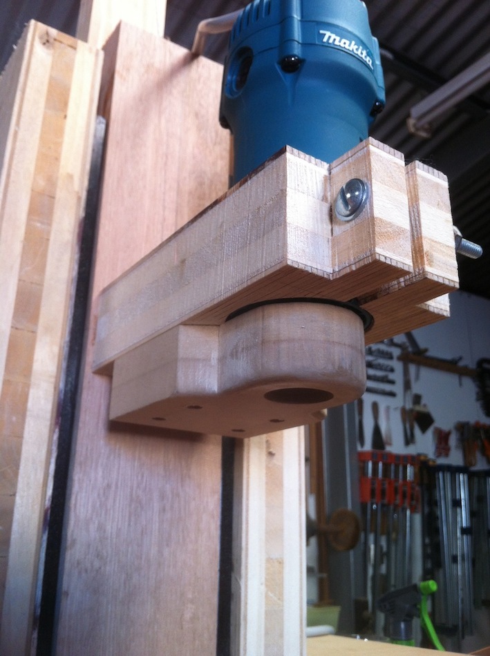

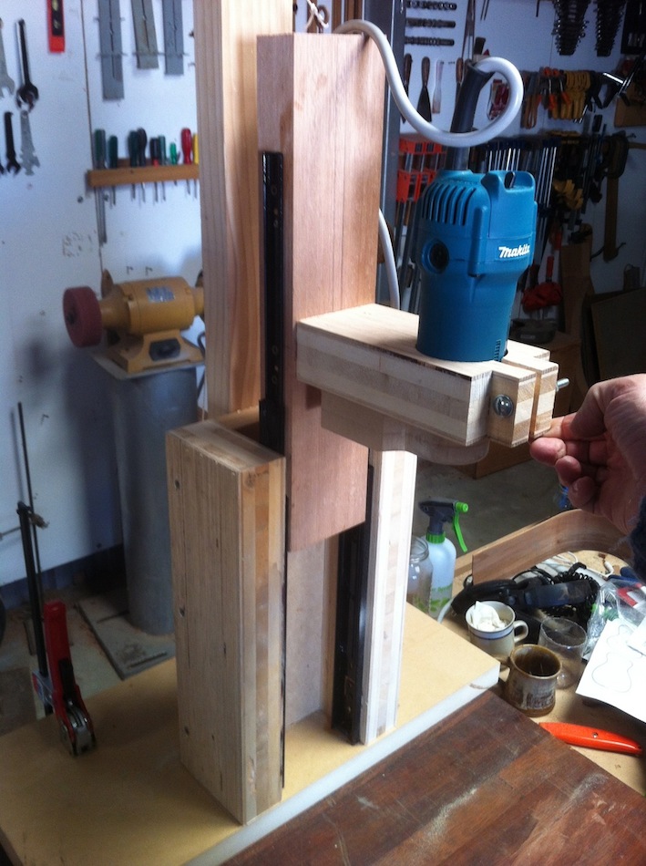

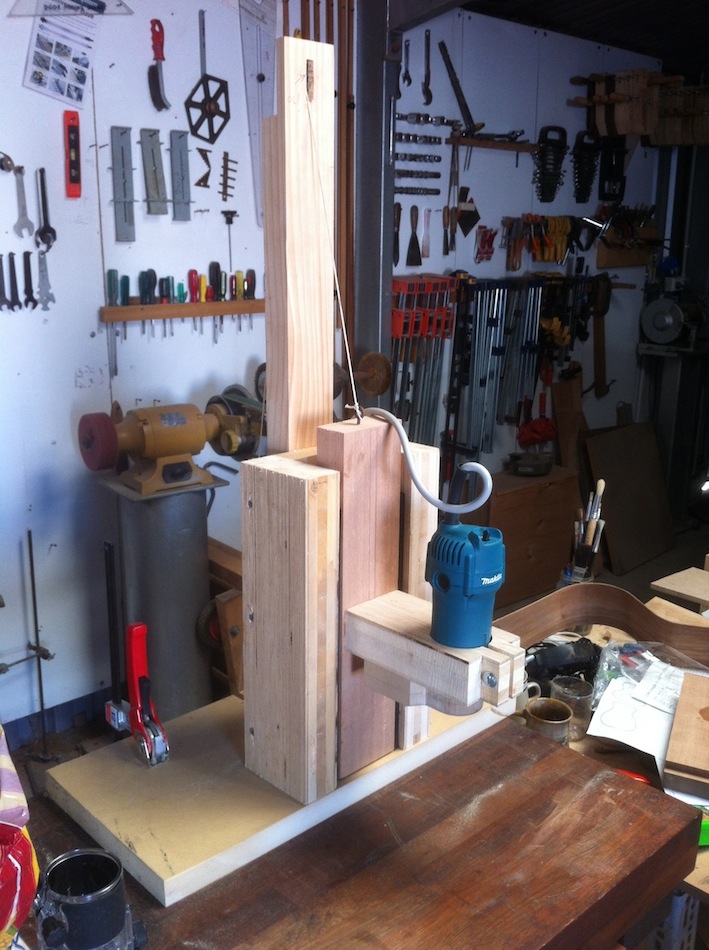

Stephen , with your inverted router, can you move the arm over the top out of the way? Or is there enough room to fit a jig and a guitar body ?
I built one of these for my inverted router and held the body freehand , side up against the fence. I used a down cut spiral bit and it went well. I just had to hold it level as I moved the body around which was not hard , any other accidental movement just meant the cutter moved away from the work so there was no problem of cutting away to much wood.
It’s much the same as the Kinkade set up, from his book. but with a taller fence.

Re: bindings.....
John, I drilled two slots in the fence of that jig so it could be adjusted for the horizontal depth of cut.
I did think at the time of building it "funny how it looks like a neck"
In the picture above it you can’t see the slots because I have two leather washers covering them.
Two coach screws {the heads housed in the flat piece of Walnut held down with three screws} pass through the slots and the two Elm handles twisted clockwise clamp the fence down. This whole set up is on a piece of veneered chipboard that locates to the top of my router table with four cleats .
