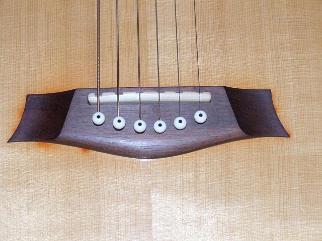

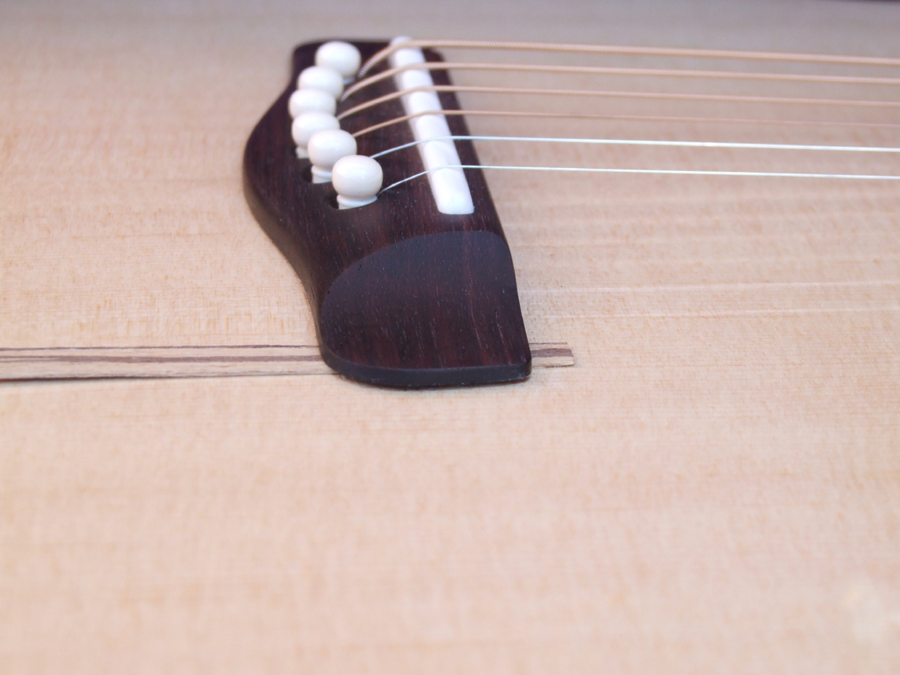

I finish this guitar about a month ago and today I noticed the treble side wing of the bridge had lifted.

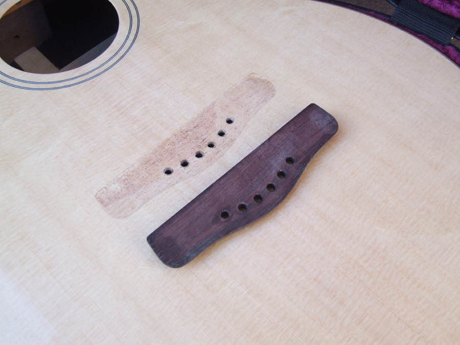

So I removed the stings and had a look. I slid a ruler under the bridge and it came off easily. I have made several guitar before and all their bridges are fine after 10 years.
I wiped the bridge with acetone before gluing with titebond. The glue has not stuck to the rosewood at all.
Any ideas on what caused this and how to prevent it?
Your ideas will be greatly appreciated.
Thanks Luke

Re: Failed Bridge
Two possible reasons:
1. bad glue bond due to contamination or inadequate clamp up. Are you using a caul under the bridge plate?
2. bottom of bridge not profiled adequately to match doming of top. The fact the bridge is lifting at the wings rather than along the back suggests to me that this could be part of the problem.
I use Titebond on my IRW bridges without any use of solvent on the bridge and have never had any problems.
Clean up the top and bottom of the bridge. Check the profile of underside of the bridge and fine tune if possible (I rub bridge over sandpaper laid on the soundboard in bridge area). Reglue (use fresh glue if age of stuff you used is not determinable) and reclamp

It looks to me like a bad batch of glue, there appears almost no residue on the two parts from a good bond

Regarding the bridge of the OP: That picture looks very strange to me, Luke. I have seen a "couple" of bridges that had come off, but all of them had at least some spruce splinters left on them. I think that if nothing had been wrong with the contacting surface of the rosewood there should at least some glue be sticking to it. Maybe Nick is on to something when he mentions the possibility of remaining and interfering acetone, but I also have no idea what chemically or physically could happen between Titebond and acetone. Let's do some experiments or ask "Mr. Franklin".

Hmmm. There seems to be a whitish residue on the bridge and some rosewood "splinters" on the guitar top. Really hard to tell what happened without seeing it in the flesh. But one (of many) things that can go wrong is if you masked the bridge area with masking tape and then didn't clean up properly when you pulled the tape. It is easy just to get the tape adhesive residue soaking into the top as you try to remove it, giving you a really poor gluing surface. I don't bother masking, but just scrape the finish off the bridge area, leaving a clean, new surface.LUKE_LEE wrote: The glue has not stuck to the rosewood at all.

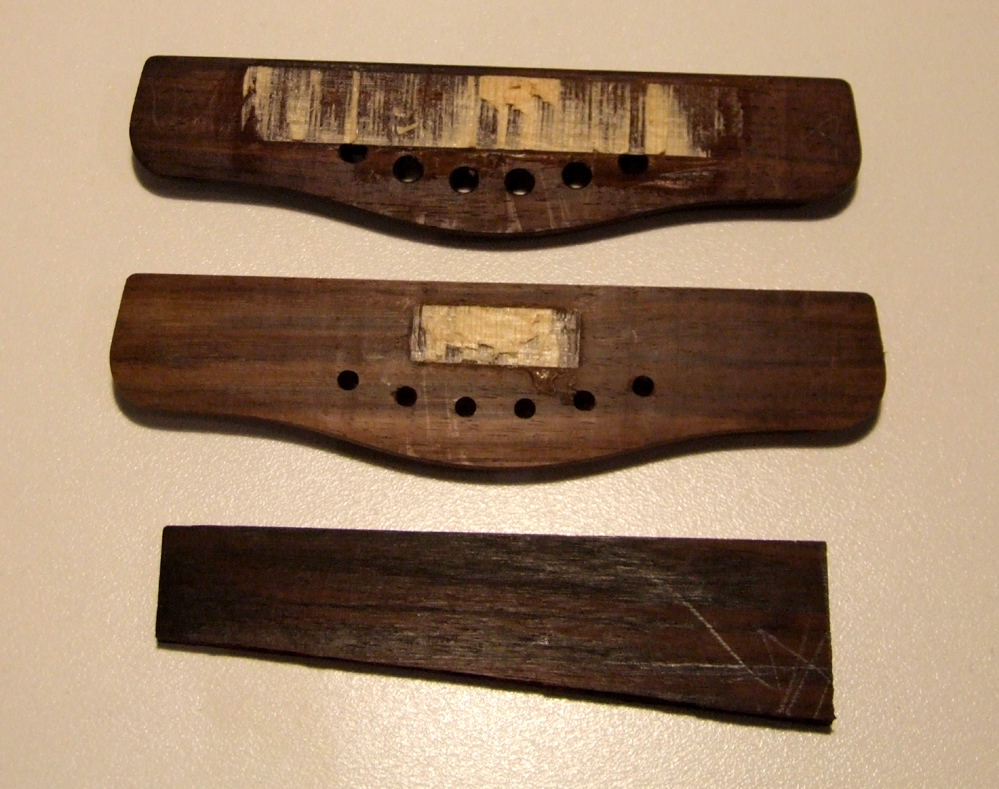

Hi,
I just thought I would follow up on my bridge/glue tests. In the photo:
The top bridge is the one that came off, I wiped one half with Acetone until no more colour came out (Jeff’s suggestion) the other half I scraped. Then I glued a strip of spruce on, let it dry for 24 hours. After that I tried to prise it off using a chisel.
The bridge in the middle is a different piece of IRW (that is not as dark as the original), with the same process applied as above.
I think both test glued successfully.
The bottom piece is a test of the oil I used (Dunlop). I put a drop of oil on top and the photo is the opposite side after 24 hours. It is hard to see in the photo but a fair amount has come through to the bottom side.
I think it failed due to the oil and maybe the poor use of acetone.

I managed to get hold of a MSDS for one of the popular fretboard conditioning oils a couple of years ago,( the one that smells like Lemons) and was surprised to find that it was mineral oil (Baby Oil ) with a lemon essence added for the smell.
I now use the Howards Orange Tung oil which is basically just Tung Oil with orange oil added to thin it down it does not penetrate very deep, but is a drying oil and have found no problems.

Looking at the white, dark and lighter patterns in this image has me wondering if the glue joint had been a good wood to wood mating when it was clamped. The white patches look like they may possibly be voids in the bottom of the bridge where glue had migrated during the clamping operation. The darker patches around the perimeter and pin holes, but especially the back edge and treble wing look to be areas into which oil had quite freely penetrated when applied the next day. For that to have happened would indicate a probability that there had never been a decent wood to wood bond where it was needed the most. What remains between the white and dark look to be areas that took the bond enough to hold things in place for a while. But it even there it looks like only 'just' because there is no real wood 'fibre' exchange between the components, rather the spruce looks to be only stained a little and this makes me question the glue as well and whether or not it had been out of date, or perhaps exposed to sub zero temperatures at some stage both of which do nothing whatsoever for the integrity of white and yellow glues.
Before I got too concerned about the oil, be it applied the day after or that which may be in the rosewood itself, I would be looking very carefully at the glue 'and' process. Because if it is not allowing a 'full' wood to wood mating of theses components there is potential for even greater disappointment should good glue be used and the bridge were to pull free taking divots of spruce with it. So glue aside I would still be looking carefuly at how the mating of the underside of the bridge to the surface of the top had been achieved, how long it had been left after the mating was done and then glue was applied, how well matched the bridge plate caul had been to the inner radius of the top, and how effectivly clamping pressure had been applied.
Back to oil, my own thoughts on wiping oily wood with acetone prior to gluing are that it can be a risky practice. I say this because I 'suspect' that acetone thins out the oils in wood 'too' much. What I am suggesting is that like most oils, these wood oils polymerise upon exposure to oxygen, and as the surface of the wood and that immediately below have the greatest exposure to oxygen, it is here that this reaction must have greatest effect. I think that perhaps this polymer hardened, 'stabilised' oil, effectively seals off the oils deeper in the wood from the effects of oxygen exposure leave them in a more fluid state ..I speculate that if you break down and wash away the polymer seal with something as astringent as acetone, those oils deeper in the wood will also be thinned allowing them to freely migrate toward the surface as the acetone evaporates and fill the voids, because with most things in nature its 'all' about achieving an equilibrium, and my thoughts are that this migration would be assisted by a wicking action potentially resulting in bond failure as those thinned, volatile wood oils move their way between the bonded components.
I don't 'know' any of that to be true. But my own experience tells me that only a light scrap to expose fresh 'surface' wood just prior to glue application works well. As for glue up process I mate the bridge plate caul to the top just after the bracing has been carved and the top is held securely by gobars into the radius dish. I also relieve the ends of the caul just a tad to be sure they will not crush the top later should it force the top back into the intended radius during bridge clamping. To avoid too much work taking place on the freshly glued top of the guitar, initially mating of the underside of the bridge is performed on a matching radius form to that of the top. This primary form is made by sanding a piece of mdf in the appropriate radius dish, its then sealed with thick shellac and fitted with 80 grit abrasive allowing the majority of that bridge wood which is not guitar to be quickly hogged off.
The bridge mating process is then completed with only a very light pressure sand being required on a sheet of abrasive taped in place on the guitar's top at the location of the bridge. The idea is to avoid the temptation to push hard during what can be a drawn out process as this will cause a deflection of the radius and a mismatch of the components. The mating process and the gluing of the bridge itself all take place at the very same RH at which the braces had been glued to the top. Just prior to application of glue, a freshly turned scraper is run along the underside of the bridge to freshen up the surface and take out any sanding marks left by mating.....and I've tried not to say it
