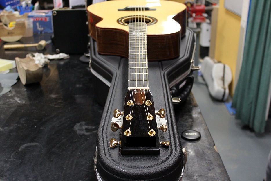

Nice headstock shape, symmetry nah dont worry about that

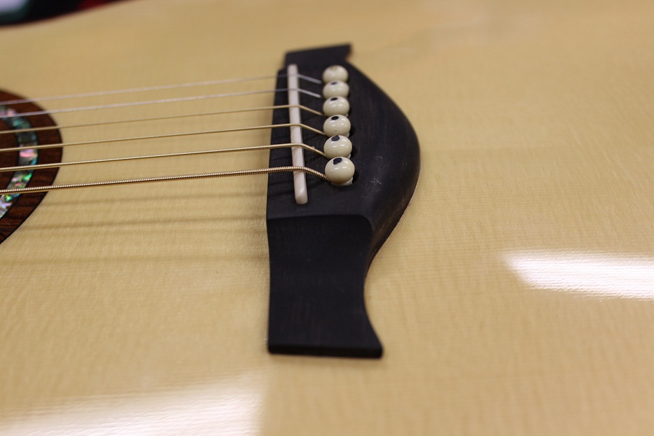

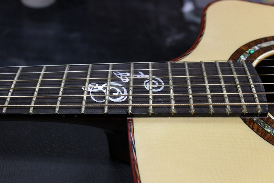

Bridge pins look crooked...holes not straight? Saddle looks a bit slanted as well.
No fret markers?
Headstock looks like its been painted black.....doesnt really go with the nicely silked spruce top and the fancy purfs

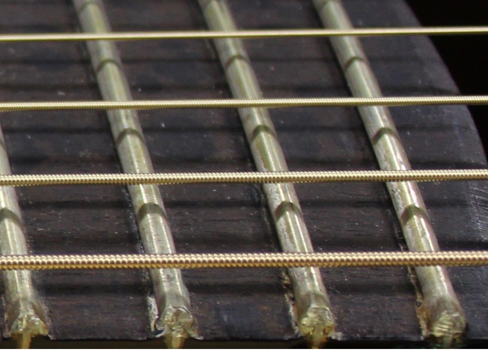

Nice fret spacing.

Don't know the tuning but the temperament is 'unusual' and would not suit your usual standard six-string tuning but ..
Pins and break angle look out but that can be in the pic process?

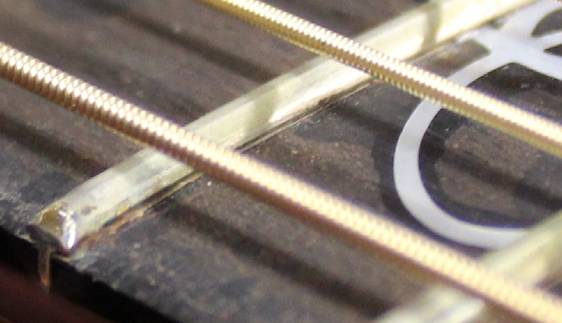

Nice fretwork

Kamusur wrote:Nice fret spacing.
Yep, my sentiments exactly. Its one of those unusual temperaments the one that involves a bottle of beer whilst your cutting the slots.
Hick shish thats close enough, closer wider closer wider man this is too hard to work out........

Well, at least the strings are shiny, maybe that would malke you miss the exceptionally accurate inlay work. Jeez, even I dress the frets after levelling....
12K worth on firewood for the chiminea.....Are the bridge pin holes too big? looks like the pins are a wee bit loose...
I hope I never build one like that..... :oops:

nnickusa wrote:Well, at least the strings are shiny,
It just screams quality doesn't it. Yes the pin holes are too big and drilled at the wrong angle

When I saw the first two pictures I thought "just acceptable for a 500$ guitar". But for 4k I would expect that the bridge did not bleed out into the spruce top, and I would prefer no inlay over one with cloudy ebony edges. The not dressed fret ends over the top's bass side don't matter, you never will touch them with your fingers while playing. And the tilted headstock... oh well, call it a feature.

Yes, forgot to mention the nice big bridge pin holes. And the very nice bridge pins themselves.
As I alluded before, 4k for this item is a bad joke unless its sound is such a killer that appearance and long-term functionality really don't matter. Or maybe there's a good sounding name behind that and people just want to pay that much.
