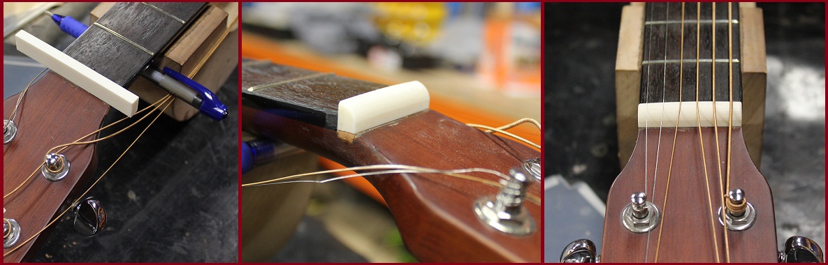

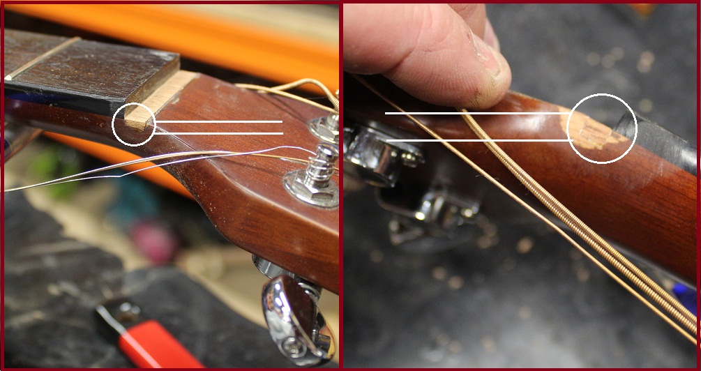

Heres an example of what can go wrong,P Bill wrote:I haven't done much repair. What goes wrong with a nut slot ?
Note, this is after I have fitted a fill piece and dressed and shaped it, it just needs colouring to match
Note firstly the depth of the slot on the left, then note the depth on the right, way different,
Note that the base of the wood insert is not flat, this indicates the original slot had been filed at an angle as well, so the filler piece had to be matched to make a clean joint
Note the new dressed height of the nut floor

Shit!simso wrote:Heres an example of what can go wrong,

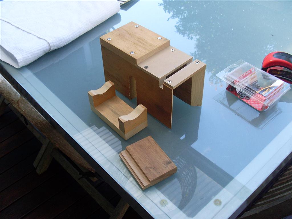

Steve....

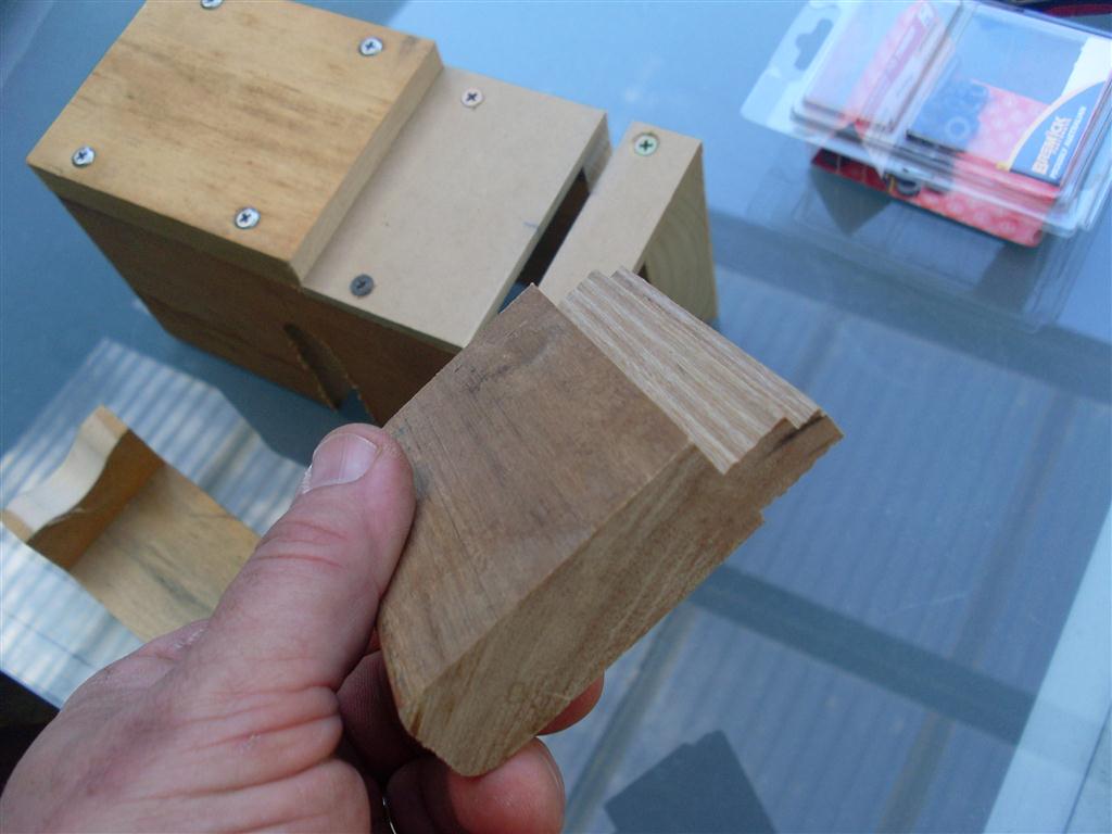

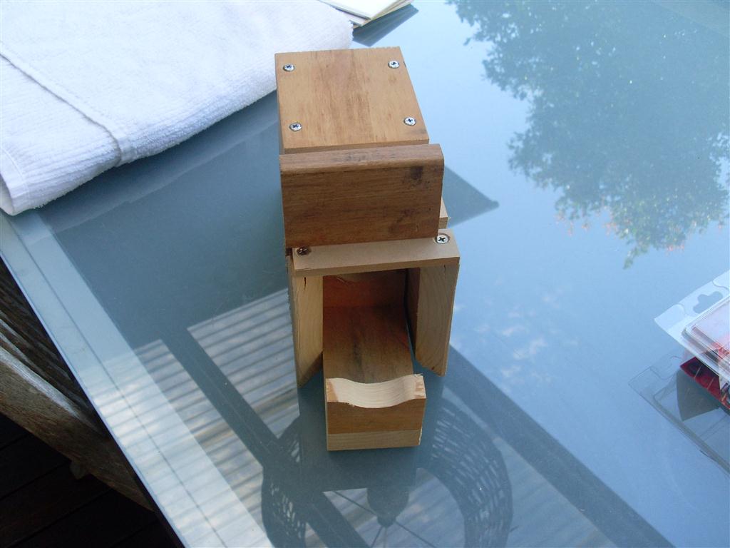

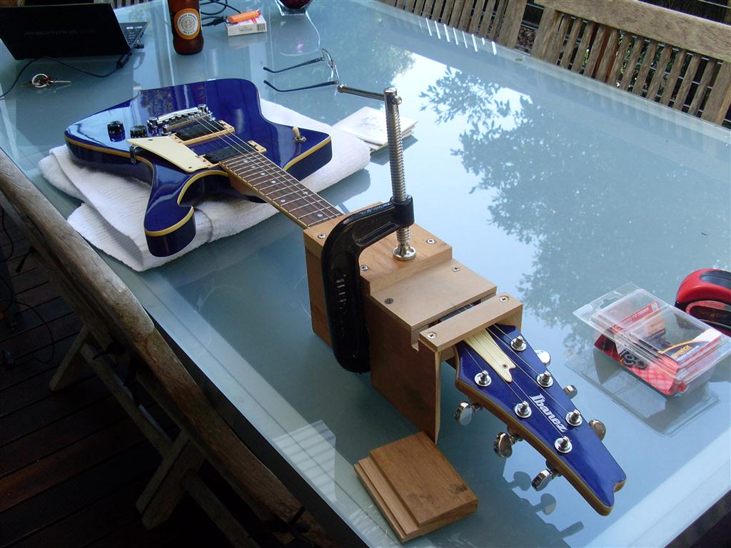

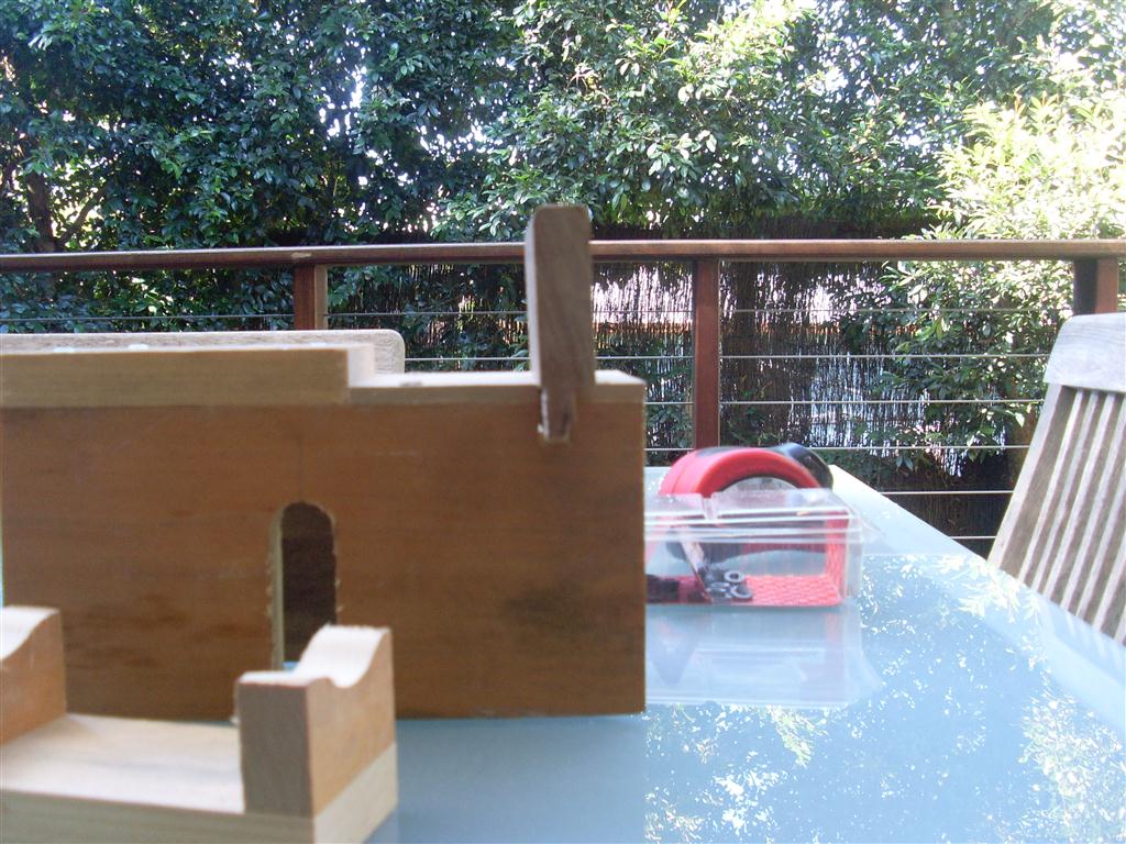

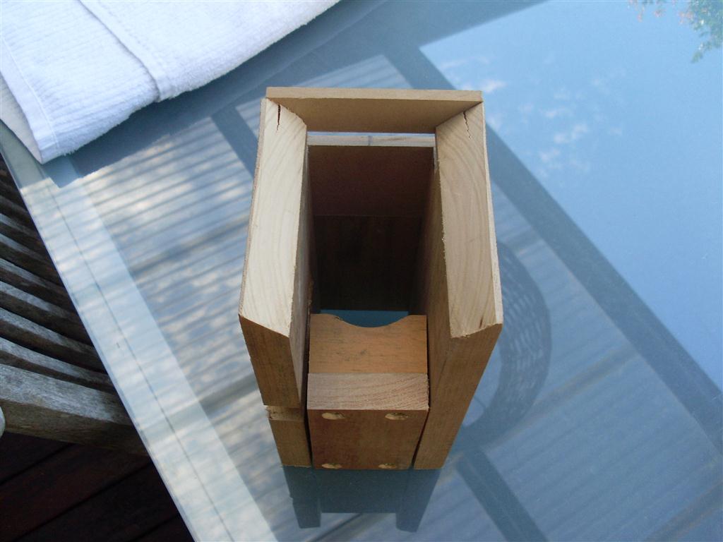

Couple days thinking about this.....15 minutes to knock up an example.....
The idea is that the neck gets clamped into the main box by using the profiled bit underneath. The cuts cradle the neck, and press it against the top plate. Centreing the clamp in the middle of it allows the cradle to tilt to accept the variations in neck profile. I'd line it with cork or vinyl and round the edges to avoid scarring of the neck. The zero fret is lined up with the edge of the cutout, or slide groove. The neck can be aligned by flushing the zero fret position with the edge of the slot. Glue a strip of sandpaper to the thin--5mm in this case--sanding face. The shouldered block then runs back and forth thru the slot until is runs flat. It is therefore impossible to rock the sanding block....
If you need to clean up the sides of the nut slot, simply make a thinner block, and line the sides, rather than the bottom with sandpaper. This would take off any glue or buildup on the surface..
I made a simple block, but one could be made with shoulders that slide up and down to set the desired depth of cut. As the slot is wider than the sanding face, a number of blocks could be made with varying witdhs to accomodate other width nuts...
In order to use this jig with guitars that have radiused nut bases, simply create a top with the desired radius, and then run the block thru that, again, it will--in theory--make it impossible to bugger up the slot, and guarantee a consistent result.
The one thing I've always found is that there is a tendency to "rock" when sanding a flat surface, which results in sides that are deeper than the centre. This should avoid that as well....
If I were going to use this myself, I'd make sure the tolerances I allowed were reduced to eliminate any wobble, but this may help your guy out...

Re: Jig for cutting nut slots
Pix. I forgot them last time, and it wouldn't let me edit the post????
Good luck
I suppose this is one approach, but it seems workable..Good luck

Nice mate.
Very good idea, to that point it could be used as a training box. Set both side reliefs you have there with a small steel cover plate so you cannot file through them, put it over a piece of wood and get the person to file a slot by hand until they are competant with a file
I like it a lot.
Thanks Steve.
When I did the nut slot on my first(only) guitar, I used my fretting saw, which has a depth guide, and made a series of cuts, after chiselling the seat area level, cleaned the slivers out with a small chisel, and trued up the bottom of the slot with a similar bit of timber on which I glued a bit of sandpaper...
I know that some folks have a bit of a mental block when it comes to some things...I had a carpenter work for me who was very competent, but could never mortise hinges without making a mess of it. Solution? He never hung doors for me again....That meant that whenever finish work came up, he was out of work, but he always had some to come back to on the next job....
If you show this to your guy, he may be able to come up with something workable for him...
If he has to provide the solution, you may find that the effort he puts into working that out solves the problem for him....
Good luck, again...
Hi Nick,
Great jig idea!
Off topic, but I love the Iceman! How long have you had it?
Good one Nick
I have been scratching my head on this one as well and was thinking of a frame like yours but got stuck on the holding the cutter bit. seeing yours solved the problem.
I made a tool like a plane makers float out of tool steel, it's a bit like one of these
http://www.lie-nielsen.com/catalog.php?cat=534
But I was trying it free hand with average results. I will try a frame like yours and where you hold the sand paper on a block it may be possible to hold and adjust a float. Micro adjusting it down each cut.

Nice solution Nick!
Was just thinking if your block that clamps on the underside of the neck was a closer fit in the sides of you guide block, provided to cradle blocks were 'inline' with each other then the guide block slot would have to be perpendicular to the neck's centreline. All the operator would have to do is get it lined up on the front edge of the slot (maybe a rule placed against the fingerboard's edge would act as a stop), less chance of getting the slot in the guide skewed slightly. When I've designed stuff for the students at work to use I've had to build in as much 'idiot proof-ness' as I can think, because there's some awefully clever idiots out there who come up with some awefully clever ways to still stuff it up!
Thanks guys. Rob, I'd be interested to see what you came up with in the end, along with anyone ele's ideas....
Nick, I'd be much more careful in the production of one I intended to use, but wanted to float this idea, but yeah, accurate fitting of that block would help alot. Also, one couild just use the sanding block itself to align the neck to the zero, provided the block fit more tightly than mine...
Ah, the Iceman...just happened to be what was hanging on the guitar holder today....It's a 1995 IC300 in Jewel Blue. Only made for two years....The pickups, original, are a bit hotter than I like, but that's what the volume and tone knobs are for
Got a her off a mate in NY...$370 landed, which I thought was pretty good value...
I'm working on a guitar that's derived from this, so keep an eye out in the gallery. Probably another couple months, as I started on the dread this weekend...bracing, and hope to have the box closed by week's end...
